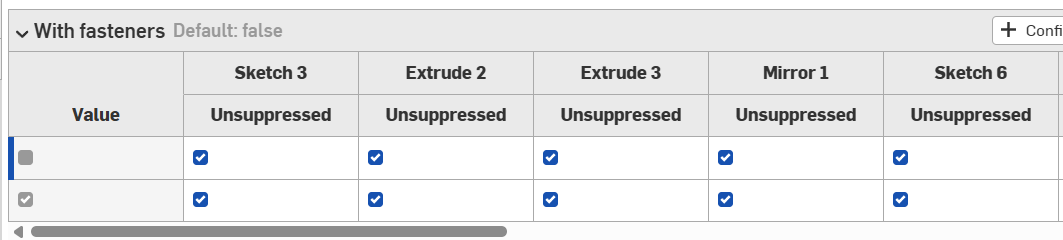

I have trouble understanding why when suppressing an entire folder with Configurations it adds them one by one without any way to:
  1. Group features (like the folder they were originally in) within the table,
  2. Distinguish sibling folders, and thus among the items therein.
Also, with checkbox, why is the unchecked row filled with checked values? If the table of two rows is a table of two discrete values, then the items of either row ALL need to follow the rules of that row; you aren't ticking checkboxes in each item however you want since that would defeat the entire purpose. If you want discrete values, that's what List is for, not Checkbox.

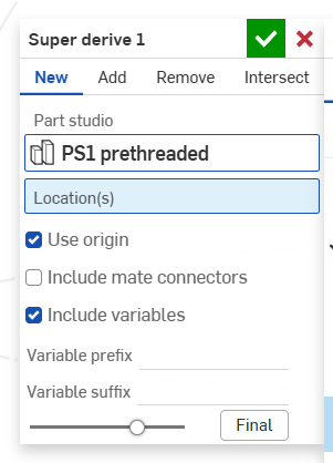

I also realized that Derived does not include variables. Someone had to write a featurescript called SuperDerive to enable this.

    Onshape deploys features as they become available with usable capabilities. If we waited to make everything perfect we would resort to annual releases 😀 rest assured we are aware of this limitation and it will be addessed in the future.
  • jelte_steur_infojelte_steur_info Member Posts: 628 PRO
    @duncan_ledesma :
    This solution will help:
    https://forum.onshape.com/discussion/comment/123648#Comment_123648
    I even wrote a custom feature to enable it:
    this feature is built in the part studio that i used in the first example.

    Your criticism is mostly valid — we do need better folder handling in config tables and suppression handling for boolean inputs can be improved.
    I was a little amused because the someone who wrote SuperDerive is the same person who made many of the internal design decisions about how variables work in Onshape. The reason is that deriving variables is a clunky way of sharing design intent between part studios. A cleaner approach 99% of the time is using variable studios, which is what I would recommend now. However, they didn't exist for many years and SuperDerive was written as a stopgap. Today SuperDerive is essentially obsolete.
