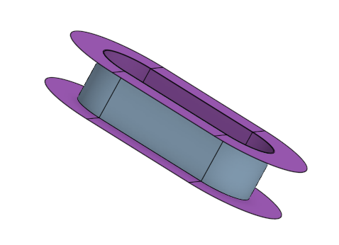

For the cable path, I create a surface for the main body and a helix inside it. I then sweep a surface following the helix, did an intersection curve, then swept a circle along that curve. After my first print the bits left over were too sharp for my liking, so I wanted to trim them down. To do this I offset the main surface in by 0.6 mm, and then added a brim (border? flange?) with a ruled surface
Later on, this let me trim what I wanted and got me the desired outcome. It feels a bit klunky having this extra surface hang around for half the design and I wasn't sure what to call it. Any advice

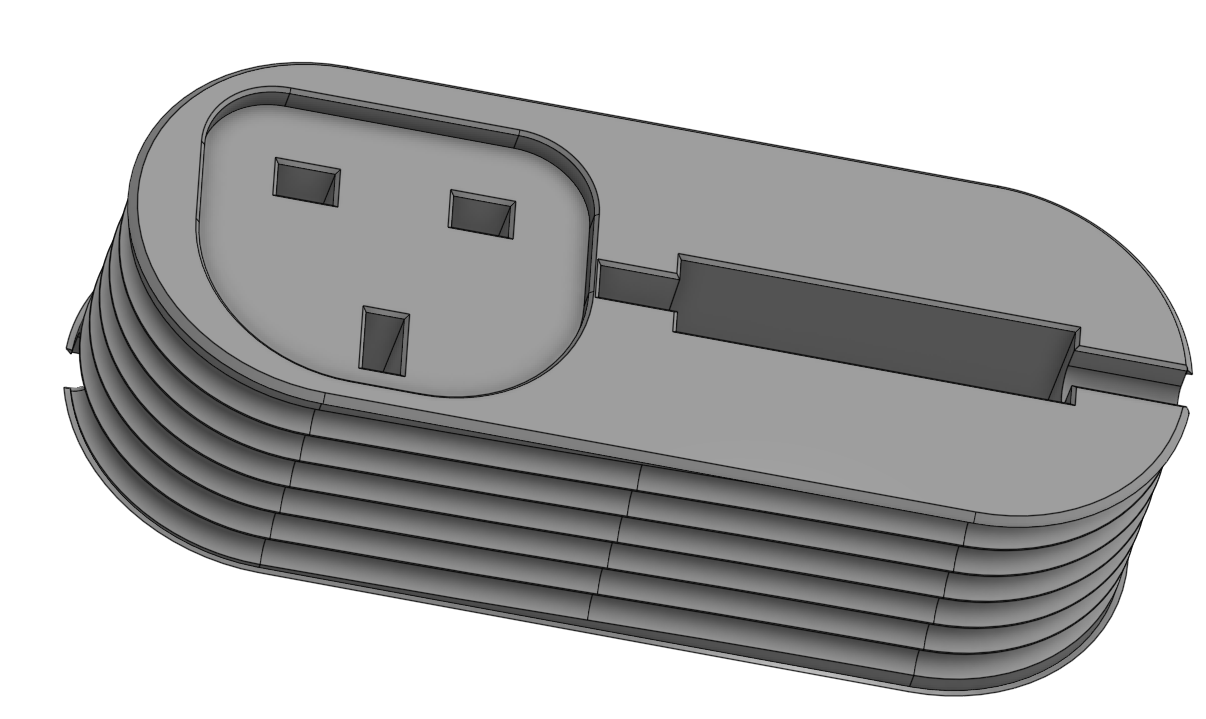

Feedback on Cutout Ideas - Design the cutout, do a subtract
If you look at the Plug Cutouts, you'll see I designed a blank for Powersupply Plug and Duracell Plug. I then bring those into the main part, put them in place and do a boolean subtract. I then apply chamfers after. My reasoning here is that I feel more comfortable building up a single complicated part and then doing a simple subtract in my main part studio.
Is this a good idea or bad idea?
Feedback on Query Variables
For chamfering the plug cutouts I created a query variable that intersects the edges of the main body with the edges created by the boolean subtractions. This took a while to figure out but I kind of like it. Any better ways of selecting the "entrance" edges of 2 features?
Feedback on cable channels
These are the cutouts on the top and bottom so the cable can route through. I don't like how jagged and rough they are. Is there a better way of cutting them out and rounding them off?
