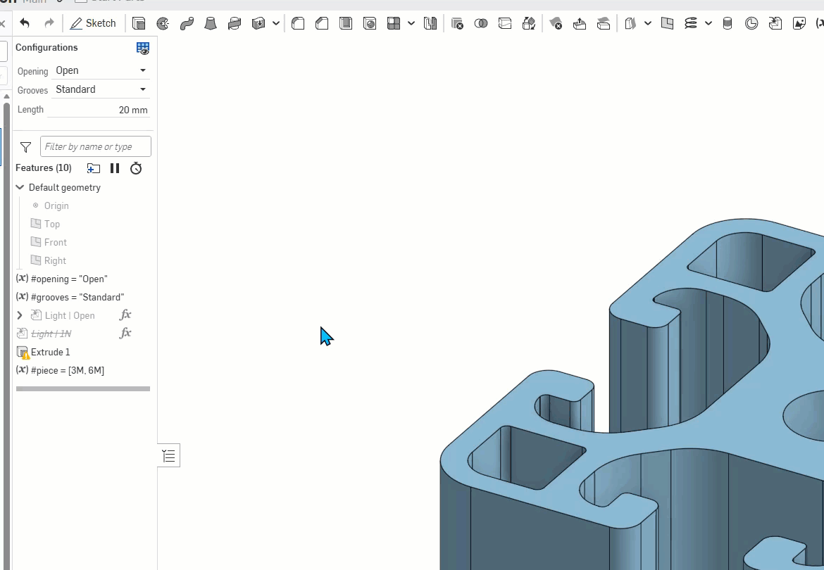

CONFIGURATION VISIBILITY - ALWAYS SHOW
A new option makes it easier to always show a configuration input, regardless of any other applied Configuration visibility conditions.
https://onshape.wistia.com/medias/y18ibh5882

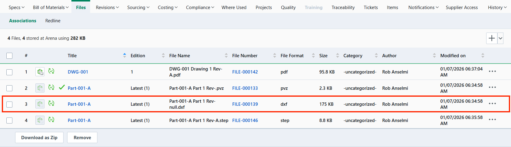

AUTOMATIC CREATION OF SHEET METAL DXF ON RELEASE SYNC
When a sync operation occurs at the creation of a release, Onshape now automatically generates a DXF of the flat pattern for any Sheet metal parts contained in the release candidate. The DXF file(s) are displayed in the Files view in Arena after being synced.
NOTE: While enabled in Onshape at this release, this improvement will not be functional in your environment until an update to Arena is completed. Currently, that update is scheduled to be complete on or before January 11th, 2026. The update has been completed successfully, and this feature is now available for all Onshape-Arena connected environments.
