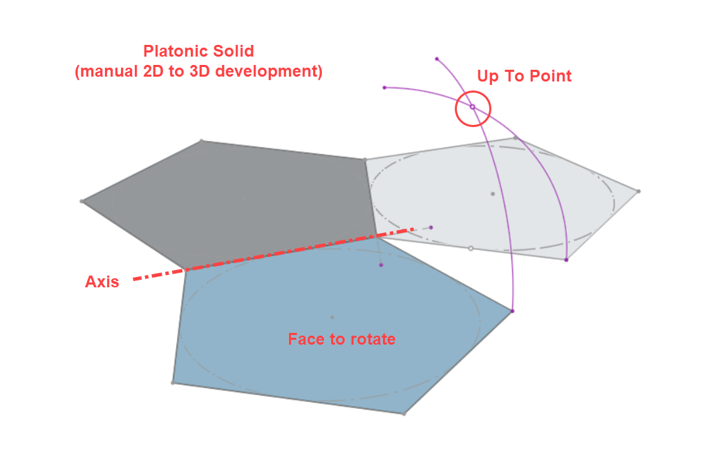

REVOLVE FEATURE END CONDITIONS
Onshape has introduced new end conditions for Revolve features that provide more flexible ways to define how revolve operations terminate. The new options include Up to Next (terminates when intersecting with existing geometry), Up to Part (terminates into a specified part or body), Up to Vertex (terminates at any selected point), and Up to Face (terminates at any specified face). These enhancements streamline the design process by removing the need to manually calculate angles or clean up geometry after creating revolve features.
