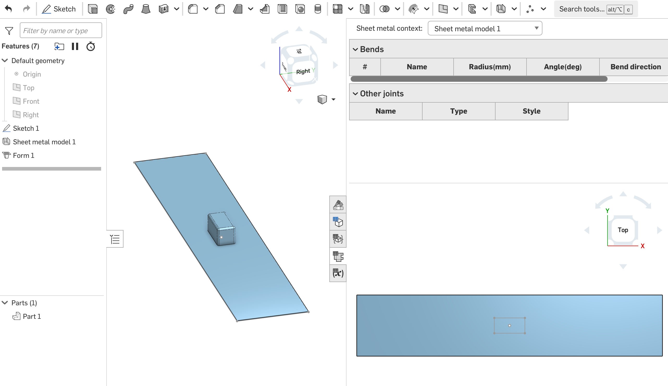

I just finally tested this out, and the steps to create a form library are much more complicated than I'd like. It is indeed possible to just add material to a sheet metal part with a Form tool, but as you already pointed out, all you get in the flat view is a sketch.
I'm also less concerned about stuff across bends. I've lived with that limitation for years in Solidworks, so it's less painful. Just being able to add extrusions or imported bodies to a sheet metal model on the flats would be amazing.
