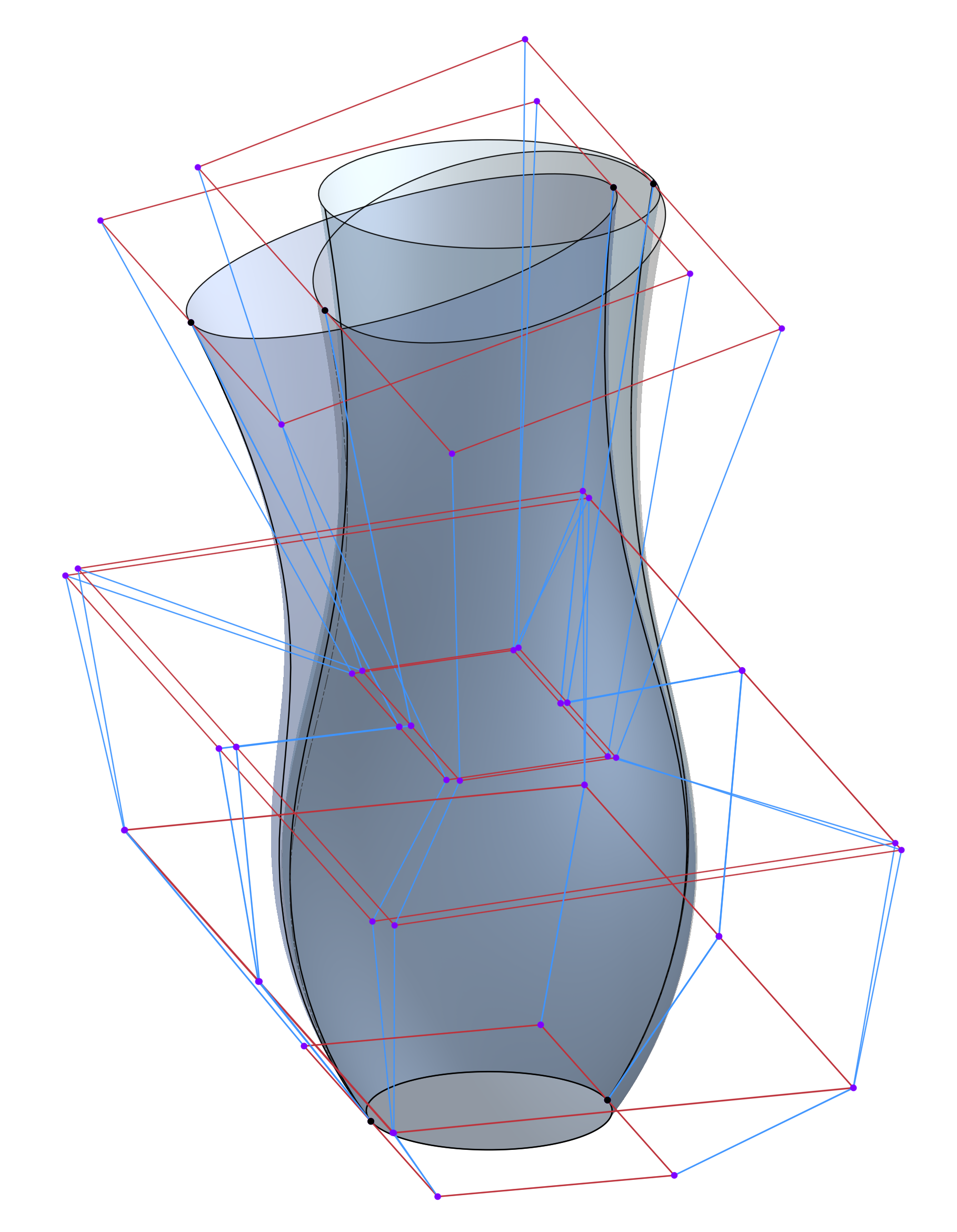

    I don't fully understand the capabilities and techniques yet, but what I've been able to do so far is amazing. I started with a simple revolved degree-4 spline and was able to generate these very clean vases with tilted and scaled tops. Right now it seems like FFD always generates new surfaces. I assume at some point this will (optionally?) modify an existing surface without generating new ones.

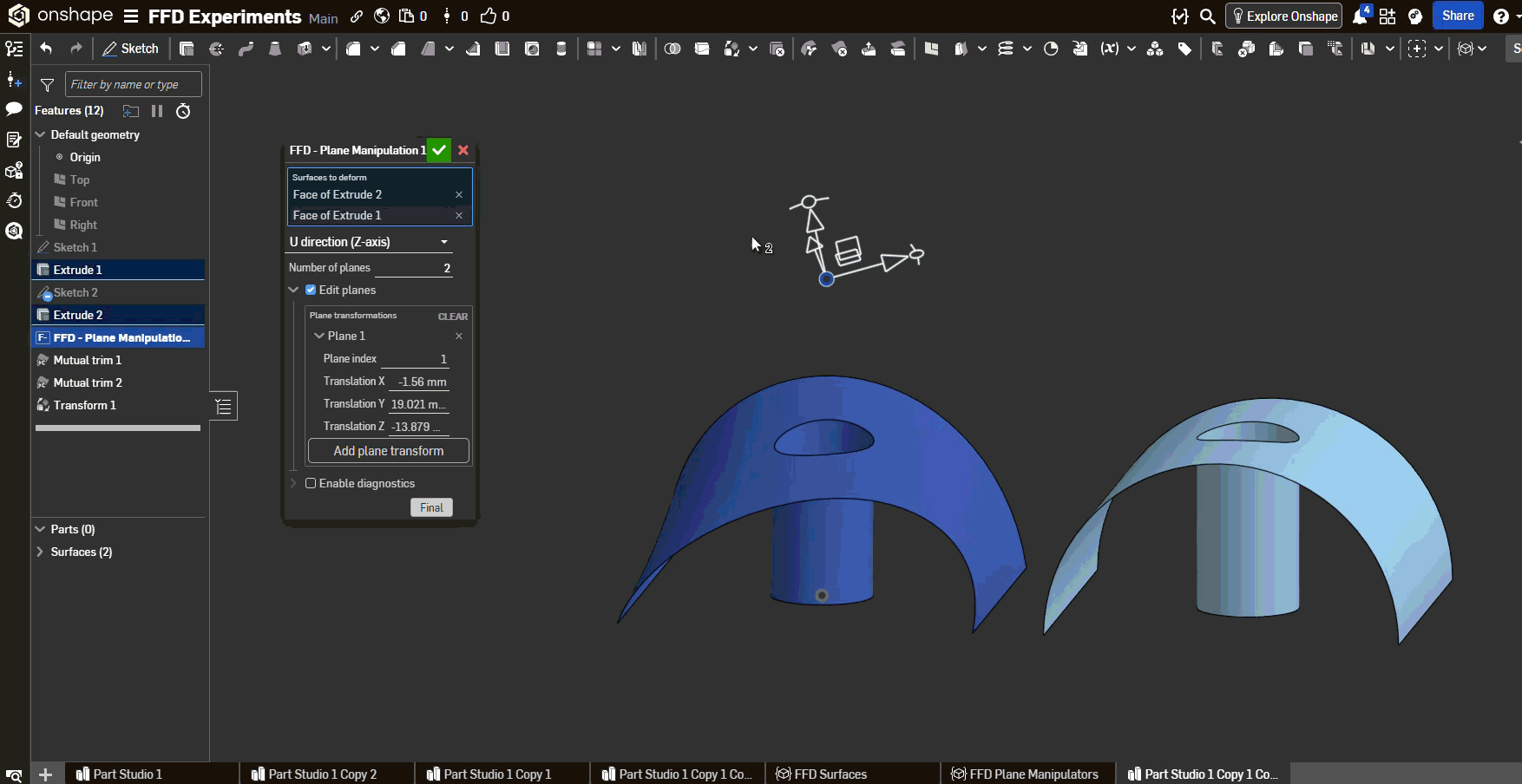

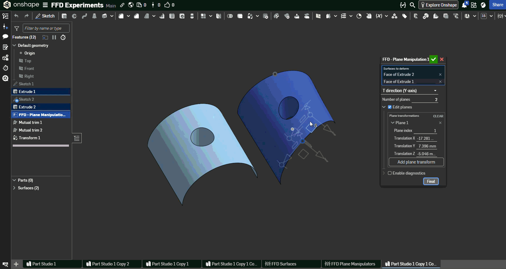

    @S1mon Somewhere in that document is a tilty vase from a revolve surface that I squished and squashed to make something organic, then I did a Face Curves and a bunch of lofts to turn it into developable strips to turn into sheet metal with my no-safeguards sheet metal feature. Yours looks nicer than my quick attempt though. The full lattice feature was a little annoying to work with so I did a planar manipulator version that lets you do the things you see in the gifs but theoretically I could extend that even more to add scaling manipulators to the triad ones to get some taper action going.
    I don't know if there's a way to implement this script such that it modifies the original surfaces. Probably replace face would work on simple cases but what if your whole surface set is twisted and warped and miles from the input? If there is, I'd definitely implement it that way but I have my doubts.

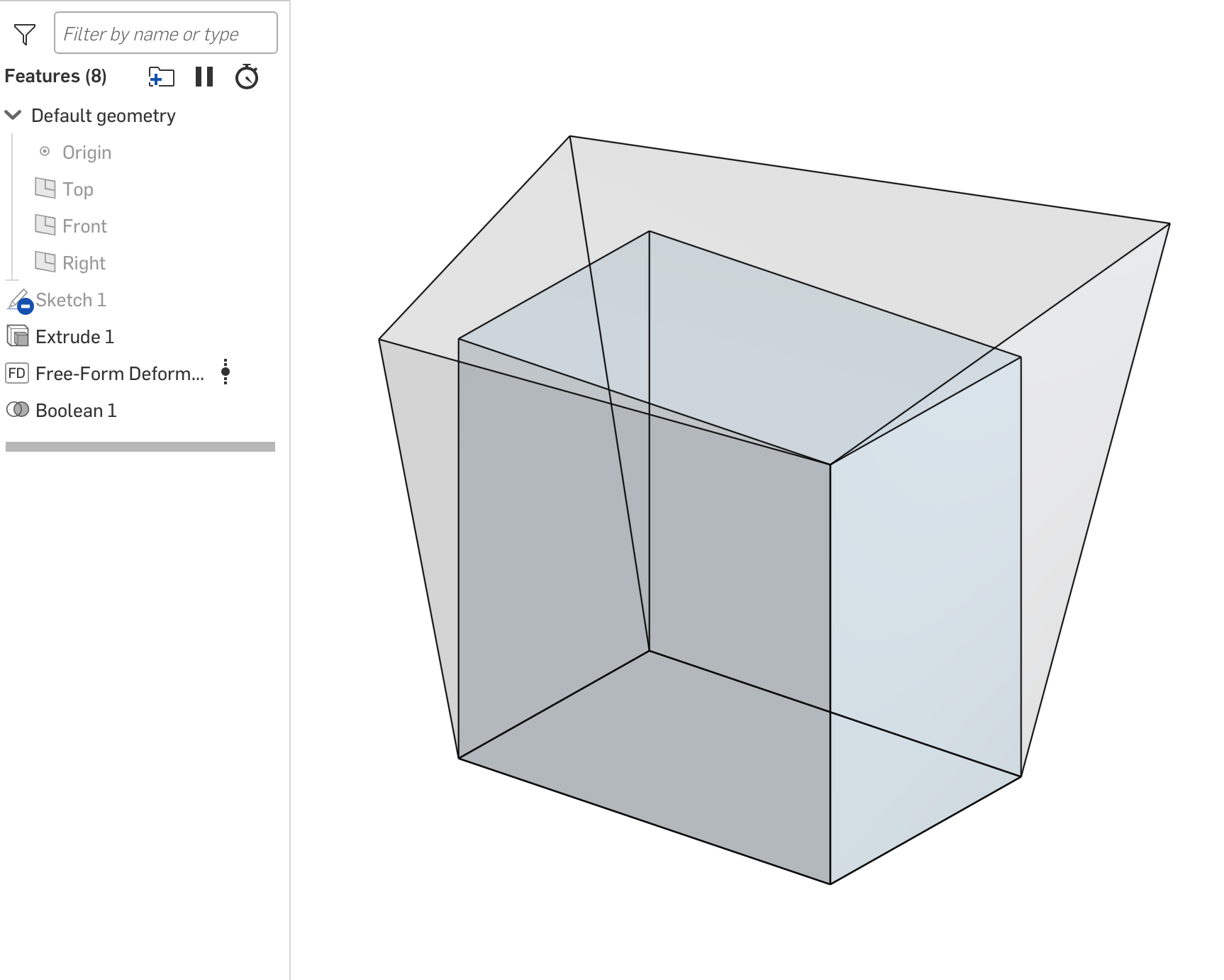

    What I've found so far is that it untrims surfaces, so if you have something that's composed of surfaces which aren't trimmed, you can flex a whole part. It will explode the surfaces.
    Here's a simple example with an extruded box. I had to boolean the 6 sides back together to make a solid. Also note that because the boxes' sides are flat, FFD treats them as degree 1x1 surfaces. I can't bow/curve the middles, but I can twist the flat surfaces to be warped.
