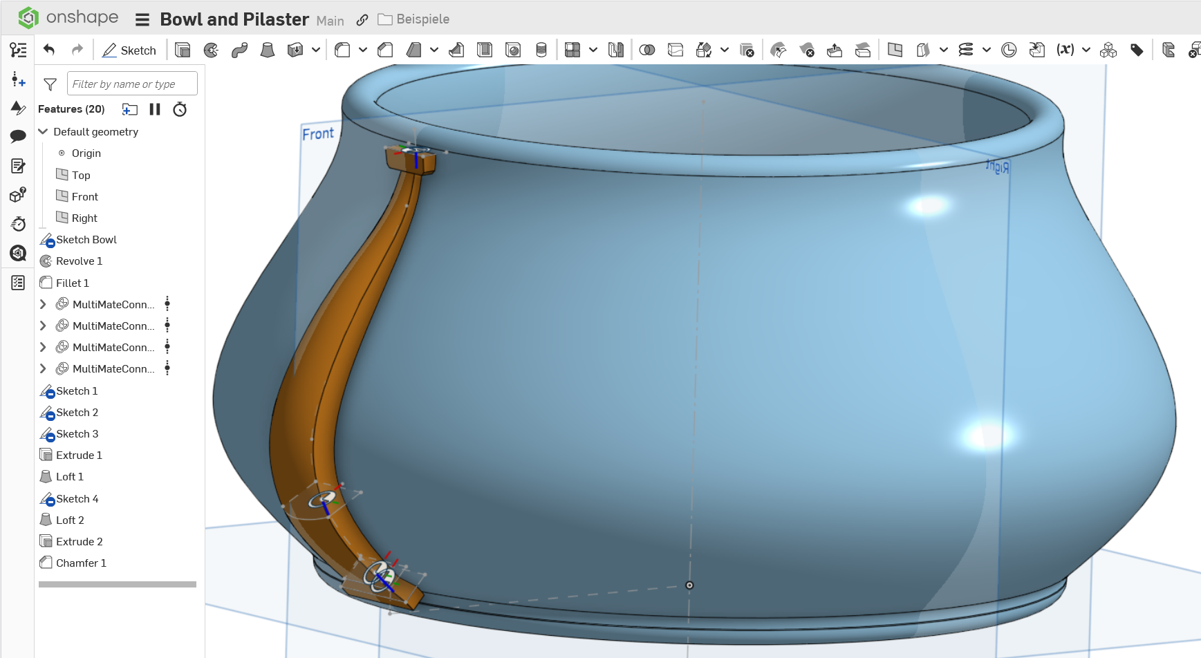

Hi all. I would like to bend an ornate column along a projected curve on a curved surface. I have created a simplified column in the document below and would like to bend it onto the face of the bowl behind it. Is there a way this can be done reasonably? I would like to create a much more ornate column so drawing and extruding it directly on the curve face seems really hard.
If this method seems too difficult, could I instead start with an "unwrapped" flat surface of the bowl and add all of the columns to the flattened surface and then wrap the entire assembly back around the bowl (after writing this, it seems to have the same problem, lol)?
https://cad.onshape.com/documents/86202c50e42847587ee33ffd/w/cc0a2b38dd041a0c369d4ae0/e/1e40f934f2c900c897015652
if it’s on a bowl assuming it’s circular. Wouldn’t revolve be adequate?
There isn't a post forming process built into Onshape I am aware of. It should be possible to build the part based on geometry taken from the bowl, though, so it gets a shape that depends on and follows later edits to the shape of the bowl.

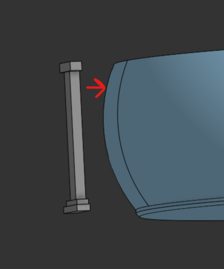

Hi there. I wish to make the column ornate which i think will be very complicated working on a curved surfaces in all 3 dimensions. I was hoping to make the part flat like I show in the image and then bend it afterward. The wrap command is awesome but only works on a cylinder. The work around to use wrap + move face + thicken for a sphere only seems reasonable for less complex features.
possible alternative? use split face and then move face. just tossing ideas.

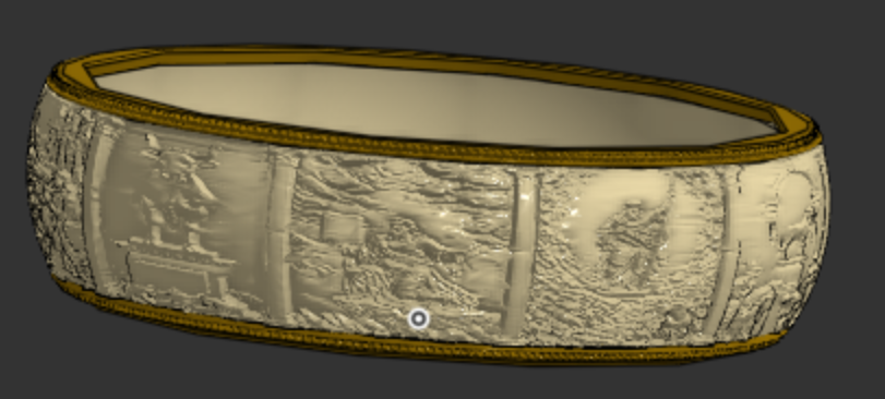

Derek Van Allen | Engineering Consultant | MeddlerHi Evan, very cool that you commented as my hope for bending the columns is part of an effort to make a 3d printed bowl that has the exodus story blended onto the side of the bowl using your awesome new displacement map feature script :-)! In this version of the bowl, I used the image to generate the columns as well as the top and bottom rim features. After printing the images turned out pretty good given the resolution reduction to make the displacement map tolerable. However I felt like the rim features and columns could be much more crisp if I modeled them and would also remove some load from the displacement map.
I am still trying to figure out the best way to implement the displacement map as it didn't want to work with replace face and it was a struggle to figure out a way to make the new surface into a solid. Making it into something I can make an ornate rim feature will be the next issue to work through :-).

Ah, i see. I do think that modeling the columns will be a better result. I'd sweep the main column part (or loft if taper is needed), then model the corbels flat and transform them into position at the ends. Then you could even do a different image per square if you wanted.

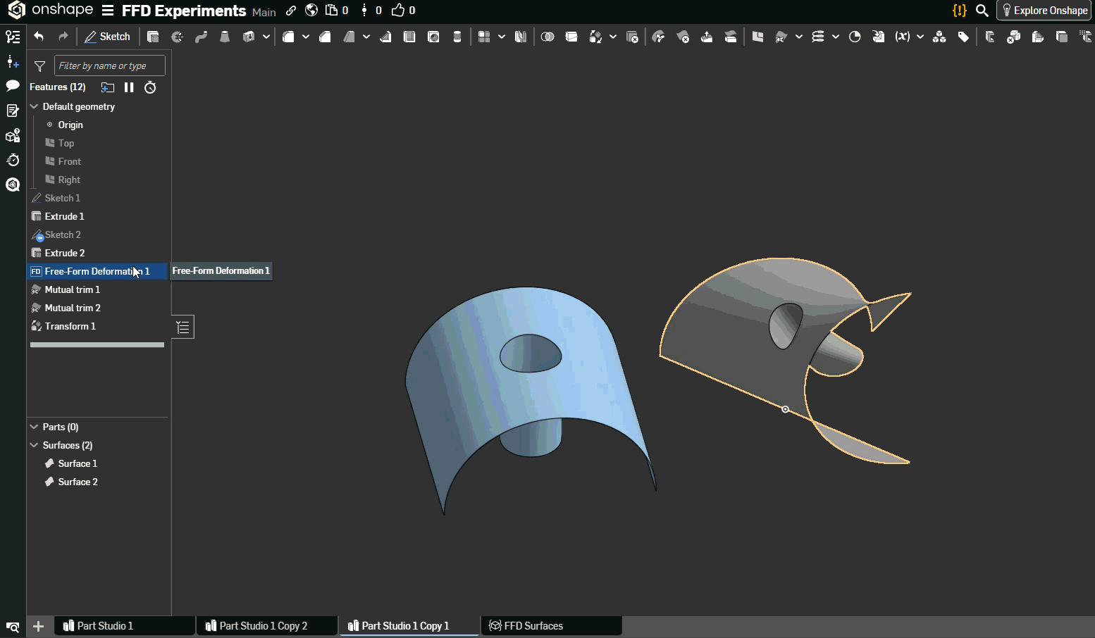

@EvanReese on the other hand, who needs Parasolid utilities when we can just borrow from my very good friends Sederberg & Parry?
WIP obviously.
Derek Van Allen | Engineering Consultant | Meddler@Derek_Van_Allen_BD 🤯 unbelievable! I strongly recommend taking a look at the functions of each of Rhino's deformation tools for inspo.
Ah to be a developer that can make tools that run without a feature tree, utterly unconcerned with build time. I'll definitely be stealing some inspiration from the Rhino UI for the final iteration of these tools but for now I needed direct control over all of my lattice points to prove some functionality. I think my next step is to poke at that Flex / Taper custom feature that's been floating around for awhile and rip out the surfacing core and replace it with proper FFD utils.
