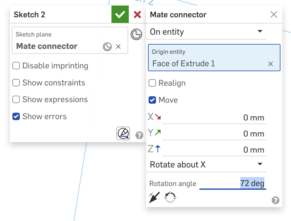

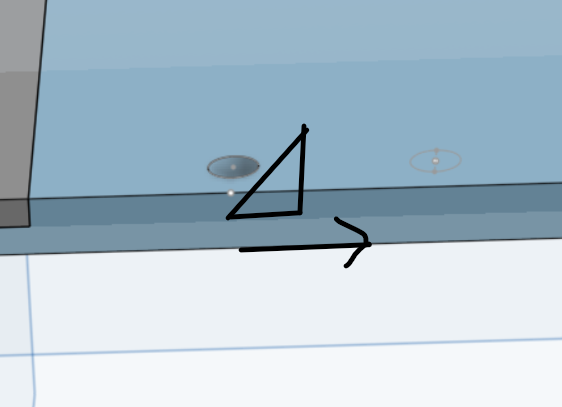

Trying to drill a hole slanted for truss in a model bridge build
use 'direction' in the extrude feature
That would result in an elliptical hole by cross section. You either have to set up the sketch on a tilted coordinate system to start with or move it after the fact with a move face.
Derek Van Allen | Engineering Consultant | Meddlergood call

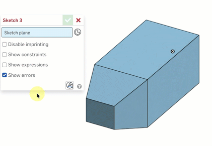

To clarify, to sketch on a tilted coordinate system, use the Mate Connector selector when selecting your sketch plane. Then, you can modify that Mate Connector and rotate it 72 degrees.

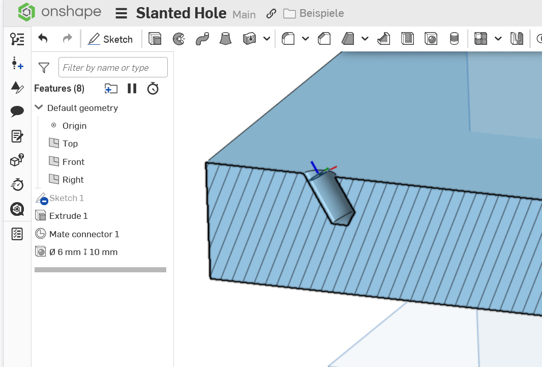

Why not just build the hole feature on a Mate connector that can be rotated into any desirable position?
https://cad.onshape.com/documents/d5fb8e70c12cc26cd37f38ae/w/fc39d77c9770a41bef19209f/e/674f0548bf03781af7d9faf4?renderMode=0&uiState=697bd299ad52fdfd1cccbcf5
no need to create a mate conector. Just create a new plane, using the existing face as a reference and an offset angle. than sketch your hole in this new plane and extrude it (use use the hole feature)
No need to create a plane. Just create a Mate connector, using the existing face as a reference and an offset angle. Then forget about sketching your hole in this new plane and extrude it, just use use the hole feature instead. ;0)
