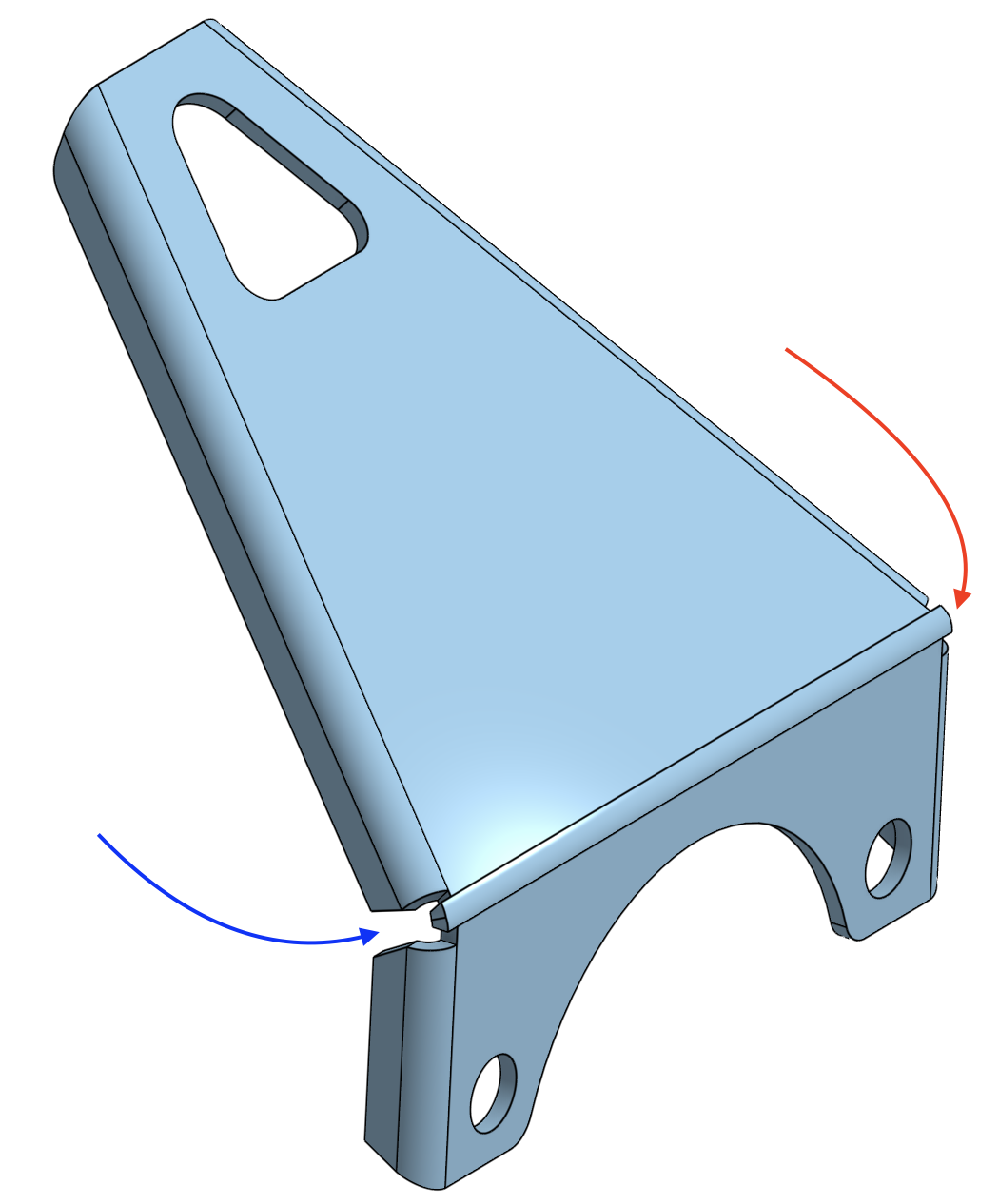

sheet metal bracket with flanges for welding
Looking for a little help from the sheet metal experts. I want the flange joints to meet when the bend is made but I can't seem to achieve this effect. The intent is to form the 4 flanges, bend the part, then weld the joint where the flange faces meet (blue arrow). The 'hole" at the corner will remain, so the protruding material (red arrow) needs to go away.

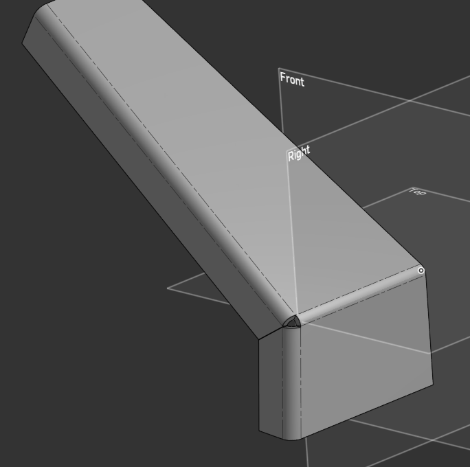

But here's one way to do it:
EDIT: "move face" can do a lot in Onshape so you might just be able to move these bits in…

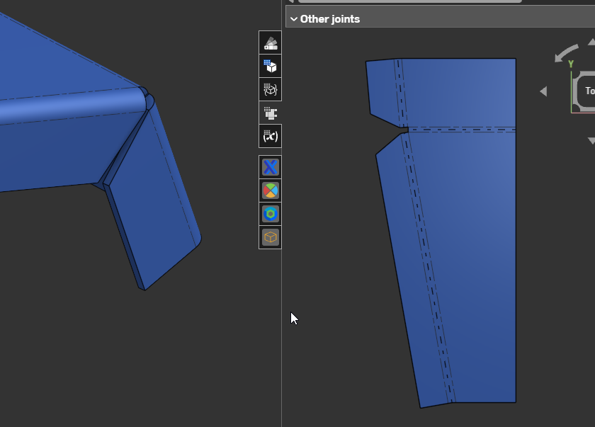

Also if you bend both flanges 90 you get something like this and reduce the gap with a move face:0 -
I think that first solution is exactly what I need. Appreciate the assistance, Eric.
