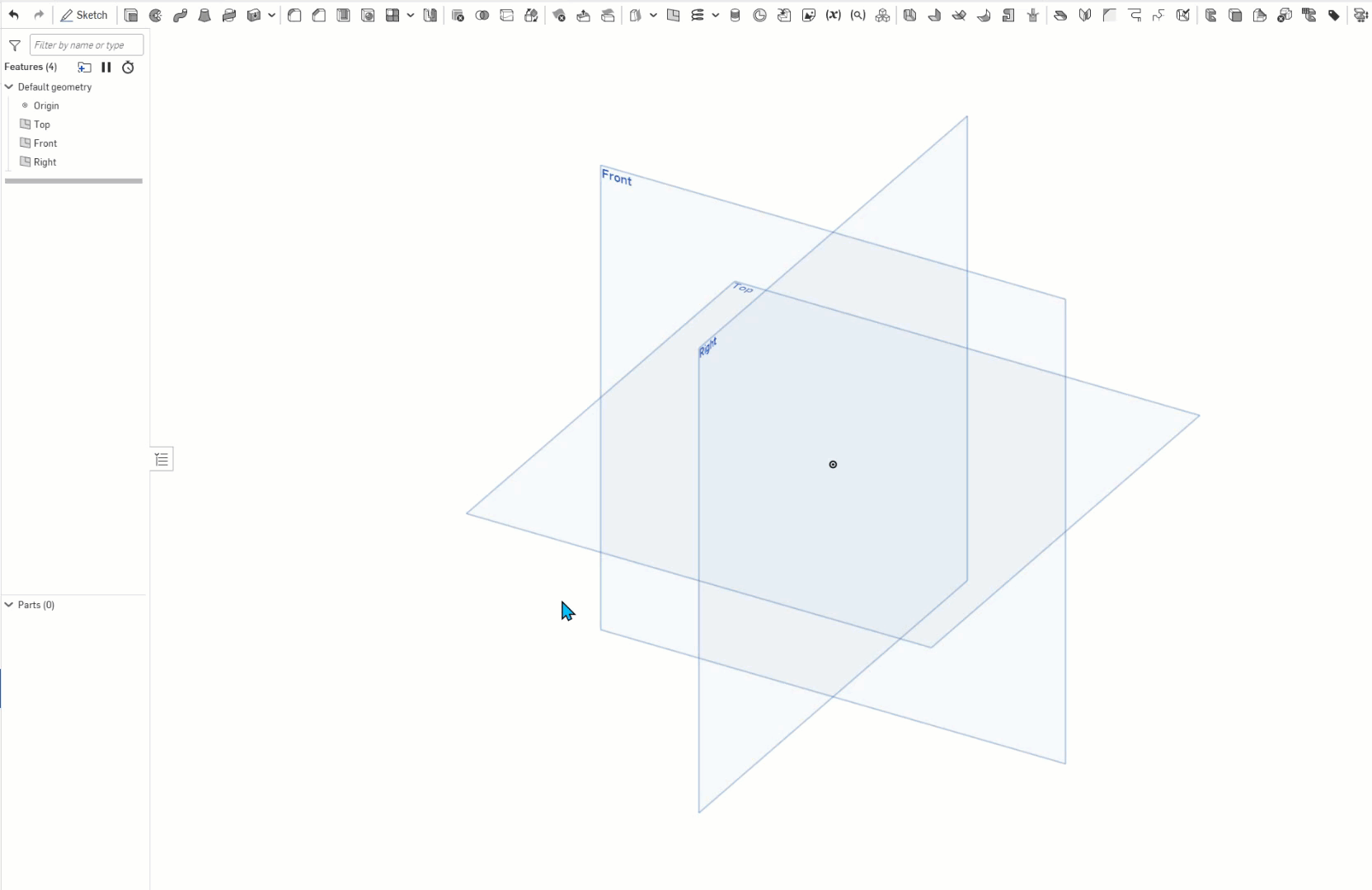

  • john_mcclaryjohn_mcclary Member, Developers Posts: 4,059 PRO
    FS: Stock Size | stockSize.fs
    FS:Sheet Metal Bend Table | Bend Table Feature.pdf
    You can make a copy of the two features above.
    This is how sheetmetal workflow looks like for us
    Frist use the BendTable to choose the thickness you want, then you can choose the tooling to define the bend raidus. This also shows what the minimum flange length for that tool is also so the designer doesn't have to reference a chart.
    That creates two variables #thickness and #bendRadius now any sheetmetal feature you create after the bend table you can reference these variables. Which helps when you want all your materials to be the same thickness. It is just one place to change all the parts below.
    There is an option to put a prefix there as well so you can have multiple thicknesses or bend radius, such as for a guard. That way you don't have to keep redefining between thick and thin pieces in your feature tree.
    Then the stock size feature can be copied and set to your company's custom properties, which can then be referenced in a drawing or ERP export.
    As you can see, the StockSize property is for the drawing callout, then all the sizes are itemized for our ERP system to check material inventory and flag to order more sheets.
