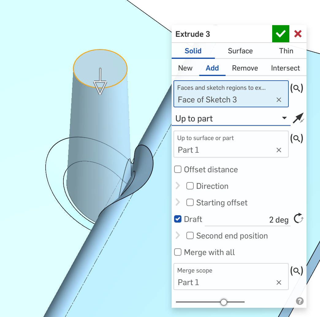

I'm working on an injection molded boss custom feature. I'm trying to get the bosses to extrude to the part with or without draft reliably. In doing so, I'm discovering weird things about UP_TO_NEXT or UP_TO_PART which are causing issues.

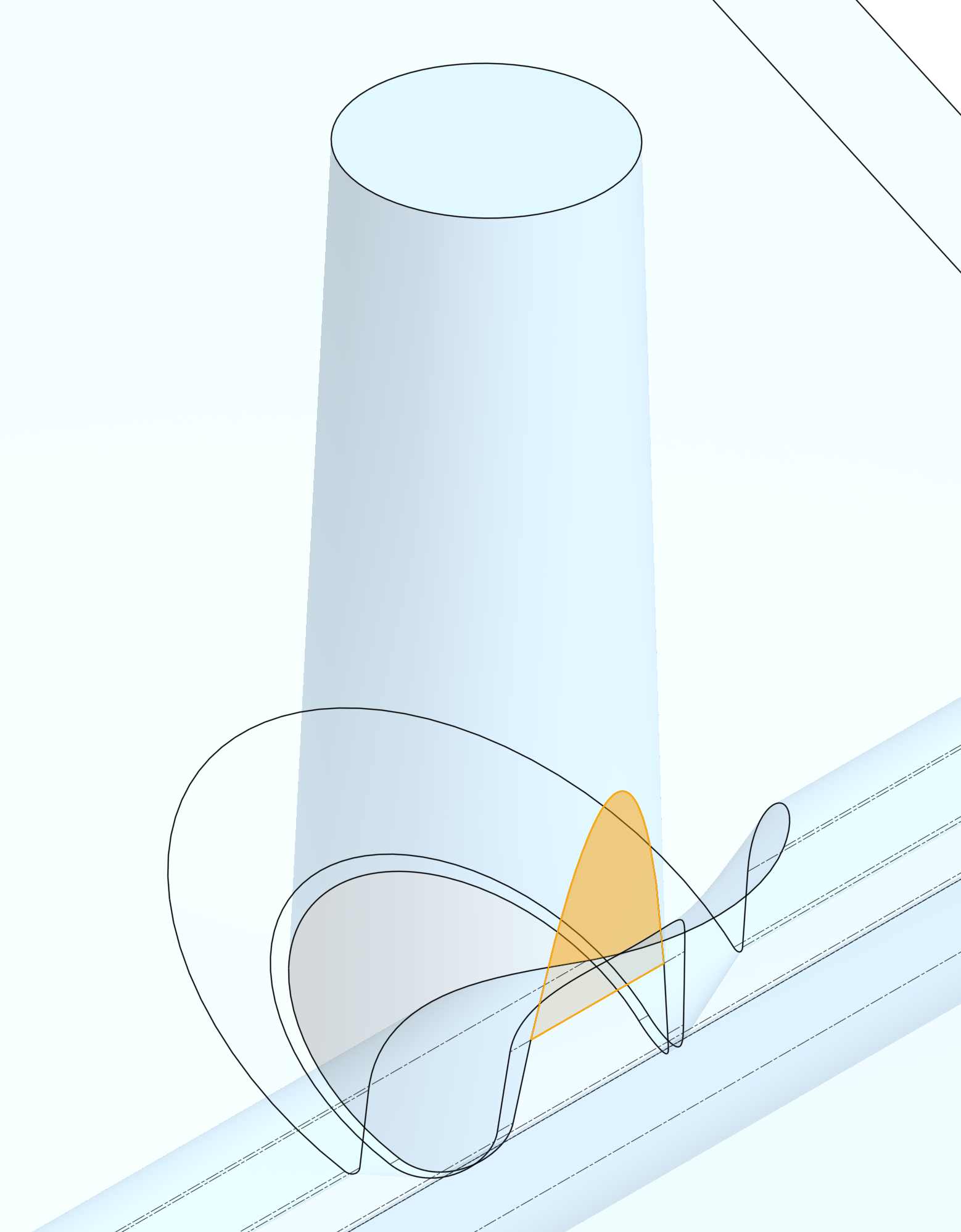

Here's a manual feature based version of this issue - if I use up to next or up to part, I get this weird face at the base of the boss where it's joining a complex wall. It doesn't matter if I add the draft in the feature or after, with this edge case, it always adds this surface where I don't want it. Is this a Parasolid bug?

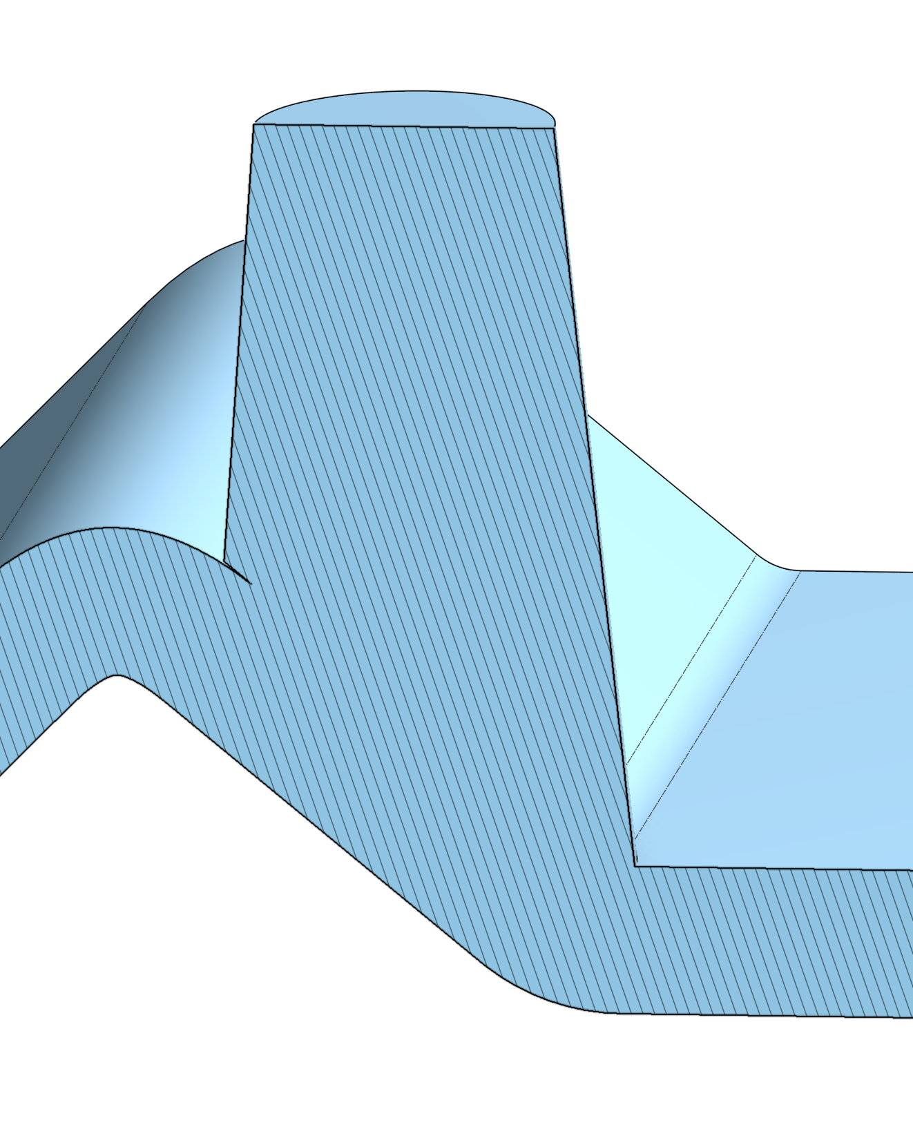

If I use Through all, it does the right thing:
Obviously I don't want the extra bit on the outside of the part, and I can use delete face with heal to solve this, but I will need to be clever with queries to grab all the right faces, and then hope that heal doesn't do anything stupid.
I feel like I saw something similar in how some (all)? of the rib features are implemented. Is this a normal way to work? Is it more robust than up to next or up to part?

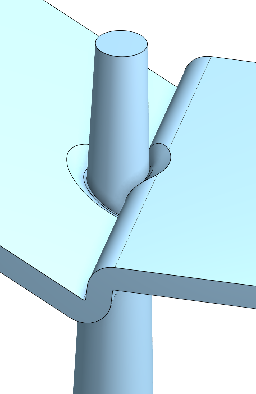

    Very interesting. On further experimentation in regular Onshape, New vs Add both with Up to part, gives different results (besides the obvious boolean). With New, and Up to part, draft is treated differently. It seems like the most robust sequence is to extrude with add, then add draft after. I would have thought that adding draft while extruding would be better for topology challenges. It seems like the mounting boss feature is doing exactly that - so I'm really baffled.
    However when I try that in Onshape CAD with test cases where the undrafted cylinder doesn't overlap a tangent connected face, it does stuff like this (leaves a defect at the base of the boss on the left in this image):
    Is there something I'm missing?

    When adding a draft to parts, I have seen it either fail or do some weird things when the drafted surface crosses over onto a new face, like what you are showing. Have you tried extruding up to part as New, with a slight offset into the part, then adding the draft, before using a boolean to join them?

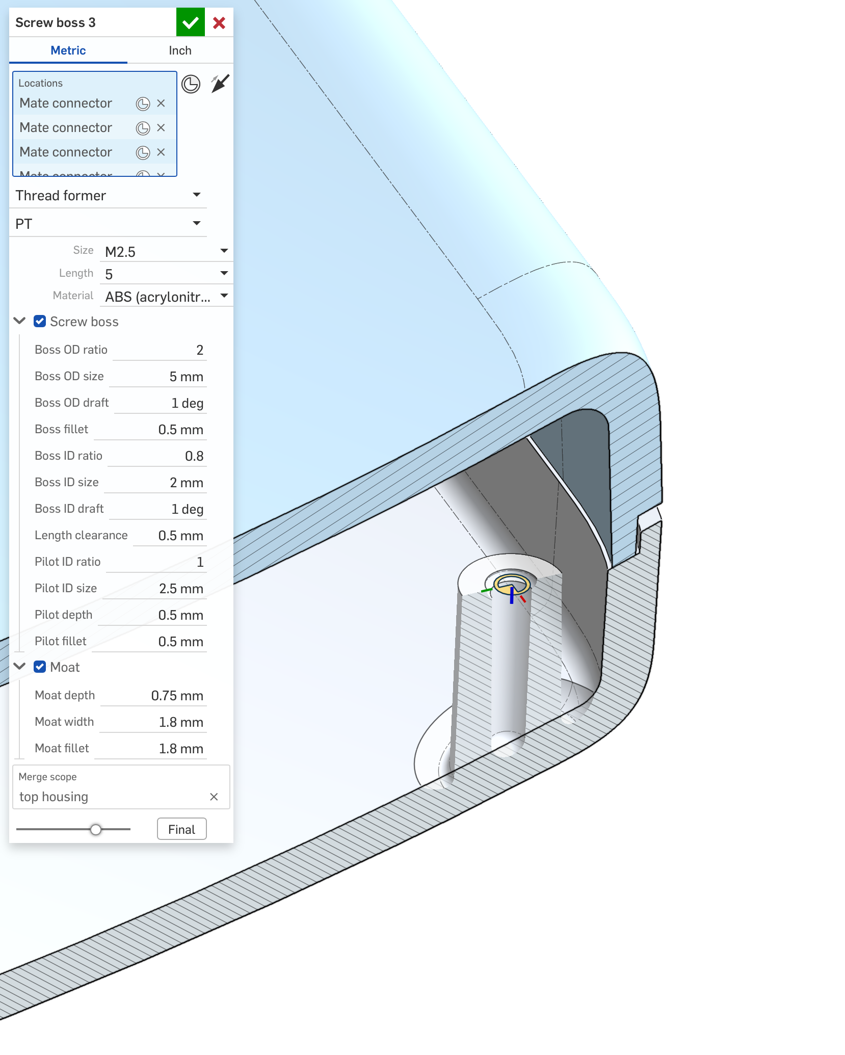

    As an update, I want to show some of the progress I've been making on my Screw Boss feature. Almost 1700 lines of code, and I "wrote" 3 to get the include references correct.
    I only have the screw boss side of this working (planing on clearance boss, gusset ribs, etc), but it basically just needs a location to start with, and some choices about screw type/style/size and the material. This drives the boss geometry (OD, ID, etc) based on industry guidelines. Much like the first part hole feature, it finds the targets per location, and does the right things - magically.
    The hardest part is what is often called a "moat" - the local thinning of the boss where it joins the wall. I'm still trying to dial the method for this in, but I also managed to get a spherical end which is tangent to a fit plane (and the drafted core pin) at the moat depth. This keeps the core pin radially symmetric and improves boss strength.
