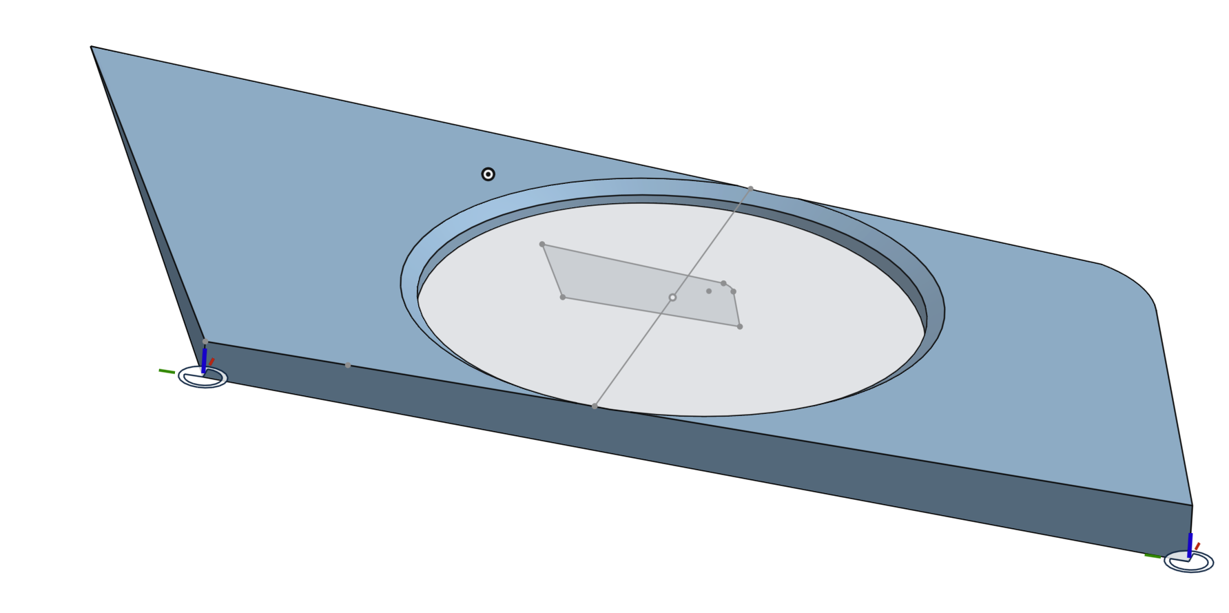

just started with onshape/cad drawing and need some help.
I needed to make a spacer for for a turbo airintake , and managed to make the right shape, but I just can´t get the depht/width right.
The object should have a different depht on all 4 corners, can anybody help?

    You could put mate connectors at the correct depth at 3 of the corners. Then make a plane and split the part.

    Hey Jack. The top surface is curved? The bottom surface is flat? - Scotty

    thanks for the help Mat, but I just started with whole 3d/onshape and learning curve is quit steep.
    could you elaberate a bit more, I managed to make a new object whitout the imported image file in the back.
    where should I start with setting the mate connecters? edit sketch1 or the extrude?
    @robert_scott_jr_
    both top and bottom surface have a curve in one corner, are the same.

    @Matt_Shields ,
    Thanks for the help, this is what I meant.
    but I have to learn more about using the mate connectors.
    the base depth at the curved corner should be 20.5 mm , then mate connector 1 should have 8mm depht,
    mate connector 2 should have 2,5mm depht, and
    mate connector 3 should have 15mm depht.
    But when I set base depth with extrude, it doesn´t correspond with actual depht when I use dimension tool to check measures.
    Have to read more manuals I quess.
  • nick_papageorge_dayjob
    I'm lost what you are trying to do. Are you trying to make an angled spacer to go between the plastic commercial part you shared in post 1 (as a picture), and a piece on your car?
    Off topic, why did you use a transform to scale your part? Why didn't you draw it initially to the size needed?

    Yes I´m trying to make an angled spacer .
    I scaled my part cause I initialy started with an image/scan of the outside lines of the part , and then draw over the lines to get the exact angles of the part.
