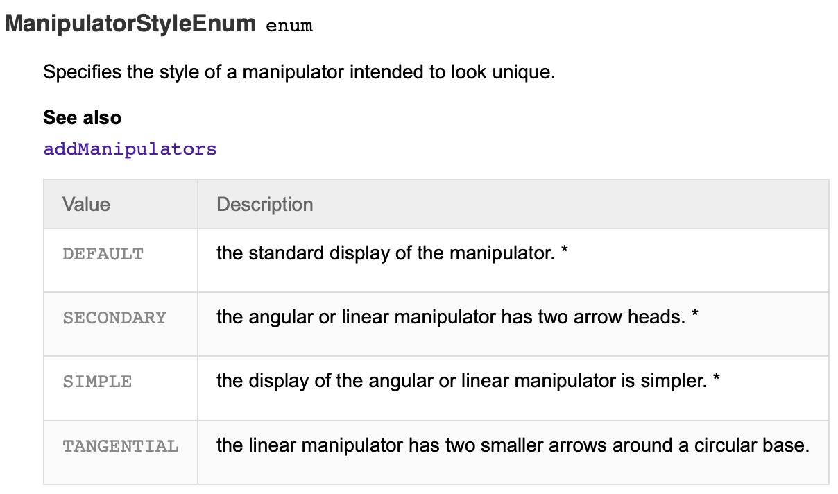

Does anyone have a cheat sheet for all the manipulator styles/types? There are no illustrations in the standard docs and I had to dig around to figure out that the one I was looking for is called "tangential".

    Thanks. That covers the styles:

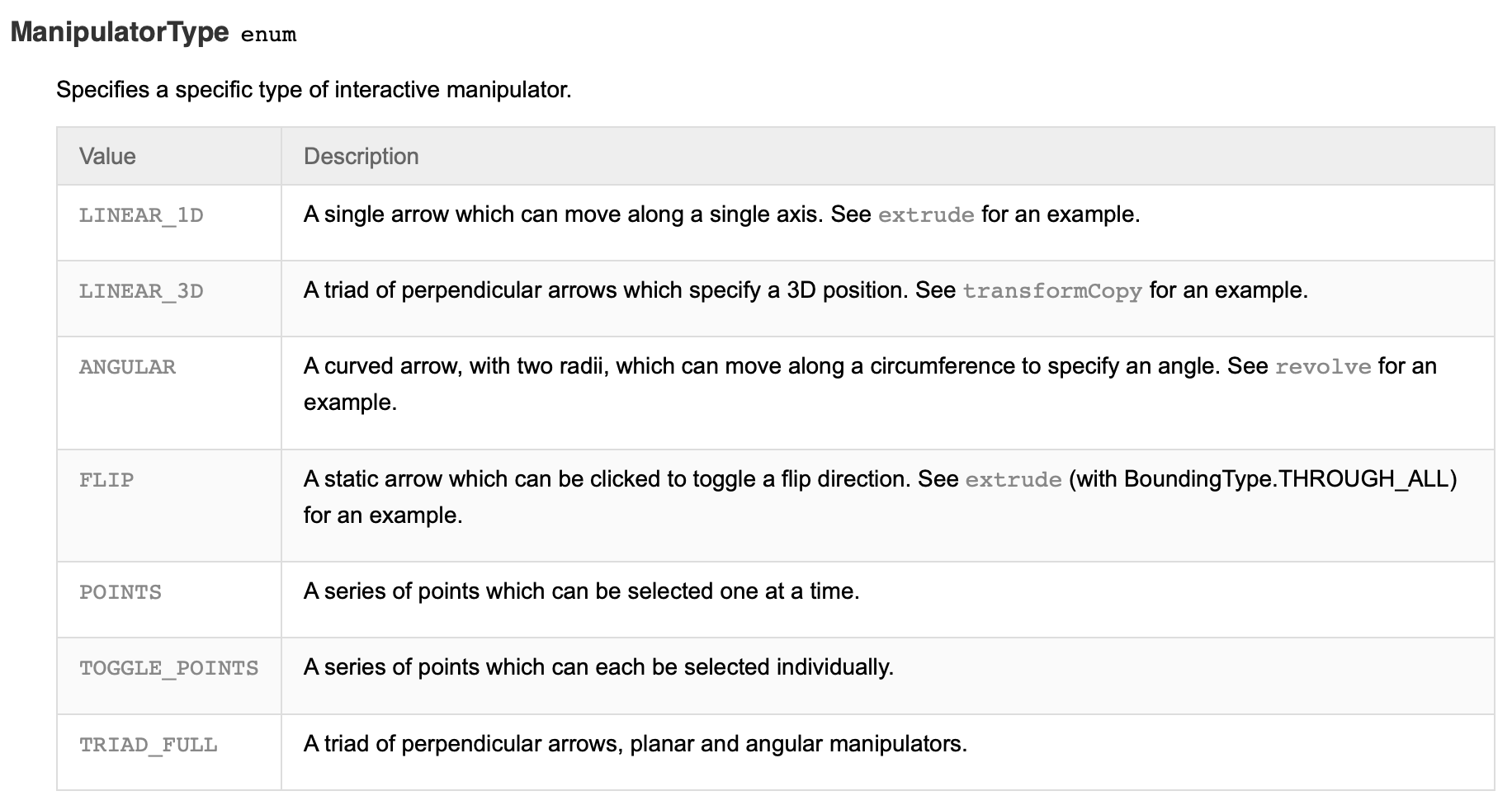

    But then there are also a bunch of types:
    And then, can I have a secondary/triad_full?

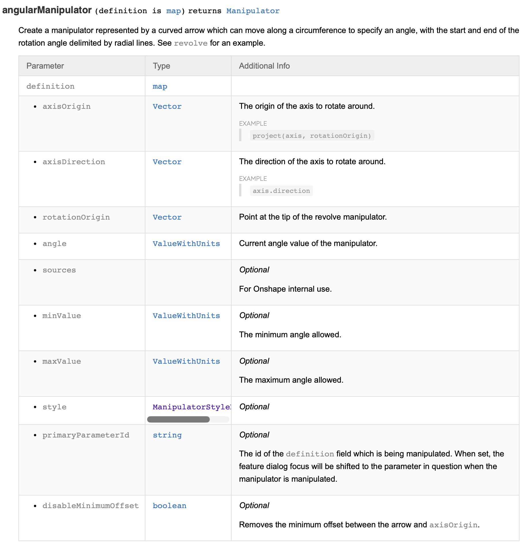

    Angular is really painful without a diagram of what the various inputs mean:

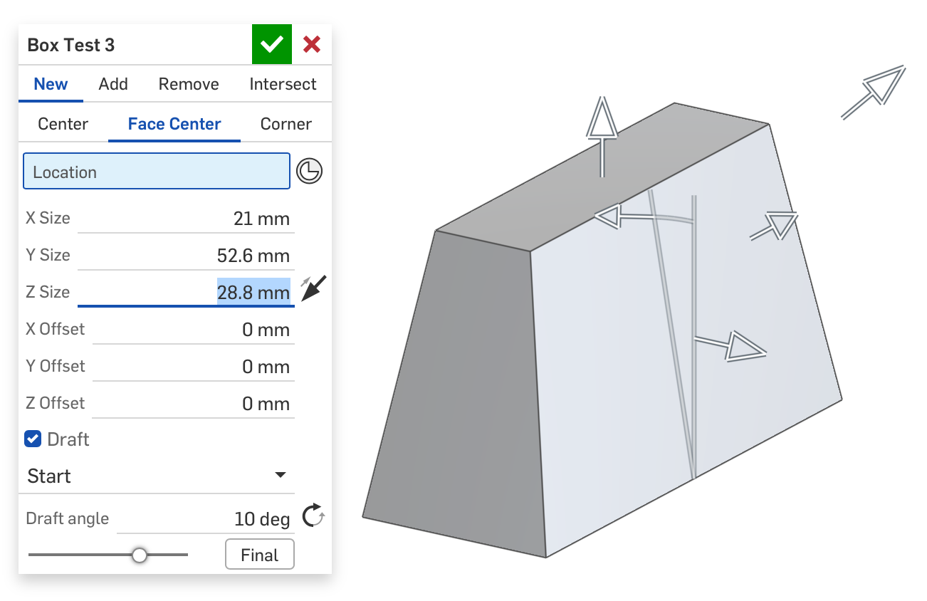

    When I set up a pretty simple test feature, it took me a lot of flipping and axis choices to get to the point where I finally got the draft manipulator on this in the right orientation:

    What about the angular documentation could be improved? To me, everything looks pretty well explained.
    S1mon Member Posts: 4,602 PRO
    In retrospect, I guess the angular info is clear-ish. However, as I was trying to use it to drive draft, in my brain, pull direction is one of the most important "axes", and I assumed the stationary line of the manipulator was the axis. The axis is actually not a visible part of the manipulator at all. It's the axis of rotation. Again, in retrospect, I imagine that the positive z of that vector defines which way the angle winds, and the x or the y defines the stationary part. However, a simple diagram would have really made that a lot more clear.
