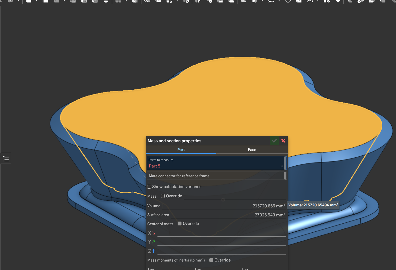

Want to drive a sketch dimension based on a calculated volume. Is this possible?
What I really want to do: Simple example

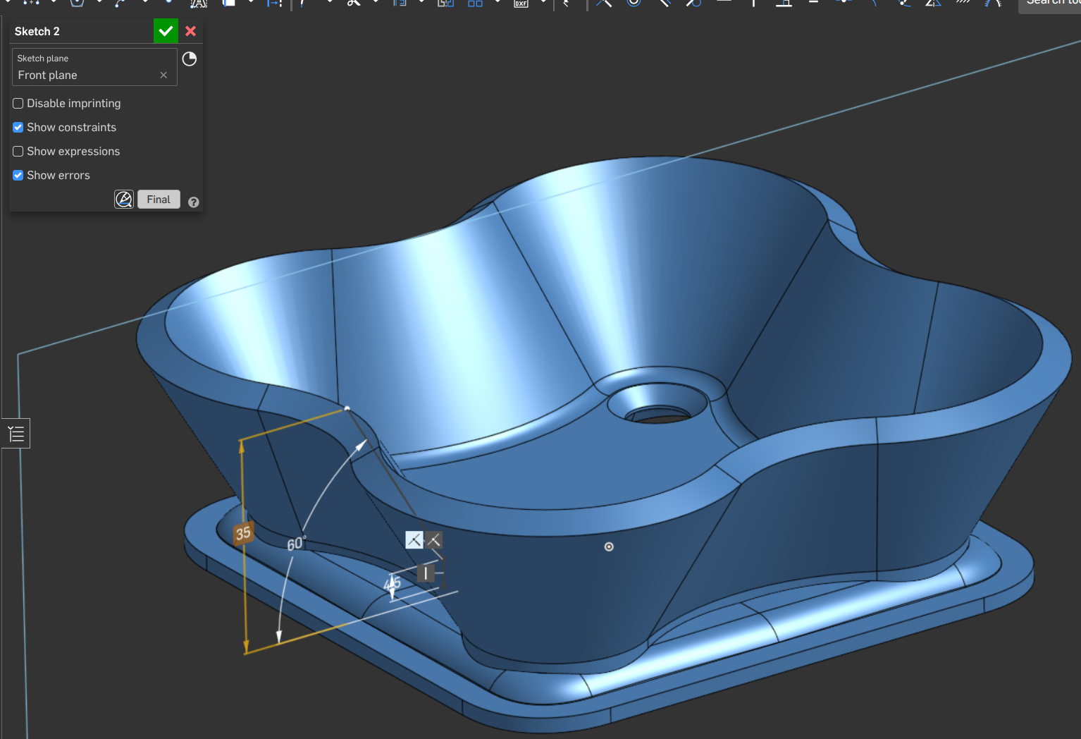

Define a "cup" volume and have that drive the sketch height of the cup.
I realize this requires recursion or a formula for height to volume, which is easy for a cylindrical cup. But what if my "cup" looks like this? Ignore the obvious holes.
I created a part to calculate the volume from.
Stuck there. I believe I could do this in Creo, but that's neither here nor there.

I made a similar thing in solidworks using excel years ago and wanted to replicate it in Onshape but better. If you look at it, it is using an offset plane driven by a configuration variable to split a volume similar to yours. Then the feature iterates that configuration variable to get to the desired result. If you are struggling I can help.
