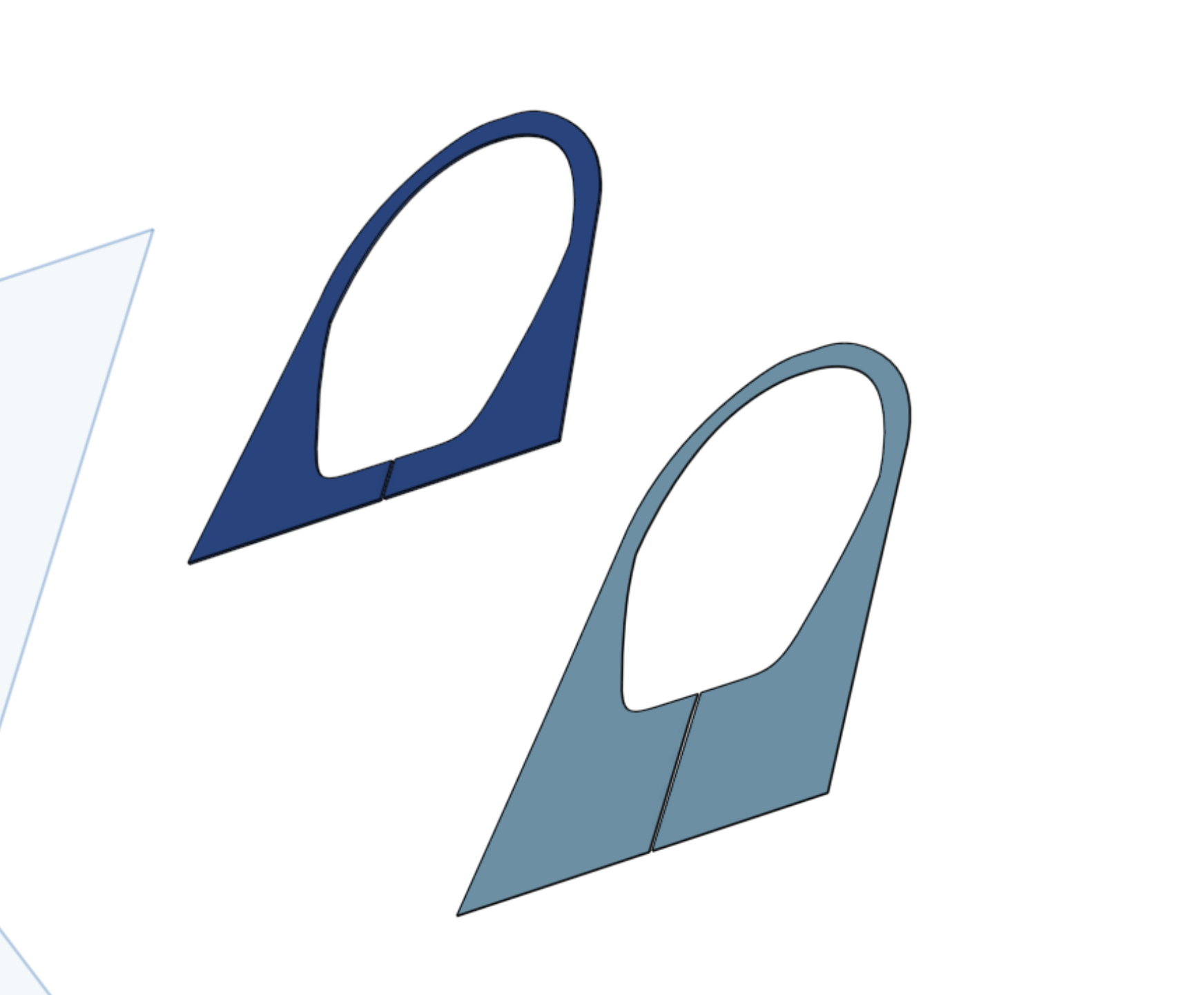

I am having a lot of trouble using loft to join these two parts in one 'continuous tube'. Any tips would be great, thanks!
  • michael_stallsmichael_stalls Member Posts: 67 PRO
    the parts look symmetrical ..id split both surface down the center and try lofting the two halves. make bridging curves connecting each corner edge curve transition to use as loft guides.
    i meant loft it as a half then mirror about center plane
  • Matt_ShieldsMatt_Shields Member, Onshape Employees Posts: 941 PRO
    Also, you can't loft regions with innner loops. Might have to loft a solid then a remove.
