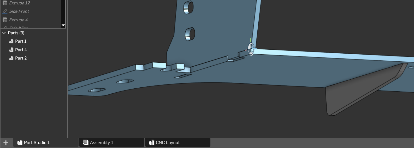

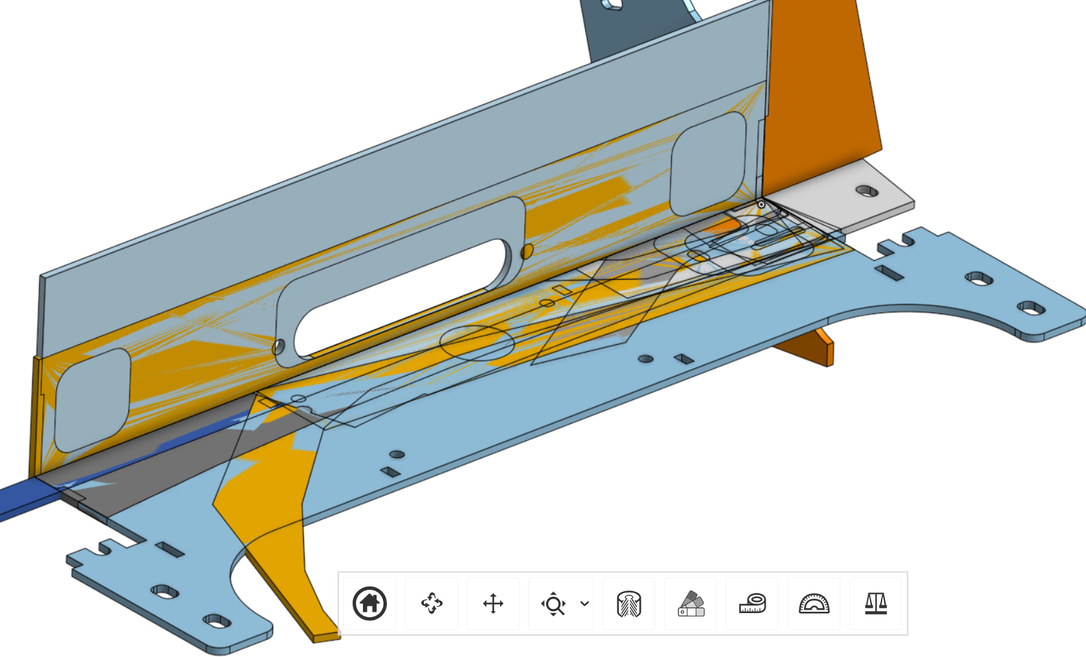

Hello,
I want to use the face of Part 21 to slice off the corner where parts 1,4, and 20 meet. The parts are not arranged in relative position in my Part Studio, only in the Assembly… help!

    The whole point of designing a bunch of parts in a single part studio is to model them in the correct location! So that is the correct way to solve your issue…
    You could probably use "in-context" editing but since you put all the parts on top of each other in as single part studio you will have to create a separate context for each of the parts and it's just going to be really messy (wouldn't be as bad with each part in a separate studio).

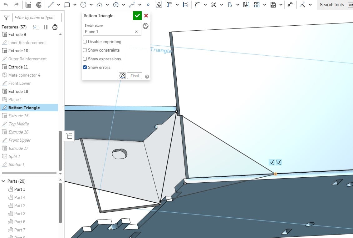

    I created two of your parts in the Part Studio, using two different methods.
    First method: create a Mate connector at a logical location (where two edged line up for example). Then when you create a sketch, select the Make connector as your sketch plane. Use the Mate connector as your origin to dimension to.
    Second method: select geometry from the baseplate to use as your sketch plane. Then either align or dimension from your sketch to geometry on the baseplate to locate the sketch in the final two dimensions.

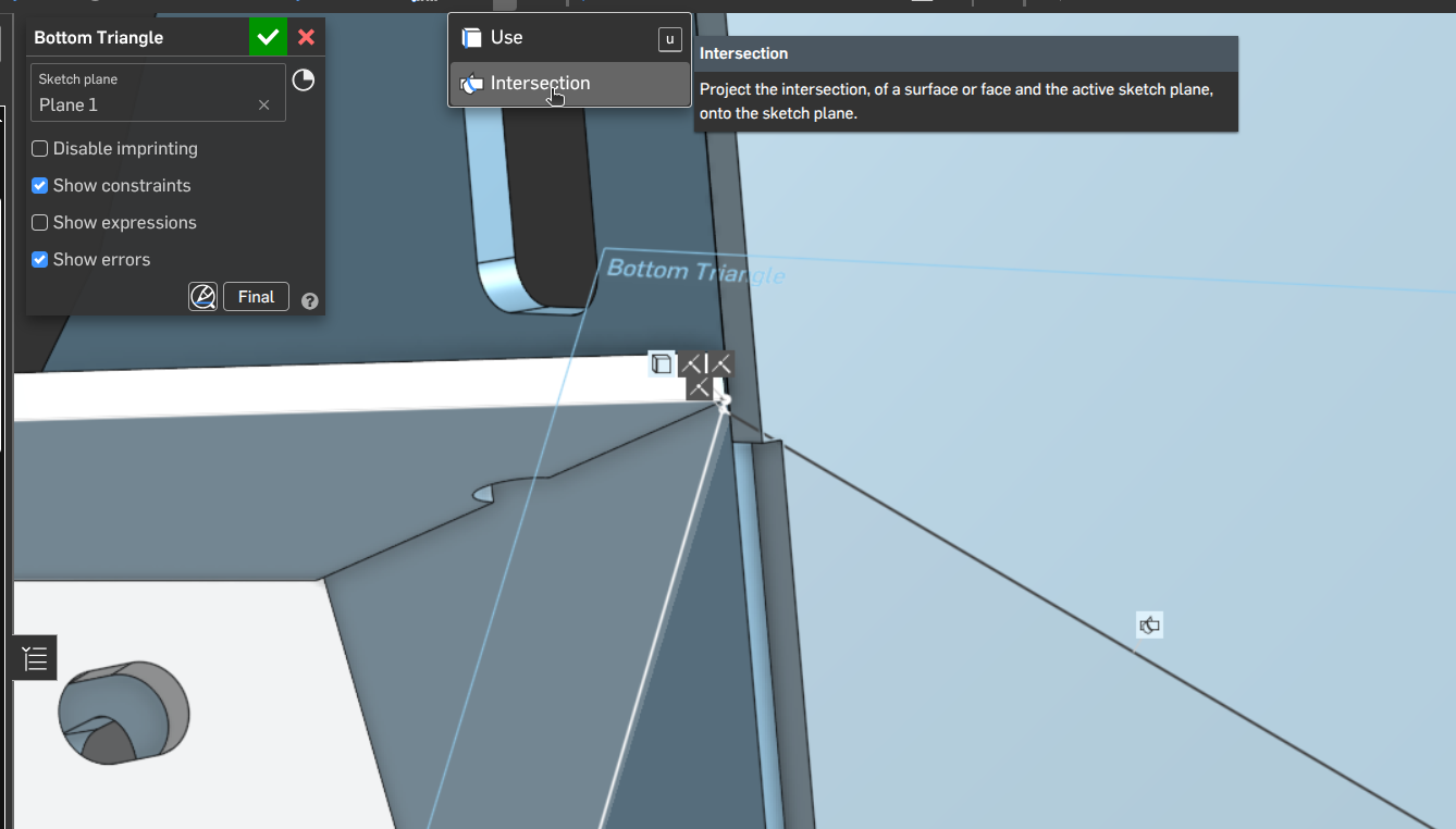

    I see how you used three points on the model to create the plane for Bottom Triangle. How did you created the final point selected below? Was it done using the 'Pierce' constraint in combination with the edge of the Bottom Plate?
  • nicholas_morris261
    nicholas_morris261 Member Posts: 7 ✭
  • SMURFCAD
    SMURFCAD Member Posts: 87 ✭✭
    The sketch used Intersection and select the faces of the parts that are being cut. You could use pierce as well.
