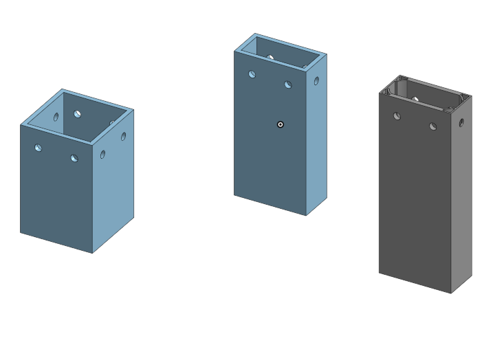

So, I'm trying to make a featurescript that will make holes in the end of square tubes. I got it to make a sketch with a circle, and Extrude it through all, but when I run the subtraction, it doesn't work. Do ya'll know why?
this is my intended result, if it helps.
If you can help, thank you!

    I suspect that your issue is the queries that you're passing ito the boolean:
    "tools" : qCreatedBy(id + "extrude" + i), → All entities created by (id + "extrude" + i). Bodies, Faces, Verticies, Edges, etc. Note that I'd recommend changing this code to qCreatedBy(id + ("extrude" ~ i)). Id's can get brittle, and I've found that concatenated pattern to work well.
    "targets" : evaluateQuery(context, qOwnerBody(qUnion(faces))), —> This seems like a backwards way to get what you're looking for. Why not just pass the part in as a parameter?
    As a quick fix/test, I'd do the following:
    1. Filter your tools down so it's just getting bodies. You can do this by adding an EntityType.BODY and or BodyType.Solid to your query, or by wrapping an additional Entity/Body type filter around your tools query.
    2. Add debug entities for both your tools and targets. Are they showing up as you'd expect?

    Here's what I put for the Boolean
    opBoolean(context, id + "boolean1", {
    "tools" : qCreatedBy(id + ("extrude" ~ i), EntityType.BODY),
    "targets" : qOwnerBody(face),
    "operationType" : BooleanOperationType.SUBTRACTION
