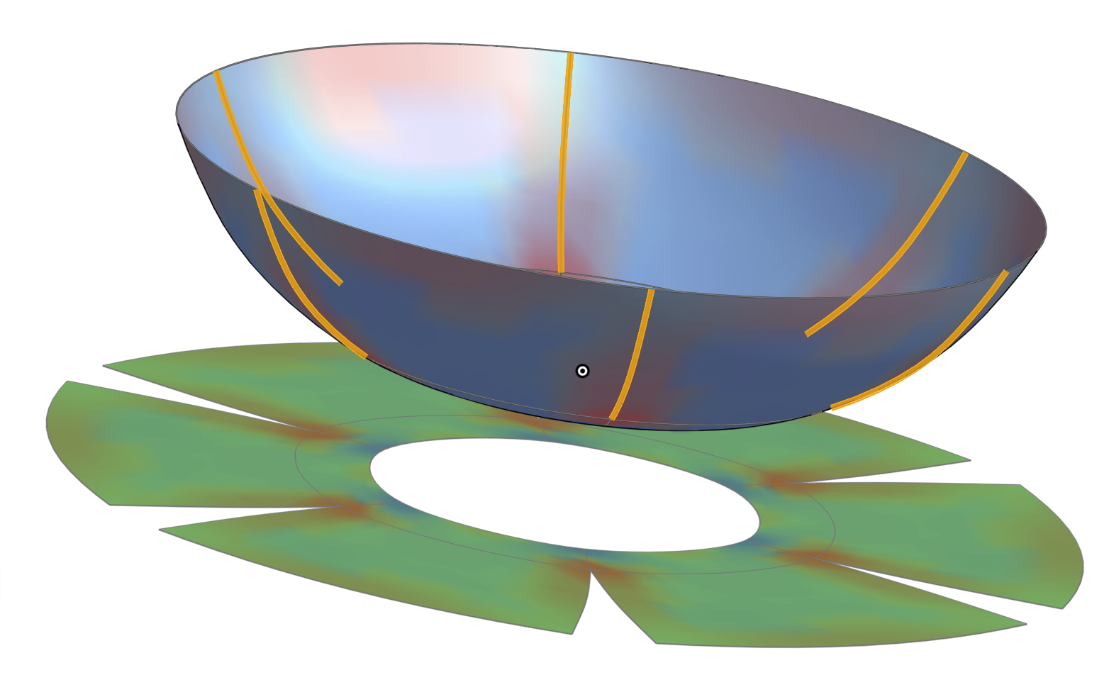

i am an Onshape newbie. I have had others design stuff for me and I would often watch but now i want to achieve a degree of proficiency.
The goal of this exercise is to create a bowl and to add cover for it. The cover should be split into 6 lobes that are sewn or glued together. I may add a sewing edge (or lace the edges together) and it would be great to do all of this.
I created a simple shallow bowl. - just a simple spline for to give the bowl a curvature, then I revolved it.
https://cad.onshape.com/documents/9d9d0aa053d46d04c9596236/w/13b26d4c96a34858171acf51/e/51b1f746f39b75b5df162dba
I figured out how to split the surface using a sketch. prior to that, I tried splitting with planes.

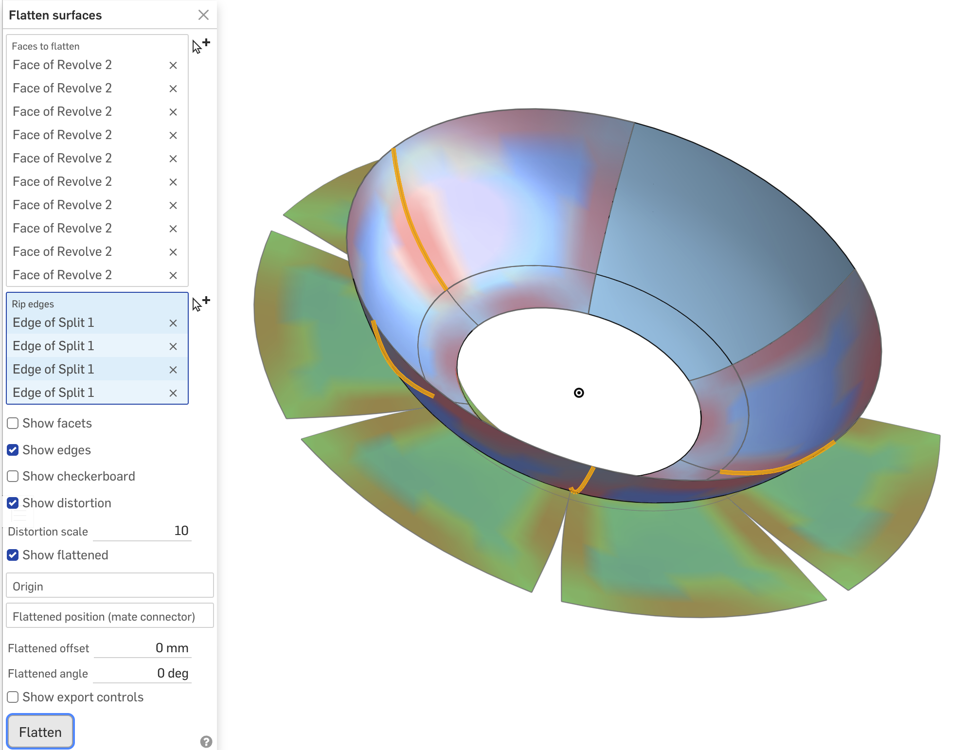

Now when i try to flatten this bowl, it seems to allow me to flatten only one of the split faces.
and that is where I am stuck. Please help.
I fixed your spline (made the end handle horizontal) and was able to flatten the whole thing.
Unfortunately, Flatten Surfaces is an analysis tool, not a feature, so it is not persistent, but I threw the flattened surface into a drawing.

I got it to work last night after puzzling a bit. I kept seeing this warning "Select a single contiguous set of faces.", which was because I was only selecting the lobes and excluding the bottom ring.
This was a great help.
