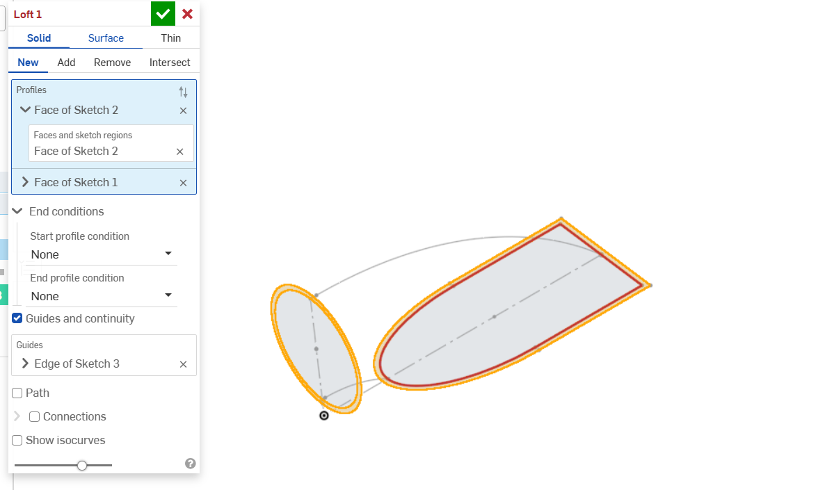

I am trying to get the two faces in my document to loft be each time I try the inner profile just goes red. No idea how to fix this, would really appreciate some help.

    I bet the error you're getting says "cannot use faces or regions with inner loops as profiles."
    S1mon Member Posts: 4,615 PRO
    You need to do the loft in two steps (outside and inside), or loft the outside and shell it.

    Matt_Shields Member, Onshape Employees Posts: 1,000 PRO
    Or use thin :)

    Thanks for the input but I still can't seem to get this to work. What am I missing??
    Try making it thinner? Or flipping the thickness direction?
    Easiest would be to share a link to your public document.

    With a circle you'll likely have to set connections in the loft feature or break up the circle in segments that the loft can connect to the other profile
