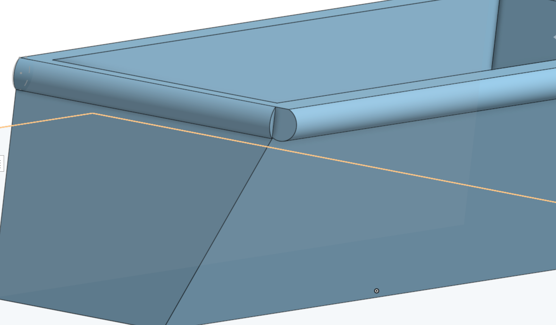

How can i connect these two shapes?
samuel_croudass
samuel_croudass Member Posts: 2 ✭
This might be super simple but im relatively new to onshape…. I attempted to use the sweep tool and nothing would work, i was unsure what to select. i need to connect the ends of those two cylinder like shapes at the top, into like a rounded off corner.
  • martin_kopplow
    If you provided a link to your (public) document, you might get more trageted help.
    In this case, it appears the general approach is less elegant than would be desirable and the problems connecting the shapes come from the history of the design. You can still connect theses faces, but it'll always look awkward, with some leftover faces, because these both ends have so much different properties. Sometimes it helps to start with the corner, then create the sides.
    What if you started the corner with a sphere or a mitre plane?
  • Matt_Shields
    Matt_Shields Member, Onshape Employees Posts: 1,000 PRO
    Can't tell for sure unless you share your public doc, but a loft might do the trick.
