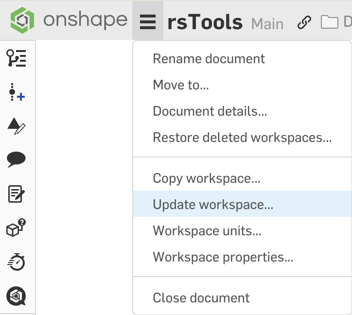

not sure if this is quite what you're asking for or quite the fix for your problem, but a useful thing Ive recently learned about is:
Maybe you can use this to force the document on an old version to upgrade to something mergeable? If you get this working, please post and explain how the situation resolved.
1 -
That looks like exactly the right answer. Thanks!
