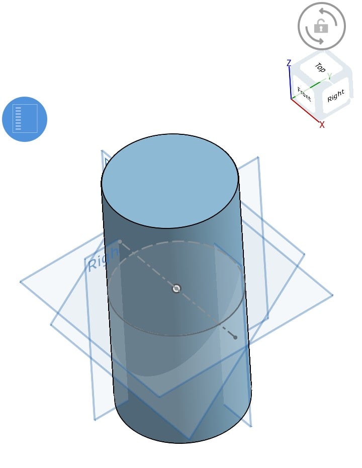

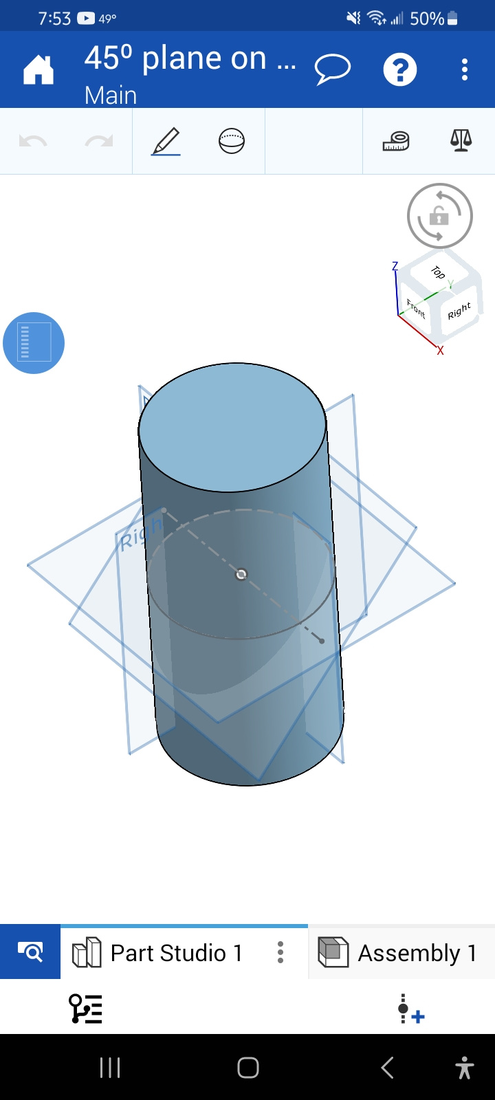

How do I construct a plane at 45° to the axis of a cylinder?
I managed to create a radial plane half way up the cylinder, but cannot find a means to tilt it to 45°.

Sketch a construction line perpendicular through the cylinder axis, then use the "line angle" option when creating your plane

In my current CAD, click "Move", Click the plane, click the direction handle. Type 45°. Done0 -
The cleanest method is to use "Select mate connector" inside the sketch dialog. Then click any mate connector reference in 3D.
Then click to edit on this smaller mate connector symbol.
Which brings up the mate connector manipulator dialog where the mate connector can be moved and rotated around any axis, note that the axis is the local axis of the mate connector itself, not the global coordinate system.
The XY-plane of the resulting mate connector becomes the sketch plane and you can sketch away as you wish normally.

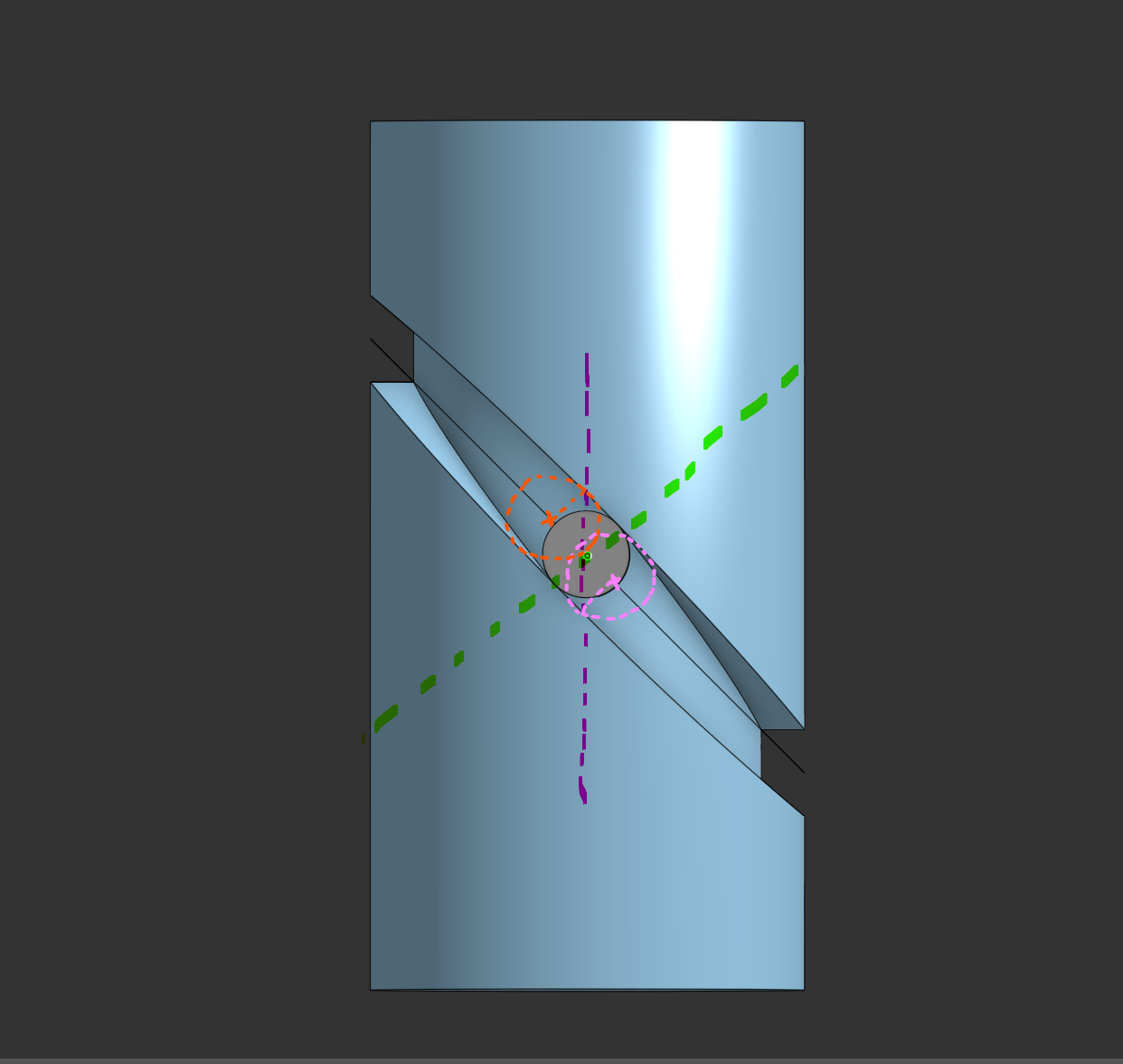

Here's the doc.All of this and more is explained in the video linked by @eric_pesty above, great watch!

Sketch your line on your current sketch. Then use that line to create a "line angle plane" at 45⁰. Then you can create a new sketch on that plane.

There is a "plane angle" option in the plane tool, and there are curve types called "construction curves" that won't 'screw up' your extrude. Now, after you used that, you only need to:
A - Use the split tool with the angled plane on your cylinder surface to 'cut' it, or
B- Use the tilt plane as another sketch plane and apply the "intersect" feature with the cylinder sleeve surface to create the ellipse as a 3D curve.
Or, if that fails, you could just
C- Sketch up that line at 45° and project it rihght on the cylinder to get the 3D ellipse.

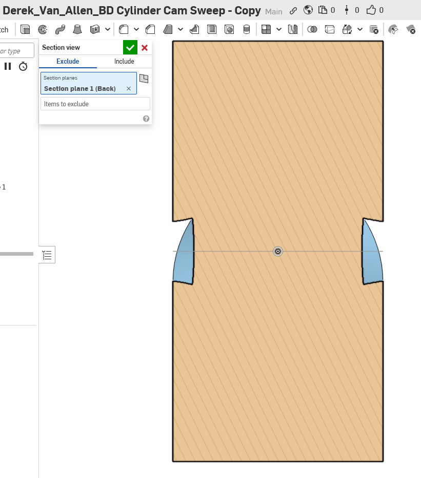

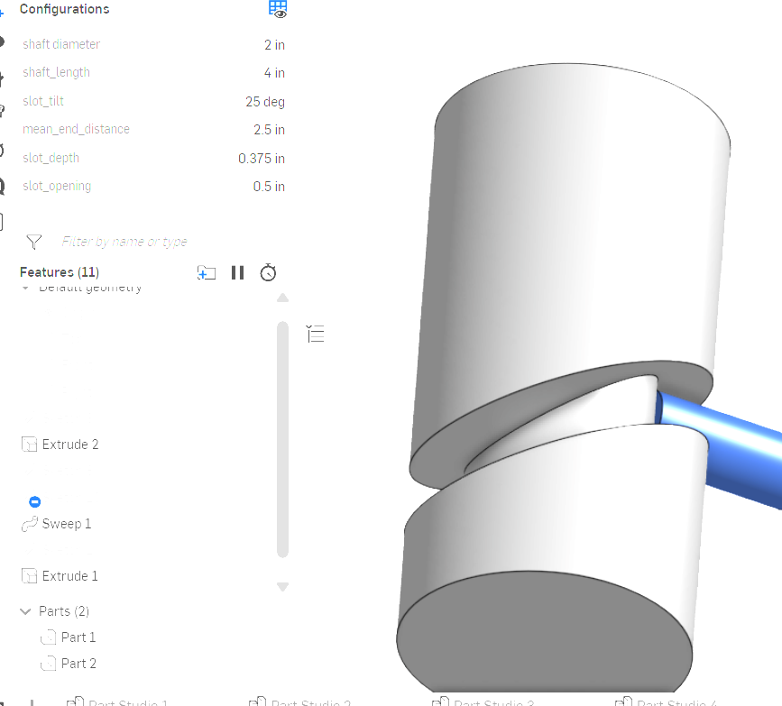

There is a lot of back and forth here about mate connectors and angled planes to produce your sketch. You most certainly want to learn how those work since they will save a bunch of time for all work in OS.
In the mean time the 'WRAP" feature will will get you there much quicker for a slot like this.
Ps. Half wrap and mirror because OS has a problem if you go 360deg. Produces a non manifold condition or the like.

create a mate connector directly in the sketch dialog, you don’t need a plane prior at all. "

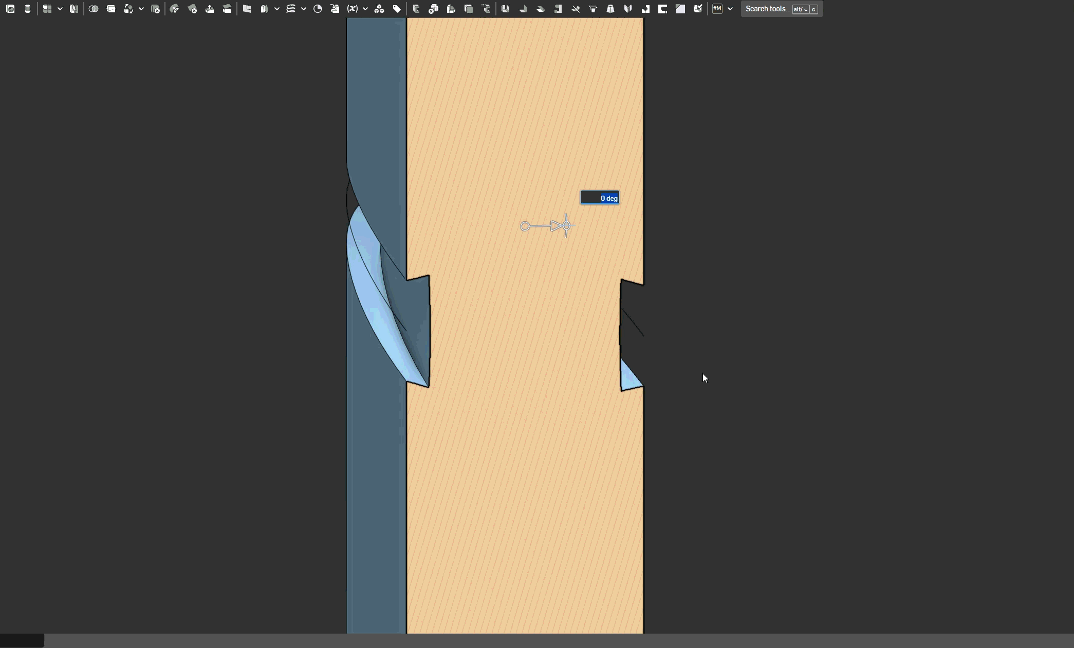

Well. I eventually got a sketch plane tilted at 45° to the centre of the cylinder, without an intermediate sketch or plane. And I even managed to start to construct an ellipse on that sketch plane at its mid point, but from there, with no method obvious to reference cylinder that defines ellipse I need, and no apparent way to orient it to the workspace ordinals; nor even orient the sketch plane to the screen whence I might eyeball the edges of the cylinder, nor any way to type in the mejor and minor diameters; the whole exercise to this point is useless.

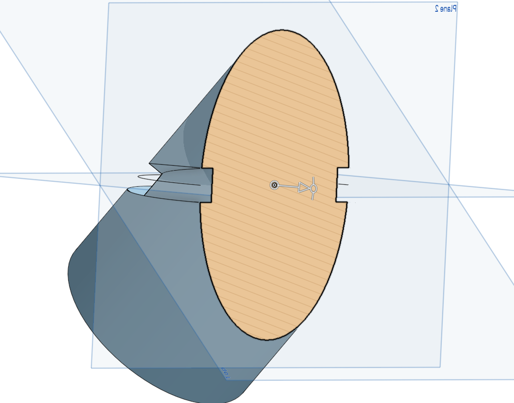

If I am following your design intent, I think this method gets there.
https://cad.onshape.com/documents/a7d16049bf0952557f32b42f/w/05580a6f0e4926953456a2bd/e/565dc27390643495b62e8192?renderMode=0&uiState=6a0b3708524d70d07f2f620d
