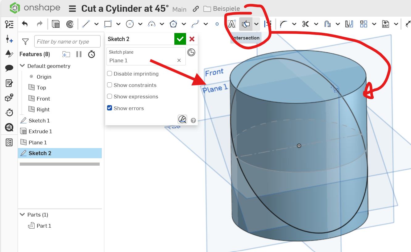

How do I construct a plane at 45° to the axis of a cylinder?
I managed to create a radial plane half way up the cylinder, but cannot find a means to tilt it to 45°.

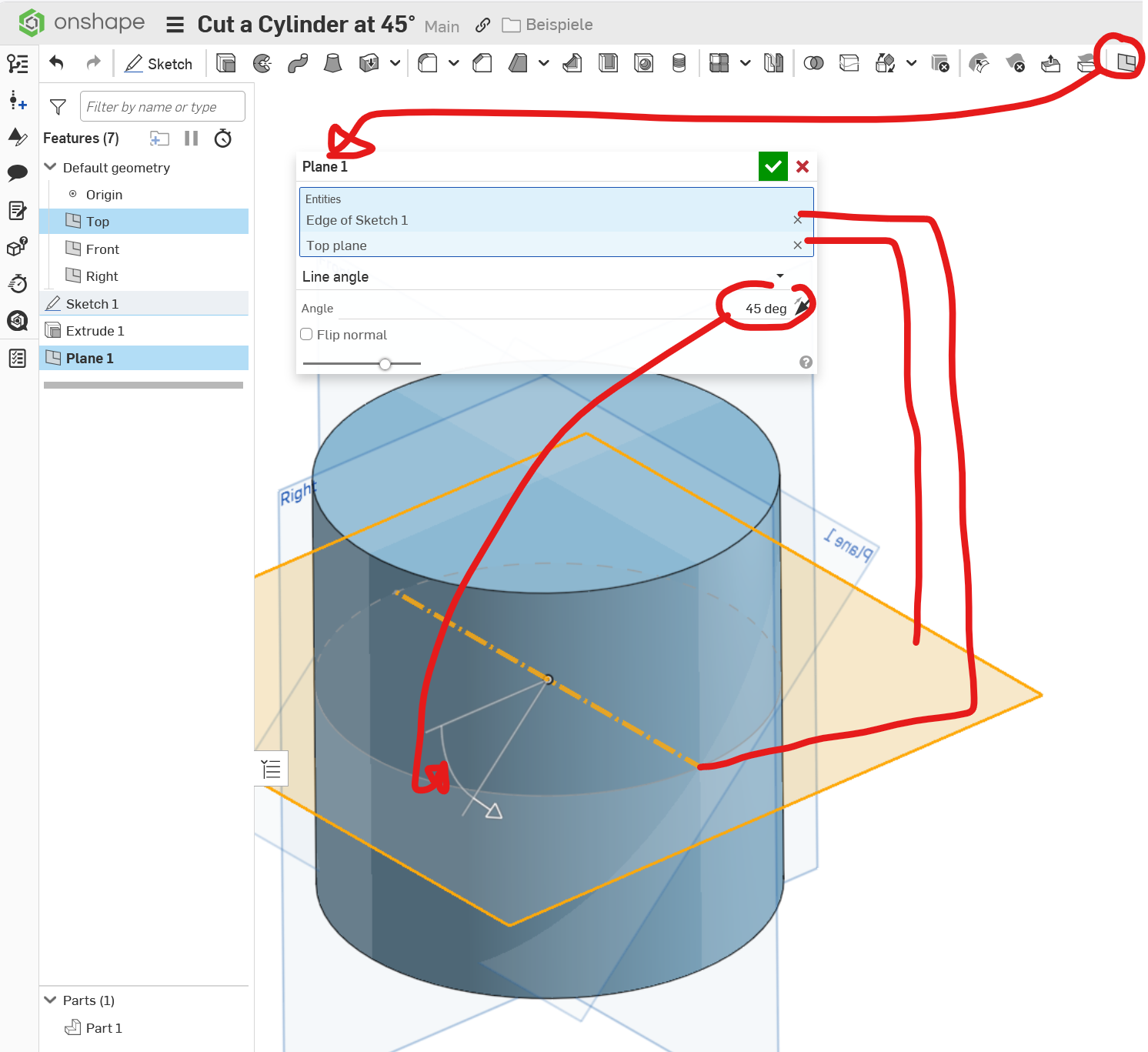

  • jim_zamecnikjim_zamecnik Member Posts: 75
    edited May 4
    Sketch a construction line perpendicular through the cylinder axis, then use the "line angle" option when creating your plane

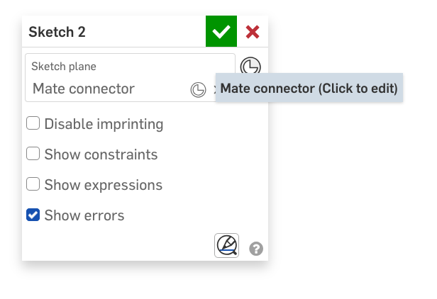

  • wille_jwille_j Member Posts: 61 ✭✭✭

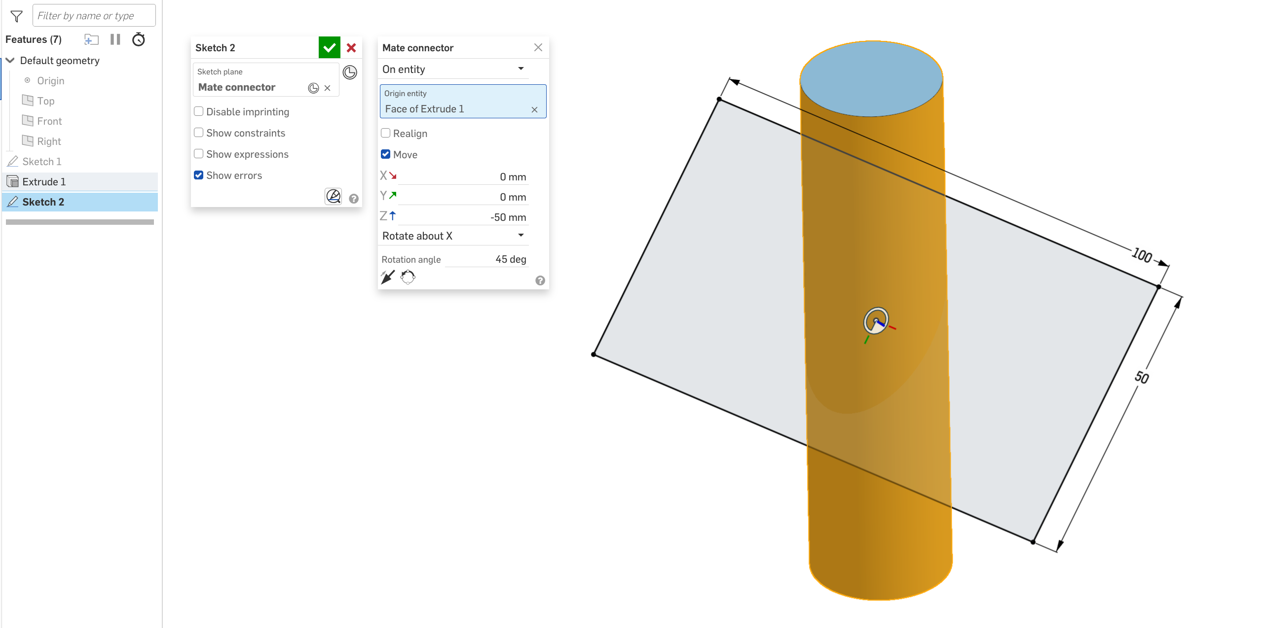

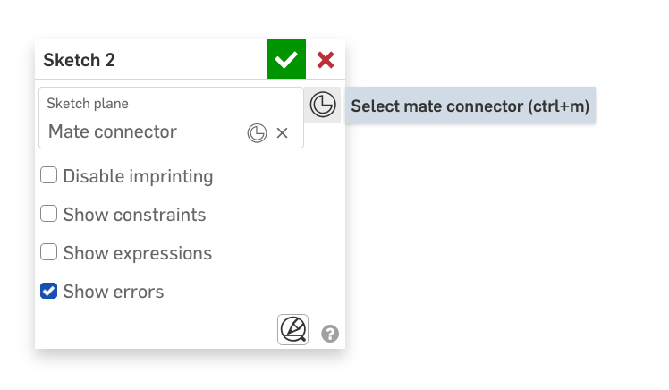

    The cleanest method is to use "Select mate connector" inside the sketch dialog. Then click any mate connector reference in 3D.
    Then click to edit on this smaller mate connector symbol.
    Which brings up the mate connector manipulator dialog where the mate connector can be moved and rotated around any axis, note that the axis is the local axis of the mate connector itself, not the global coordinate system.
    The XY-plane of the resulting mate connector becomes the sketch plane and you can sketch away as you wish normally.
    Here's the doc.
    All of this and more is explained in the video linked by @eric_pesty above, great watch!
    Sketch your line on your current sketch. Then use that line to create a "line angle plane" at 45⁰. Then you can create a new sketch on that plane.

    "The cleanest method is to use "Select mate connector" inside the sketch dialog."
    3days wait for TPTB to authorise my response to a response to my question that took 3 days to authorise; and then only to have to question the very first sentence of an elaborate response. (Thankyou BTW!)
    What sketch dialog?

    I want (need) to construct an ellipse on a plane at 45° through the centre (axially and radially) of the cylinder. That ellipse will define the "cutting path" for a groove on a barrel cam.
    So, is "the sketch" that original sketch? (Wouldn't modifying that screw up the extrade?)
    Or do I need to create an new sketch (where) in order to gain access to this mysteriously named "mate connector", in order to define a plane in order to create the sketch I need to construct my ellipse?

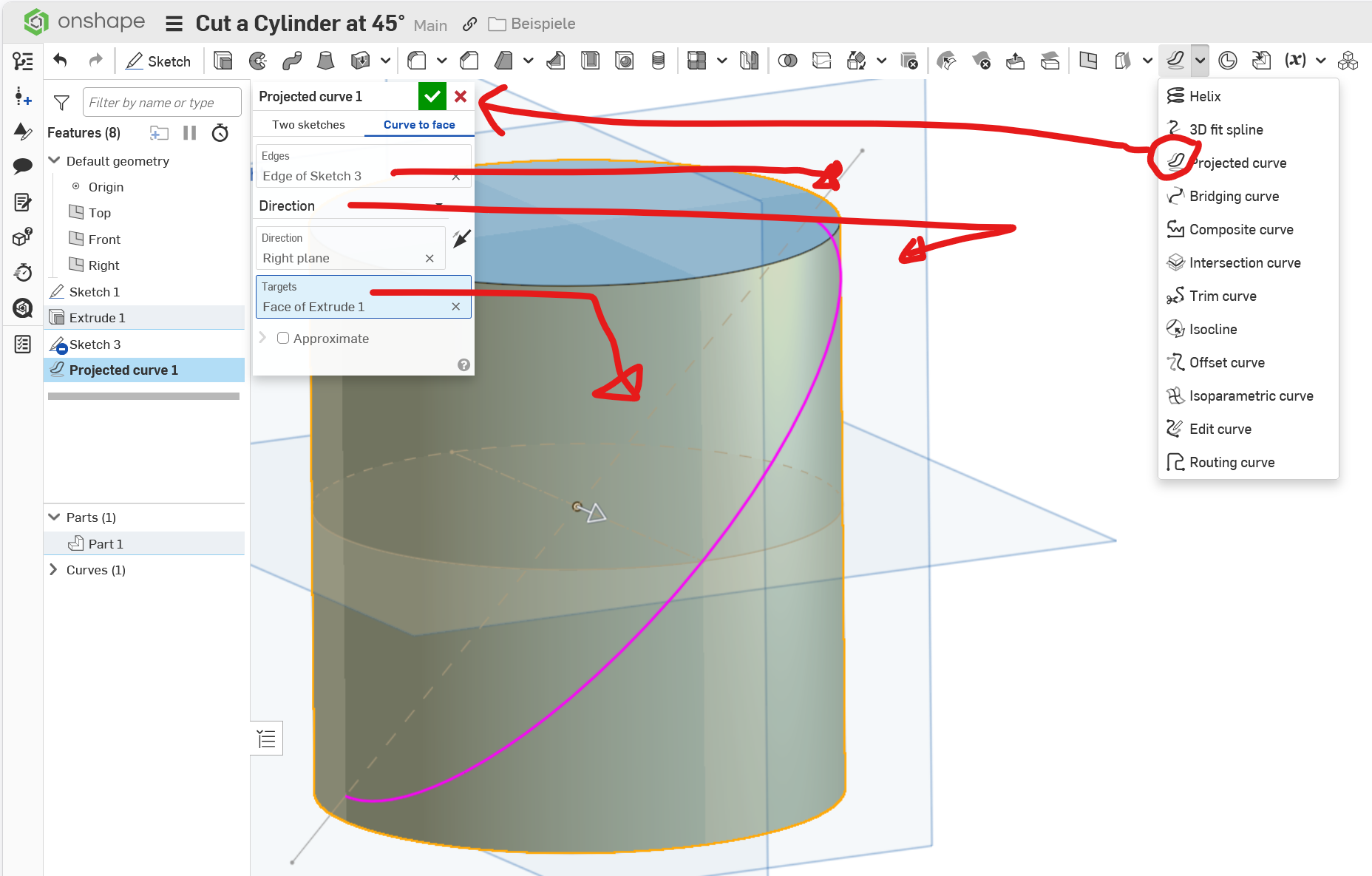

  • martin_kopplowmartin_kopplow Member Posts: 1,404 PRO
    @buk_browseruk Man, that is so basic, you really need to read the manual.
    There is a "plane angle" option in the plane tool, and there are curve types called "construction curves" that won't 'screw up' your extrude. Now, after you used that, you only need to:
    A - Use the split tool with the angled plane on your cylinder surface to 'cut' it, or
    B- Use the tilt plane as another sketch plane and apply the "intersect" feature with the cylinder sleeve surface to create the ellipse as a 3D curve.
    Or, if that fails, you could just
    C- Sketch up that line at 45° and project it rihght on the cylinder to get the 3D ellipse.
    Whatever serves you best.
    But please take the time to go through at least the basic lessons in the leraning section. They are really good and will save you a lot of time and geusswork.

    willy_j's method of abusing a connetor to proved missing fucntionality seems cleanest — no unwanted auxilliary sketch and unneeded line cluttering the feature tree.
  • _anton_anton Member, Onshape Employees Posts: 539 image
    edited May 13
    The mate connector route is meant precisely for this kind of use case. :P Plus, I place practically all my sketches on implicit mate connectors so that I don't have to maintain a separate feature or set of features constructing intermediate geometry. Makes navigating a complex Part Studio a whole lot easier.

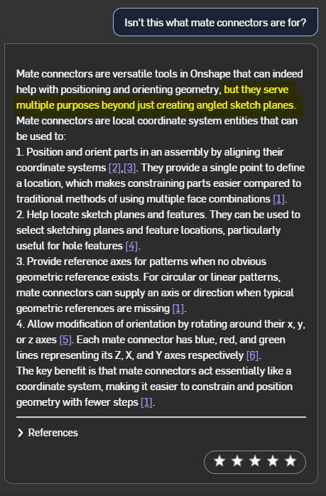

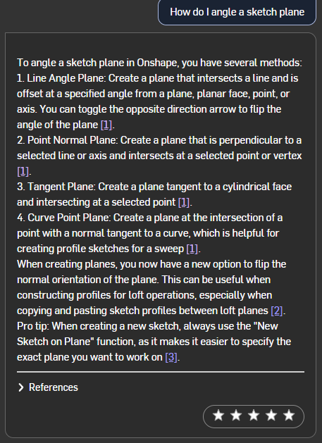

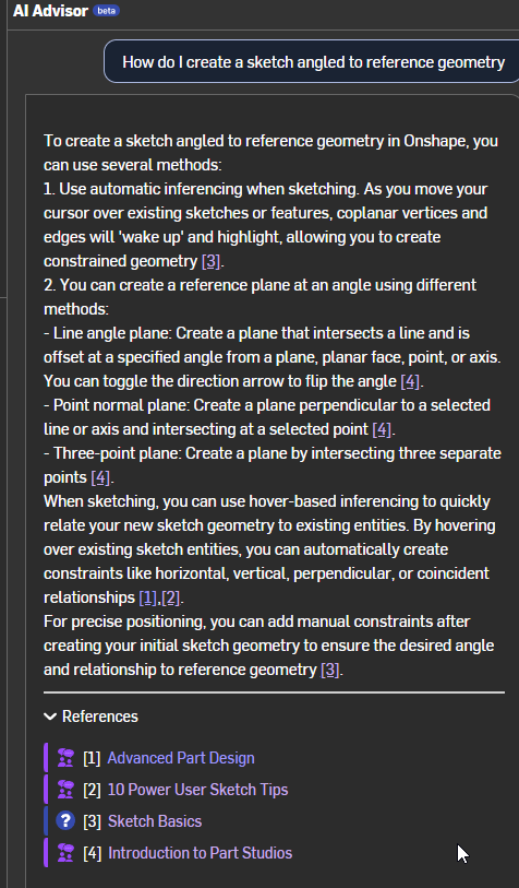

    There is also the "AI advisor", although it's very disappointing that it didn't suggest using a mate connector with the following prompts @_anton , who's in charge of collecting feedback on the advisor as this seems like a massive fail!
    Also, it seems to be hallucinating things that don't exist in Onshape, "New Sketch on Plane" function, really????
    And the absolute worst; I followed up with this and the answer made me want to scream:
    I was literally just asking about ways to angle sketches and they didn't get mentioned so it's a good thing I'm told that's not the only thing they are good for! I really hate how absolutely dumb AI can be sometimes (often)!
