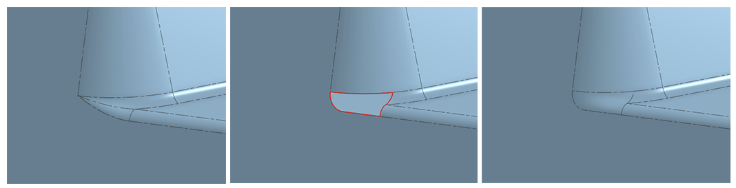

I've been using SolidWorks a lot lately (not by choice) and one of the features I found that is nice is the Tangent option in the Filled Surface feature for when you're filling in patches in places where fillets leave sharp pinch points.
Now, while the native Onshape Fill already does this, it's a PITA having to click on each dropdown to select Tangent. So here it is, folks. That's all this does. It defaults every edge continuity to tangent. I did throw in a select Open Loop edges option for the extra lazy folks like me.
On the off chance that no else has built this yet, just look at how many clicks I've saved you! In the example below, using regular Fill, it takes 12 clicks, while Tangent Fill needs only 1 click. I just gave you 15 seconds of your life back. Or else, let me know if this already exists, so I can delete this post (or the equivalent of that) and I can forget about this script I hastily put together.

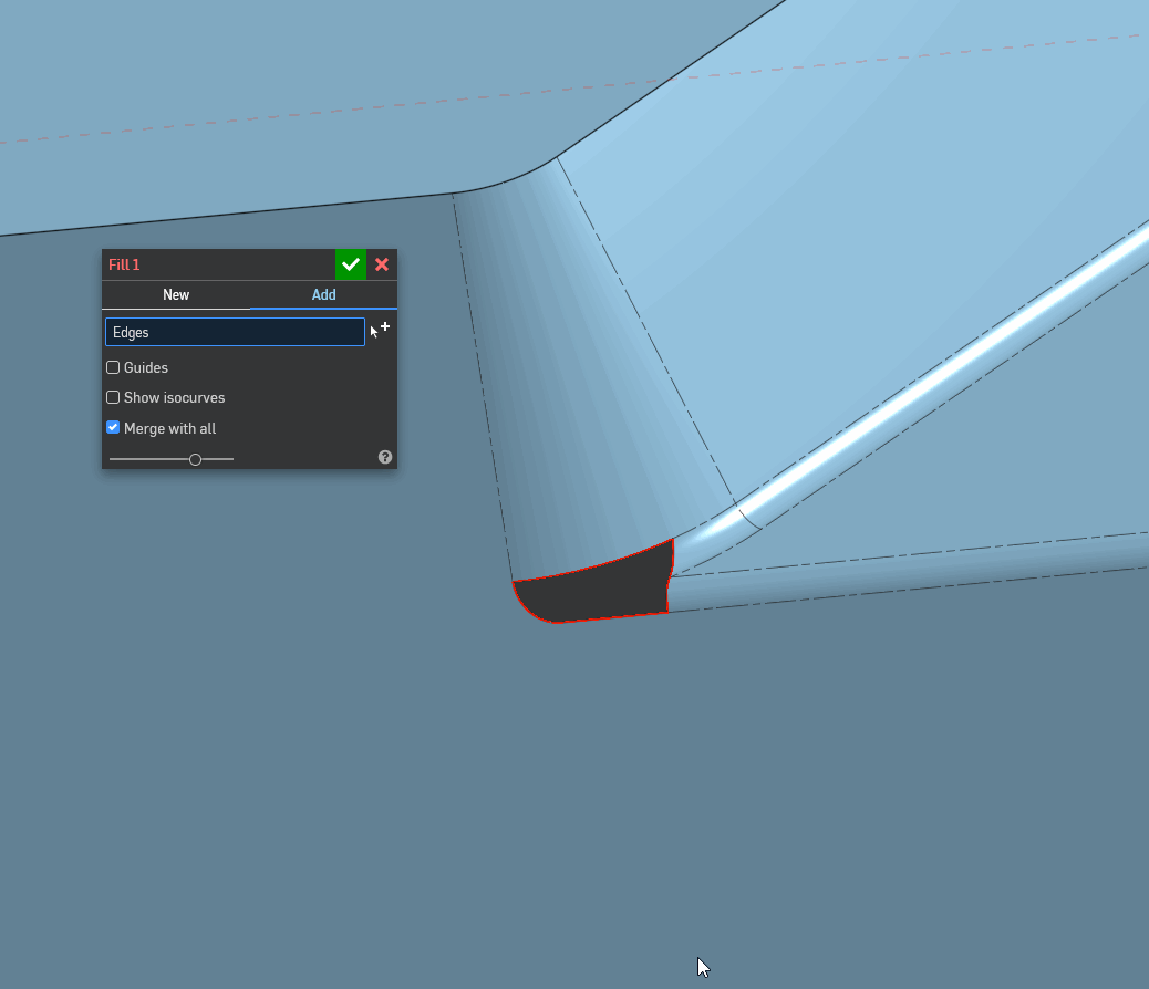

    If, after you make the first selection in Fill, you set the continuity to Tangent, all subsequent selections will also be tangent. This does not work with create selection though, so very useful and cool feature!

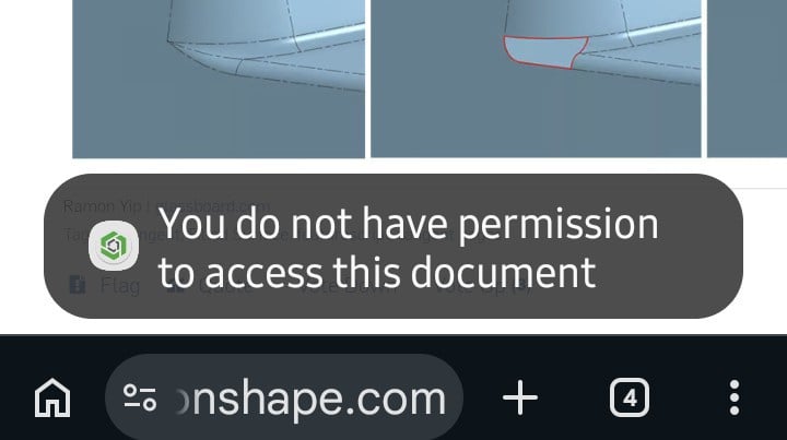

    That's odd. I made it public before posting. Try again now.
    Another thing is you can't access FeatureScript tabs while on mobile.

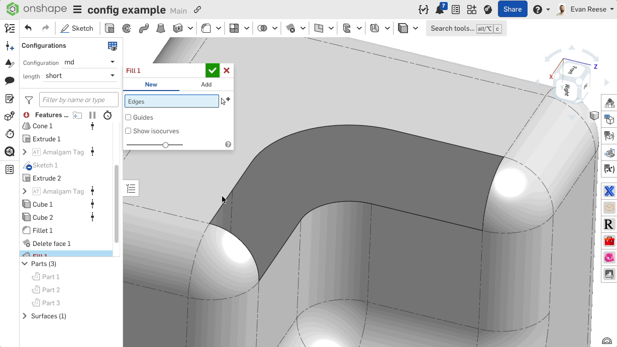

    Thanks for sharing the feature! Your feature isn't exactly the same as mine, and fills a somewhat different need, but I wrote a feature called Cap Surface, that kind does this, but for all open holes in a part at once, which doesn't offer as much control as yours. Mine gives continuity options, but it applies to all edges at once.
    It works with create selection as long as you made the first one and set it to tangent first, and make sure you're not trying to select "adjacent faces" with create selection.

    You know, I have Cap Surface added, but I've mainly been using it as its Rhino counterpart (cap planar faces), but thanks for the reminder. Cap Surface would condense patching all of the holes into one feature if you had multiple holes, which is awesome.
    Regarding the selection order, huh, that's interesting. I probably wouldn't have written this if I knew the trick. You just have to click things in the right order.
    Also, weirdly, if you use the Create selection pop-up, then it resets your continuity selection.

    whaaa?! Now that's a new one for me. I guess I avoid the Create Selection window and didn't notice, but it turns out Neil and I are both right.
  • MDesign
    wow that is weird inconsistency…. button and right click do different things when the selection set is passed back to the feature. sounds like something the onshape team would want to know about.
