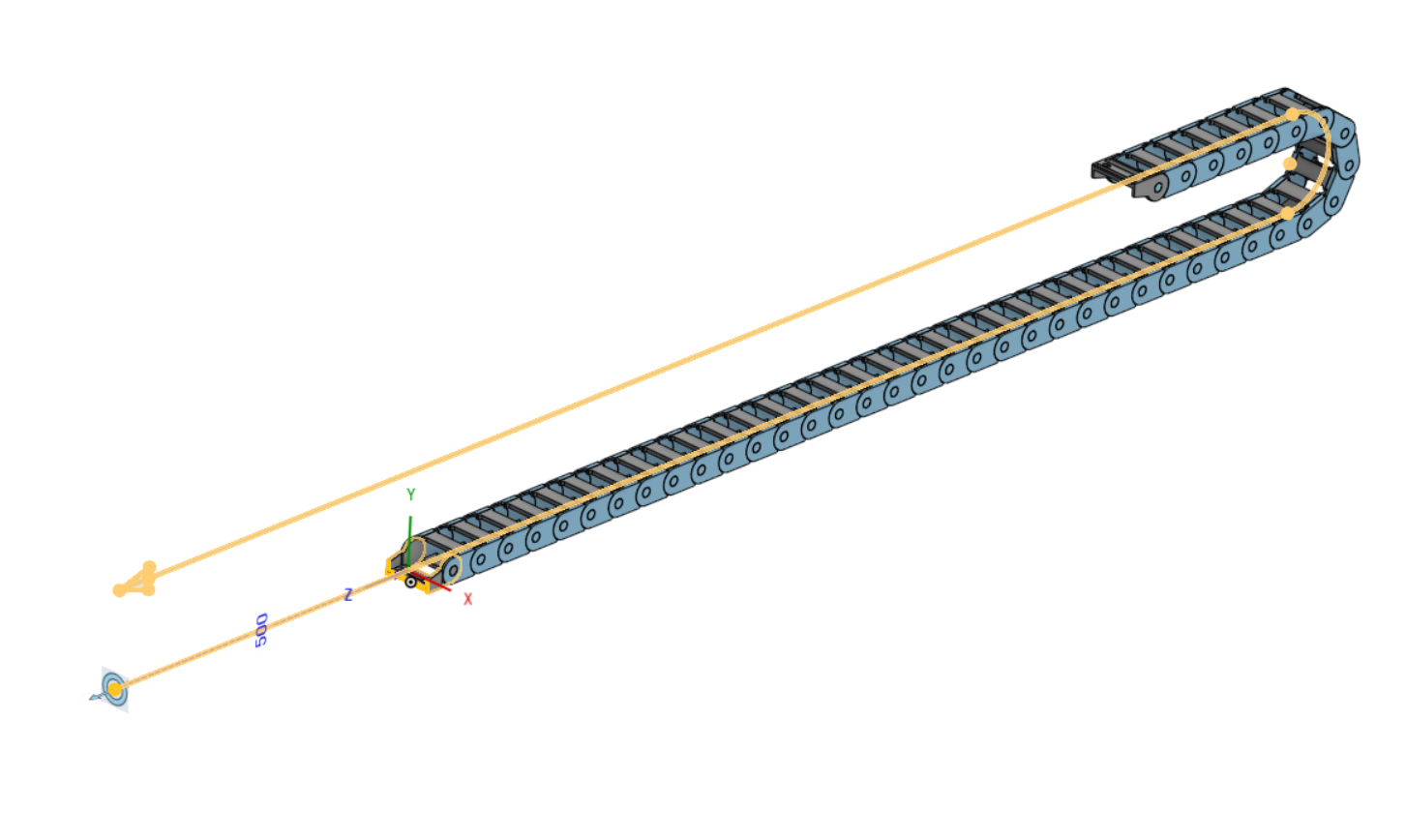

I have an assembly of a cable drag chain CNC Plasma | Cable Drag Chain X axis
I had a look at another post where they discussed how to enable the chain to move as it should Moving Energy Chain / Cable Track — Onshape, along with following the concept laid out in this document…Energy Chain | Energy Chain
In my assembly my model follows the path of the created surface, until it maxxes out on movement at about 825mm on the slider mate.
Could somebody please have a look at the assembly and help me understand why the drag chain is not following the surface path.
All the rotate mates seem to be correct, and so do the tangent mates, yet something is preventing the slide.
I also believe this is causing a problem in the main assembly….I can insert the cable chain assembly but im not able to align it or attach it to anything without it faulting.
CNC Plasma | Concept 2.0

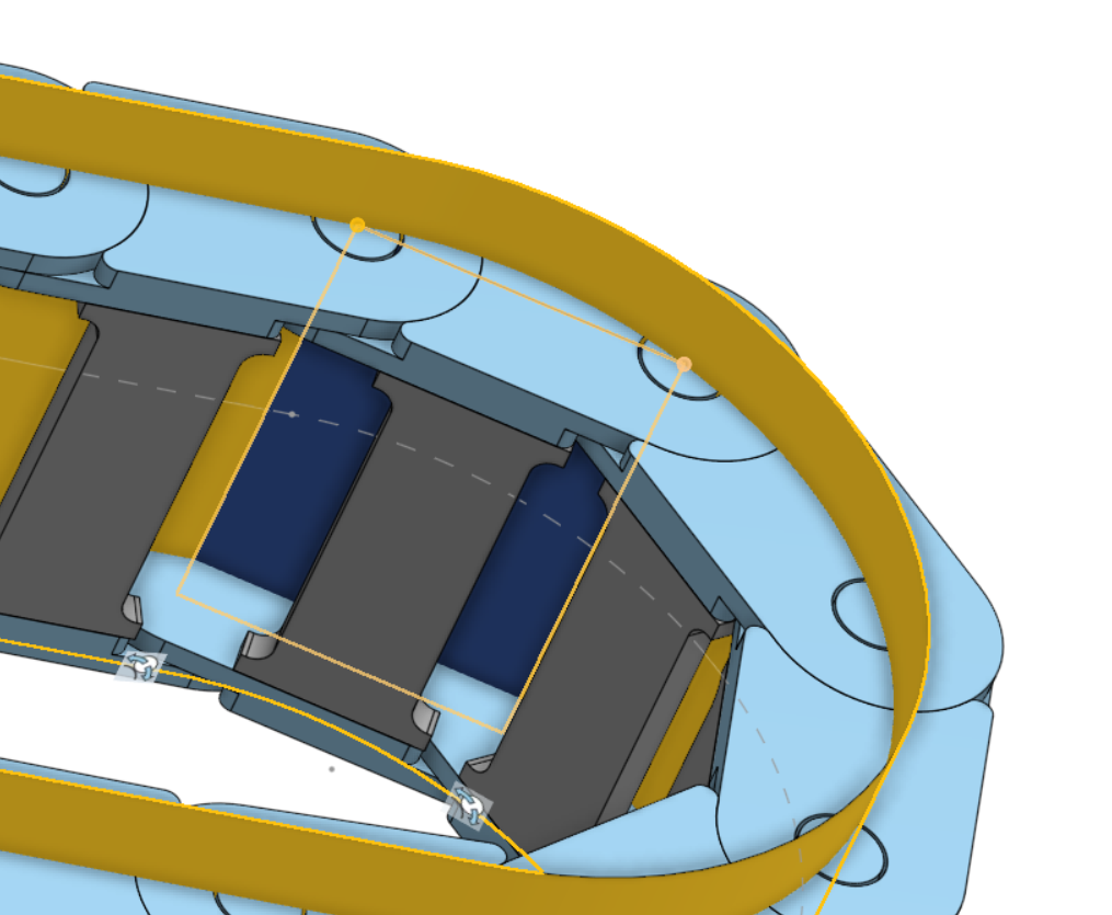

    I added a surface to the link assembly, tried to tangent mate the link surface to the path surface, but that method allows the tangent to go beyond the actual surface as long as the extension of the surfaces still tangents.

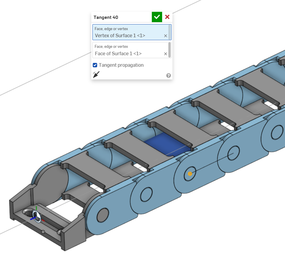

    So I tried tangent mating the vertex of the link surface to the face of the path surface, and that seems to be a more reliable mate, as it can't get locked trying to move one way instead of the other.

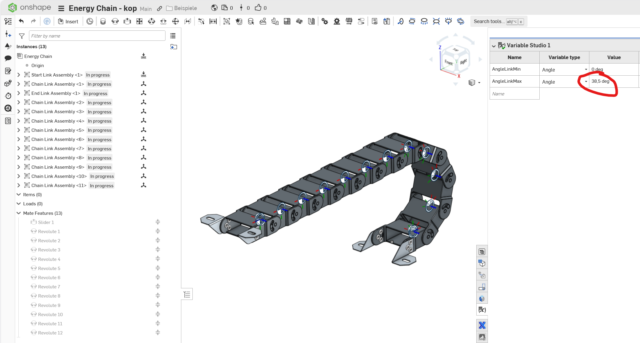

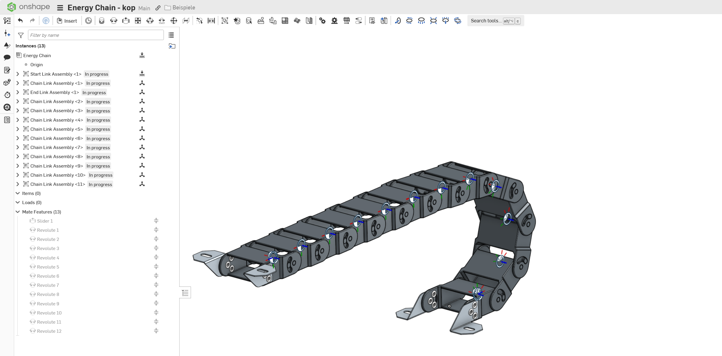

    I'm not sure what everybody expects from an energy chain. If we just model those conditions it has, the thing moves as chains do and behaves as expected, running pretty smooth for me.
    https://cad.onshape.com/documents/67fd4b93c70ca60f6a3b003a/w/8a36287dc8b351903f517cba/e/81fa9942f4b32a00f48e7d58?renderMode=0&rightPanel=variableTablePanel&uiState=6a1ab0d1dfcd8f502b38afbc
    Video (realtime):
    https://nextcloud.webo.hosting/s/xd4DZRZ82KYGdpD
    The free end will always have more distance from the fixed end than 2x minimum bend radius, so there'll always be a little wiggle in the chain loop, but that's just typical for chains.
    If we want to introduce a lot of conditions to make it act as if it was under the influence of gravity, that's a whole different story, though. But OS has no gravity simulation built in, so we end up with a really complex set of conditions and slow solving. If I have to model energy chains, I usually go the simple way and just let the chains be chains, instead of making them move like they never do but in an idealized sales video. ;0)
    (Edit: I made the max angle between links a varibale. It is 40° by design, but setting the variable to someting just below the point where it hangs (38.5°), helps to take out most of the wiggle:)

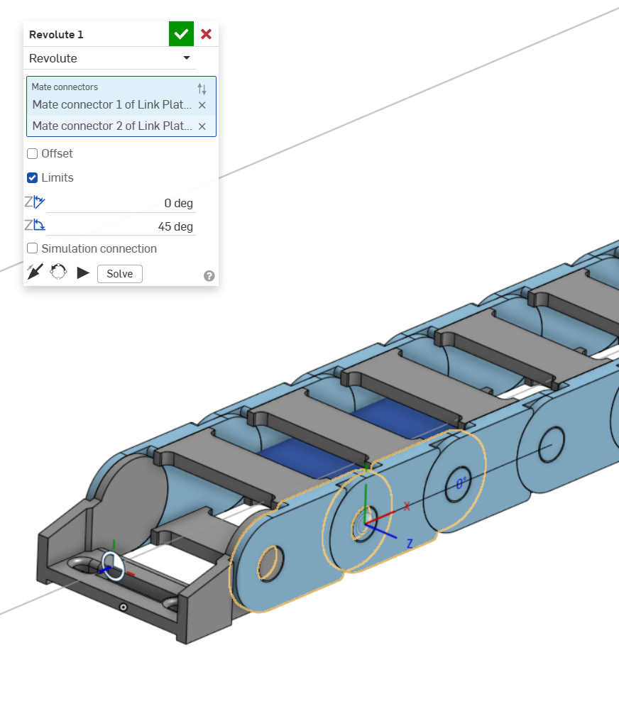

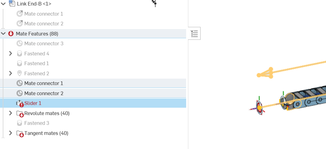

    I have 40 revolute mates, and 40 tangent mates…all trying to recalculate a new position on every movement.
    Is it possible there are too many mates in the assembly for the system to compute dynamically (hence impossible to drag), and probably right on the limit for it to compute with the provided variable (hence the time it takes to move after entering the new variable).
    I can move the chain along the path using the variable value on the slider mate, but only if I make small increments of maybe 25mm each time (however the change is extremely slow). If I make a change too great the mates become over constrained. For example if I change the slider length from 650mm to 100mm in a single move it will fault, but if i make small 25mm increments from 650-100mm it will be fine.
    If I try to drag the path sketch nothing will happen at all.

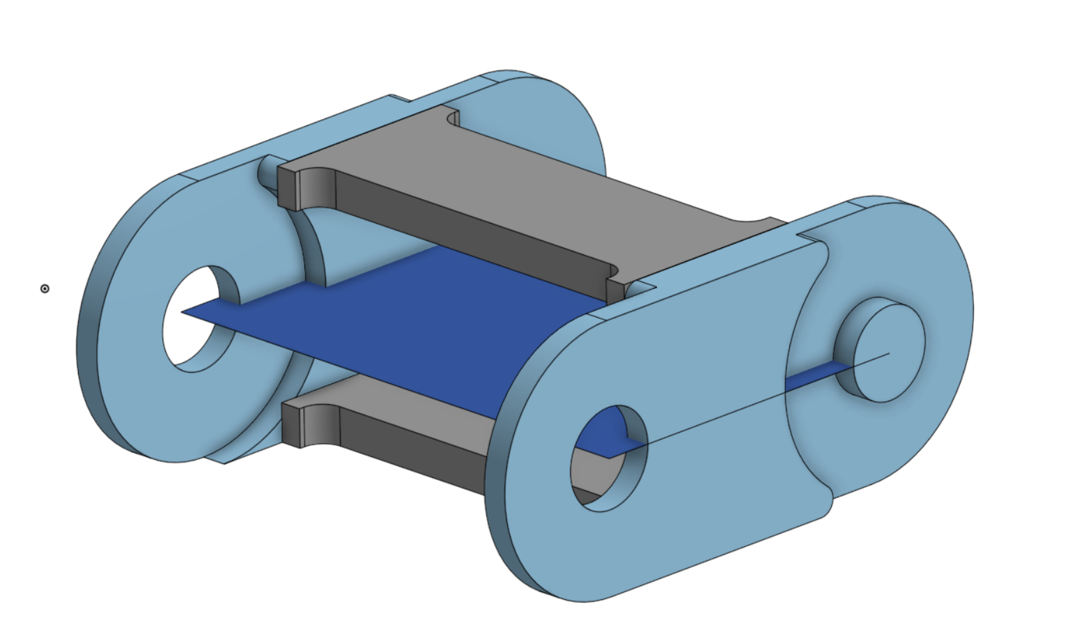

    In document 1 I have modelled the chain link and the chain ends (A and B).
    Each chain link is made of 4 individual parts, and combined in an assembly.
    https://cad.onshape.com/documents/fe88b93161d123511a04d621/w/45c9eb5be90db7384713f0fd/e/a24e88528bcd26b26540e673
    https://cad.onshape.com/documents/fe88b93161d123511a04d621/w/45c9eb5be90db7384713f0fd/e/abb90b6a05d3d9f6107b6d90
    https://cad.onshape.com/documents/fe88b93161d123511a04d621/w/45c9eb5be90db7384713f0fd/e/9e724aca900aebf80183a328
    In document 2, I have a part studio with the path…made from a 3d fit spline extruded to a surface.
    https://cad.onshape.com/documents/9fcd0c80829f11bb770a03ae/w/5d3ce76f78241bd88e22f475/e/9ac5e191c8a19ae1a5809f31
    Also in document 2 I have an assembly that references 1xchain end A, 41xchain links and 1xchain end B.
    This assembly also references the path sketch and surface.

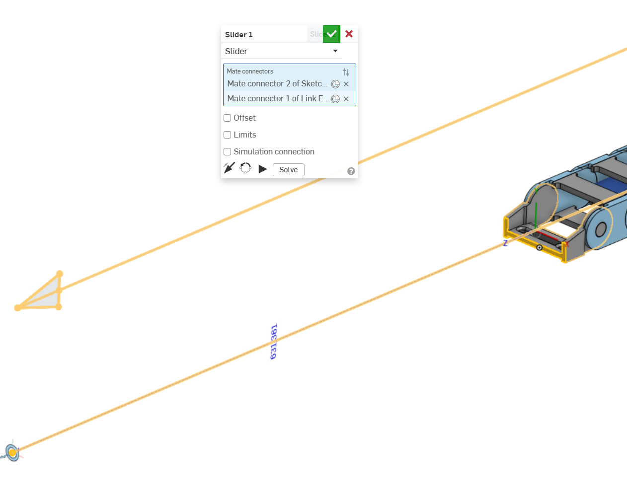

    The chain end A mated to the path sketch with a slider…without any limits:

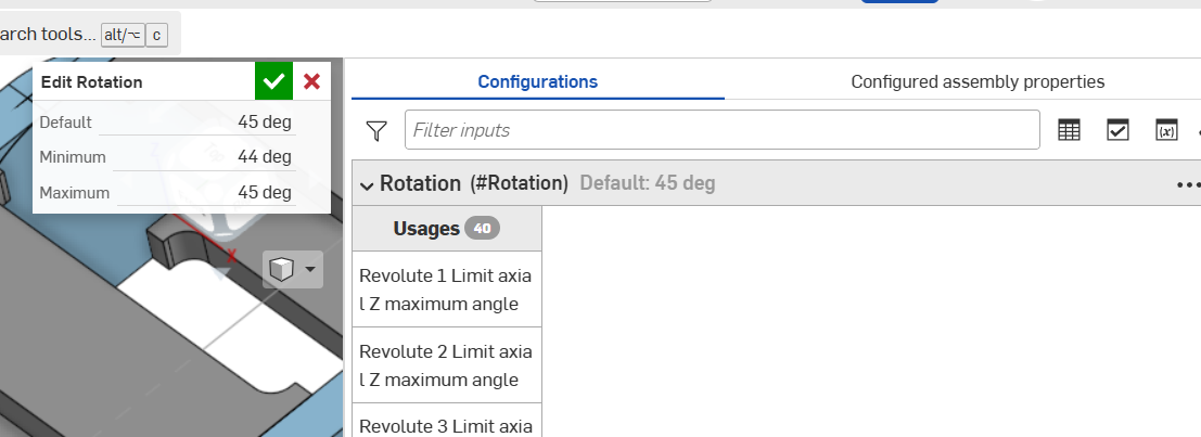

    Each chain end and link is mated with revolute mates…with minimum 0° and max 45°, which is more than required to get around the bend radius of the path. I've done this as a configuration instead of a variable so I can change it once and have it update to all instances. A variable would make me have to update every instance.
    Then each link is mated with a tangent from the vertex of a surface within the chain link assembly, to the path surface.
    Using the vertex instead of using the cylinder surface means the system calculation doesn't get confused and bound up.
