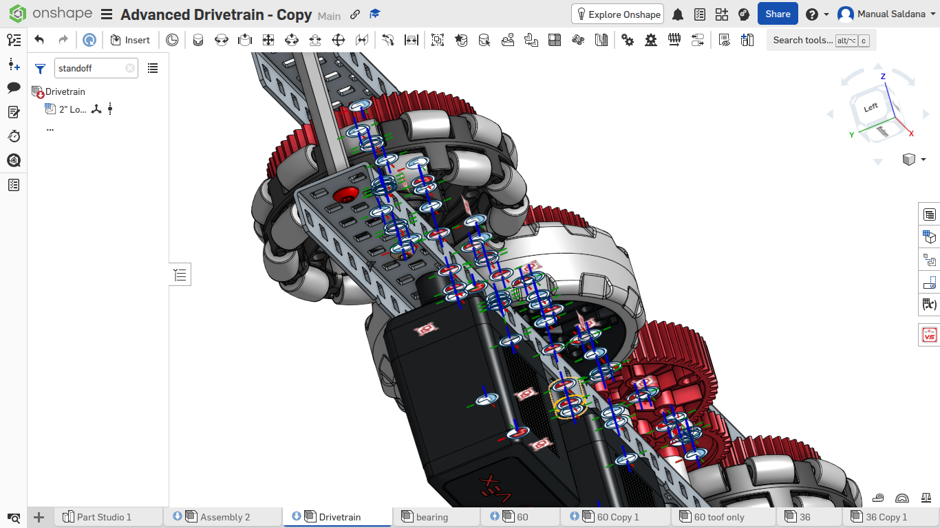

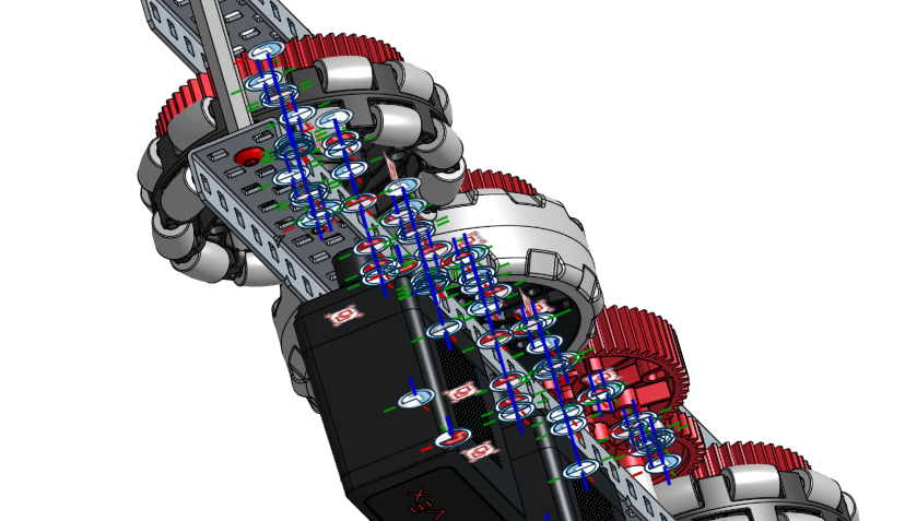

How do I get rid of these annoying red and white lines
i am using Onshape for VEX Robotics. I am new to this program. I don't know how to get rid of these lines can someone please help me out. look at the image

    NeilCooke Moderator, Onshape Employees Posts: 6,123 image
    J and K keyboard shortcuts
  • Matt_Shields
    Matt_Shields Member, Onshape Employees Posts: 1,000 PRO
    K will turn off the mate connectors
    J will hide the mates
    And not mating parts in the same group will save you some red.
