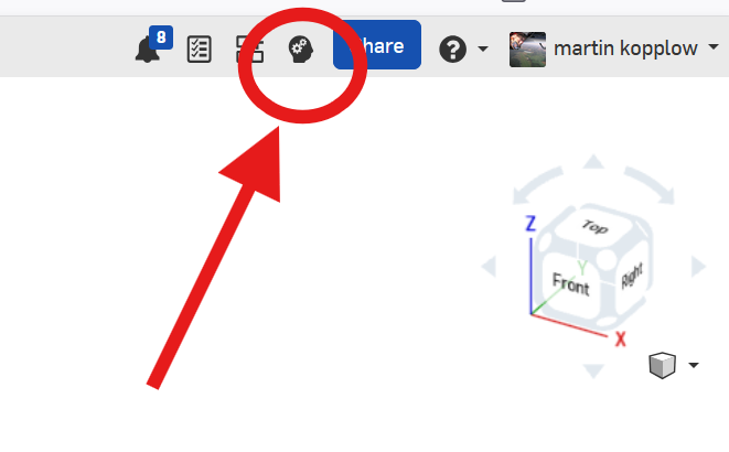

    martin_kopplow Member Posts: 1,643 PRO
    The best place is the learning center found behind the gearhead icon in the top right corner of the onshape window.
