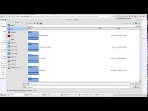

    Here's a video showing me doing a couple manual cycles of exactly what I want to automate, and at the end I flick through the other workspaces in this document, I would need to do 40 of these iterations per workspace, and there are another 9 workspaces in another document requiring the same treatment.
    https://youtu.be/7dfQ-JR87xE
