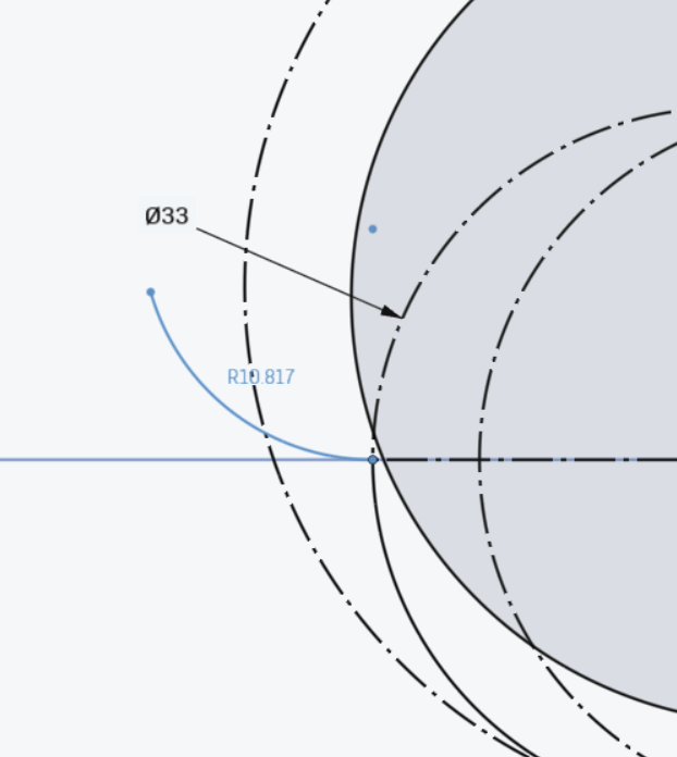

    I'm sorry, but I completely don't understand. I have contraption like this:
    And I want the tangent line to be tangent to the non-construction line below. For some reason when the horizontal construction line exists, OnShape only wants the tangent to be tangent of it. If I remove it, it forces the line to be tangent of the construction curve above the point.
    How do I make it so that tangent line is tangent to the non-construction line below the point?
    I tried pre-selecting the line - didn't help, after clicking "tangent line" selection disappears and OnShape does the usual. I tried selecting the line after choosing the "tangent line" tool - nope, creates line segment that is essentially the same radius as my non construction line.
    How do I do that? I thought there should be like button or something that would change the tangent target, or popup like with e.g. extrude tool or mirror tool.
