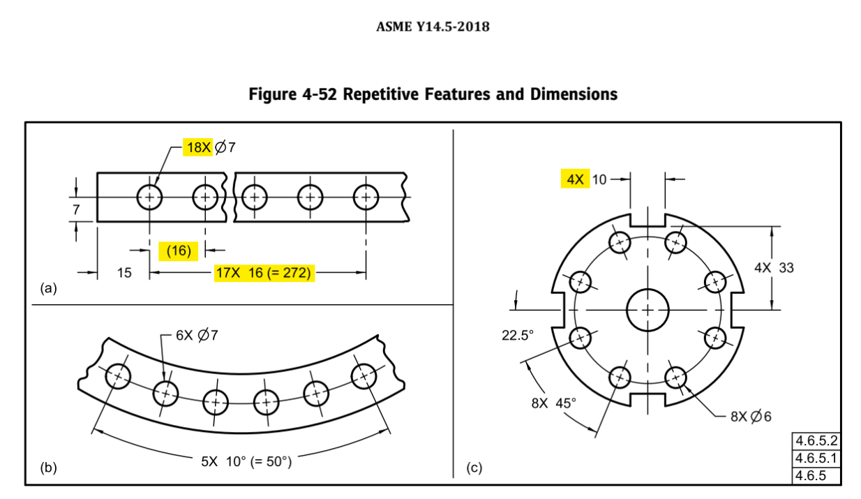

where can I find the setting of quantity holes?

    You will have to count manually and enter it into the hole dialog box while placing your hole callout

    Automatic hole count doesn't exist yet

  • 3Dsculptor3Dsculptor Member Posts: 2
    Is this thing really still missing? I tried to find also a way to show hole instance count in the callout but could not find a setting for that…
    Should be quite elementary to have it for hole callouts.

    @3Dsculptor :
    when you use the hole callout table, the quantity is added automatically. That would be recommended.
    for a particular hole call-out the arrow suggests you mean that particular one, so counting automatically would add unlogical numbers there…

  • odyody Member Posts: 4
    "[…] counting automatically would add unlogical numbers there…"
    Displaying count for repetitive features is well documented in ASME Y14.5 and widely used.
    It's more confusing if the count is not displayed, or worse, if the edit is done manually—-current workaround—and then goes out of sync with model changes.
    How come this is not yet available?
  • jelte_steur_infojelte_steur_info Member Posts: 653 PRO
    ah I see. the current table just counts all holes with the same spec. in this case the hole count would be dependent on a pattern-feature?
