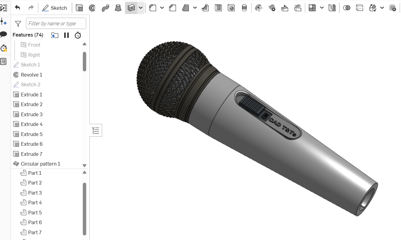

  • mikaia_val_cad2tsmikaia_val_cad2ts Member Posts: 1 EDU
    edited August 28
    Do you need something like this right? It's possible and challenging and really takes time to compute the curvy grid.
