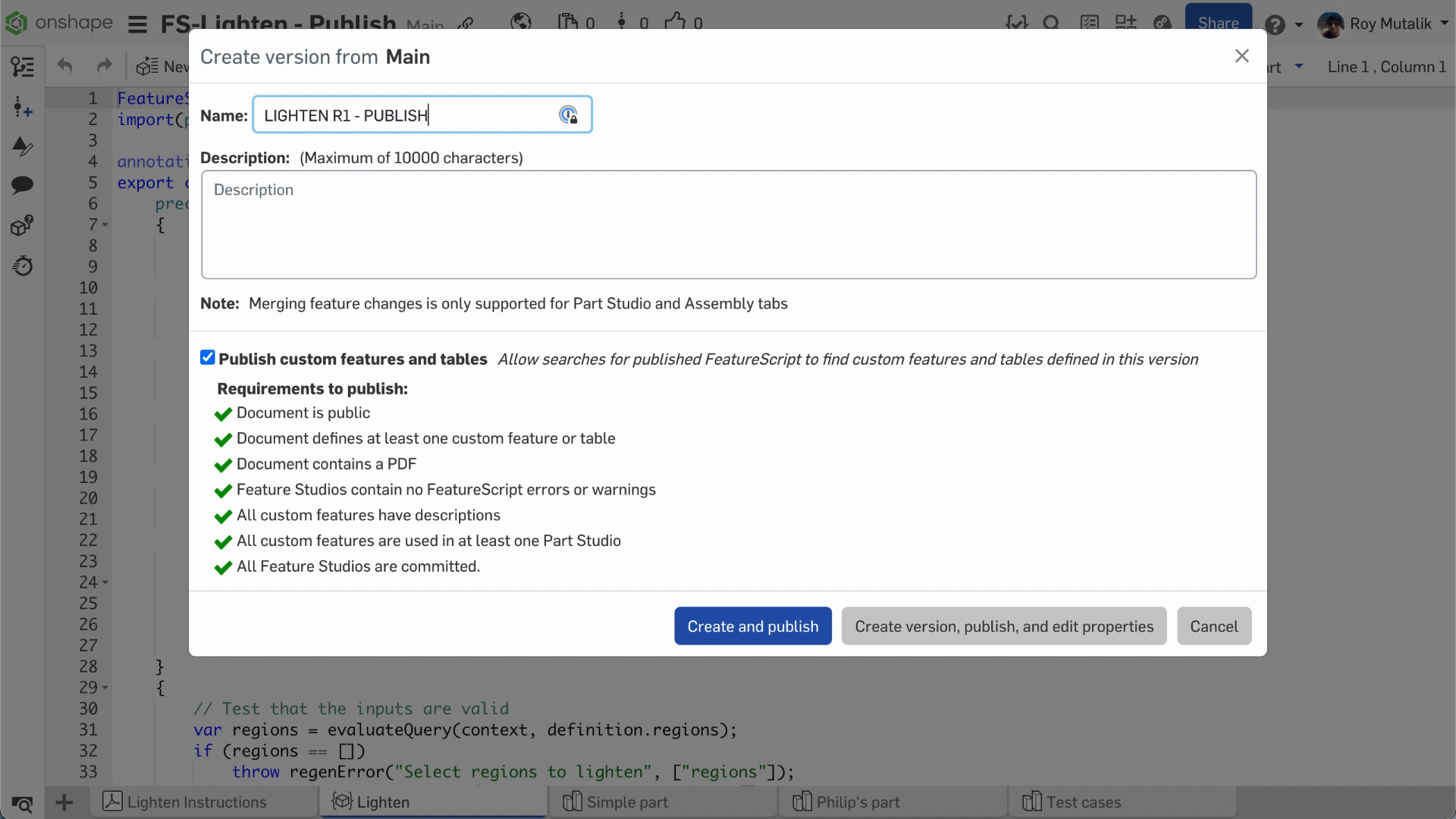

    You might want to look at the "official" publishing recommendations for custom features.
    https://forum.onshape.com/discussion/22767/please-publish-your-high-quality-custom-features
