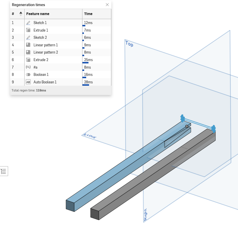

    I like well named part/feature lists too... So  I wrote: this https://cad.onshape.com/documents/8430fb350d753c30baca955d/v/5bc0f2a19e99306ee9eeb469/e/52f10ff9b8c867fd527f6483
    The Auto rename custom feature allows you to select the body-creating feature(s) and assign a base name. Benefit is when the body-creating feature(s) are edited e.g. number of items in a pattern, then the naming keeps up to date.
