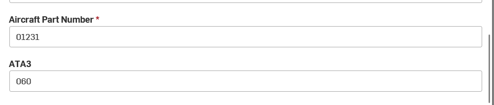

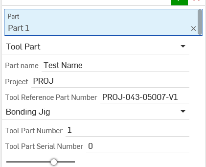

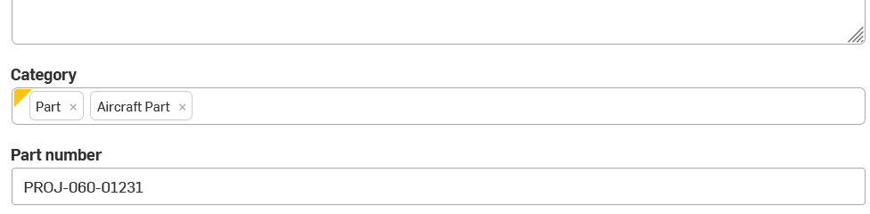

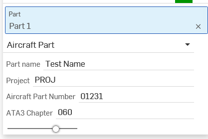

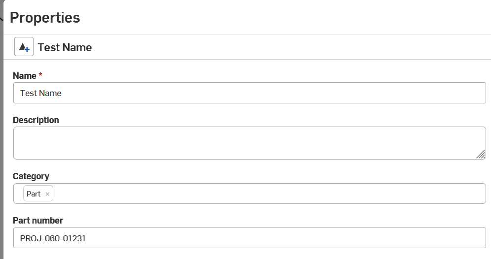

  • lennart_miene143lennart_miene143 Member Posts: 2 PRO
    Hi @MichaelPascoe, is there also a possiblity to set the system property "Category"? I activated "multivalue" for Category and created some own categories to organize the visibility of the properties.
    I tried it with custom Property and its ID but it did not work.
  • MichaelPascoeMichaelPascoe Member Posts: 2,500 PRO
    @lennart_miene143 not that I'm aware of. This could be a special property that can only be set by the system. Depending on your use case, there may be another way to achieve what you want. What is your end goal?
    @MichaelPascoe I created 4 categories with different properties to show up in the properties of a part. If I always showed all of them at once it would be a mess. Furthermore, I created a custom feature to assign a correct part number to a selected part based on its category and on the input fields that show up in the feature dialog.
    Here is one example: Fill out all the inputs and the properties of the part will have the same values as well as a part number that is calculated out of these inputs:
    Here is another example with further custom properties:
    As we use so many custom properties its quite a mess in the property dialog. So I hid them all and you can only see them when you choose the corresponding category:
    In a part studio I usually trust my custom feature so I think the properties are correct. In an assembly, to be able to look up the correct properties I have to open the properties of a part and always try to select the proper category to show the corresponding custom properties.
    I thought I could avoid this by automatically selecting the correct category and only showing the necessary custom properties. But I don't make a big deal about it since I'm already very happy about the custom feature and the automatic part number.
