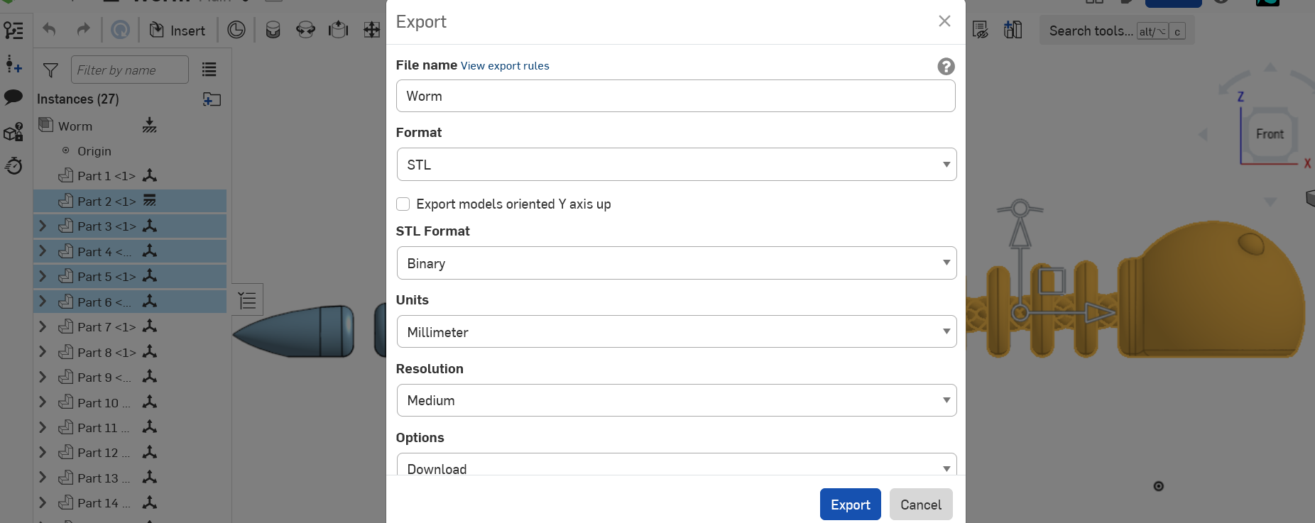

I inserted the worm body into the assembly, and fixed the head. However, each of the segments is now independent and can move, which makes no sense. I can only have one part fixed, so I can't fix any of the other parts. How can I force it to keep the spacing relationship of the original part studio object?
So I put in a few connectors. I create a solid connection (fasten) between the mate connector on the connector and the mate connector on the worm segment. After I put in four, which was incredibly tedious, I decided I had enough to test print. So I selected the head and the first four segments (using a selection box, so all the connectors were also selected) and did a right-click export.
I got a zip file downloaded, and it seems to have only one instance of front connector and one instance of rear connector, in spite of the fact that I have four instances of each in the assembly.
I open these files in Prusa Slicer 2.9.2 (the latest version), and it tells me that it has detected a bunch of parts, and did I want them treated as a single object? I say yes, and get what is shown in the screen shot. Two connectors, apparently in a random place.
So how to I fix all of these problems? The parts all have degrees of freedom in the assembly, even though they are constrained the part studio, I don't get all my connectors, and the only two that show up are randomly placed.

  • MDesignMDesign Member Posts: 1,339 PRO
    Turn off export parts as unique parts when you export the STL
  • joseph_newcomerjoseph_newcomer Member Posts: 101 ✭✭✭
    I don't see an option to export parts as unique parts or not
    I also tried by selecting just the parts I wanted to print, right-click export on the selection, or going over to the parts list on the left and doing right-click export. No option for a single STL is presented, although the help documentation clearly shows this option.
    @Matt_Shields
    It seems to be printing successfully. But I don't understand what you did.
    What device are you on? PC or tablet? It looks like you need to scroll down for more options. But have no scroll bar. I don't remember needing to scroll on PC.
