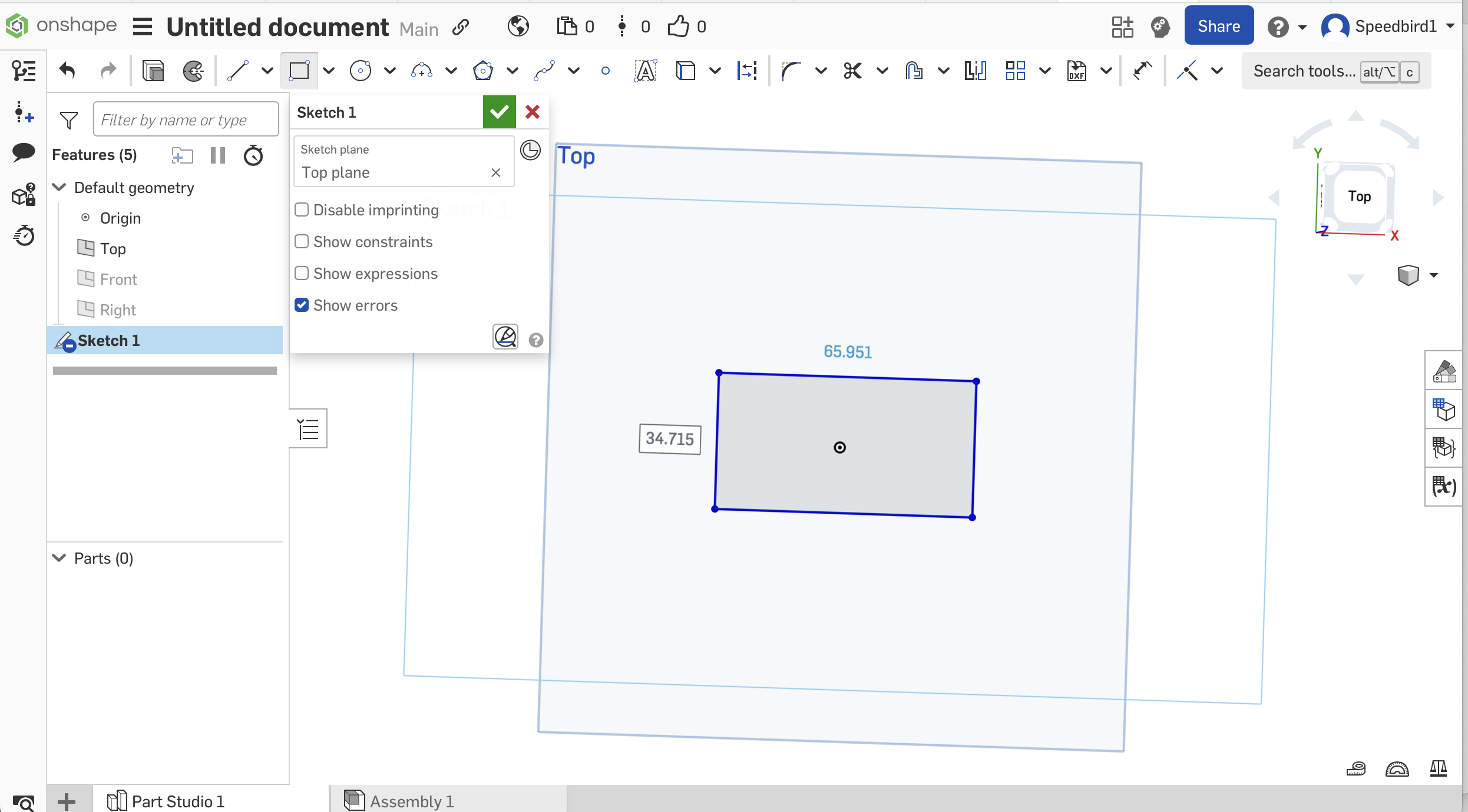

How can this not be defined?
Hello, all i've done so far is chose a plane to sketch, selected rectangle and drawn it. How can that simple shape not be defined? I have been using Onshape for a while but purely on a super low level without anything complicated, i've never seen this error message previously. What am I doing wrong?

    fully defined will immobilize the sketch from dragging it around. you can still modify it with dimensions or changing contraints
  • robert_scott_jr_robert_scott_jr_ Member Posts: 761 ✭✭✭
    Hey Michael. This is the Origin. - Scotty
    If your rectangle is not where you want it, draw it anywhere but make some point of the rectangle dimensioned in both X and Y to the Origin. - Scotty

    You're welcome, Michael. Glad you're able to move on. To continue, a requirement for a fully defined sketch is to have all sketch entities fixed/anchored in a specific X & Y place on its plane. But not all sketch entities have to be directly constrained to the origin. If you have any sketch entity (a point, a line, a circle, etc.) already constrained to the origin, any additional entities you create can be constrained (using constraints and/or dimensions) to that former entity thereby also 'fixing' that entity.
    Now that you have a fully defined rectangle, try drawing another sketch entity, such as a circle, and give it a dimension. Then dimension its center or the circle itself to the rectangle (in both X & Y) to make the circle turn black, fully defined. The circle is, what may be considered, indirectly constrained to the origin.

    Hit enter twice to actually accept the dimensions.

    Hey Michael. If you click and hold on a line of your rectangle and move your mouse around, you can move the rectangle around. This is why it is not fully defined. The rectangle has to be fixed someplace; it has to have a 'fixed' location. Since, as it is, there is nothing else in your sketch, the only point to reference the rectangle to is the origin but that's fine.
    Select any corner point and the origin and select the Coincident constraint or create dimensions from the rectangle to the origin. Everything in a sketch has to be 'fixed' either by constraints or dimensions. This doesn't mean you must always constrain a sketch entity to the origin. You can constrain a sketch entity to a previously created entity (a circle for example) but the place of reference on that that previously entity must be fully constrained for that to work.

    @Matt_Shields Thank you, I tried that but still no difference.
    @robert_scott_jr_ Thank you, but I can't seem to get that to work either.
    What the hell am I doing wrong?

    @Matt_Shields Correction that did work, b ut i can no longer move it around, is that correct?
  • michael_fitzpatrick053michael_fitzpatrick053 Member Posts: 44
    @robert_scott_jr_ When you use the word 'origin' does that mean the centre dot or where i started the rectangle from?
    I've tried both ways but still do not get it to Define.
    The only way it defines is when i start from the centre dot and hit enter twice. The issue then is, that is not where i want the rectangle to be but cannot move it.
    Has something changed recently or have I just not noticed?

    @robert_scott_jr_ Thank you Robert, that's sorted it. At long last!😀
