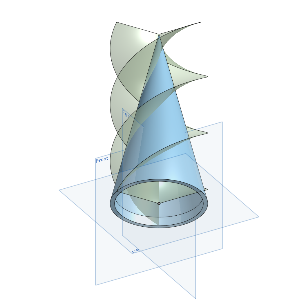

Hi there. I would like to create a hollow cone with a swirl.
So my idea was to split it into a few parts using a helix. It took a while to figure out how to turn the helix into a surface but now since that is done, the splitting is what's causing a headache.
Here is the cone and the helix surfaces

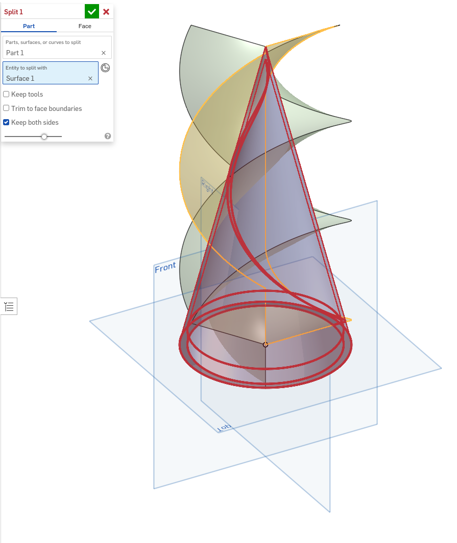

Now here is what happens when I try to split it. I haven't found a way to select all 3 surfaces at once for the splitting.

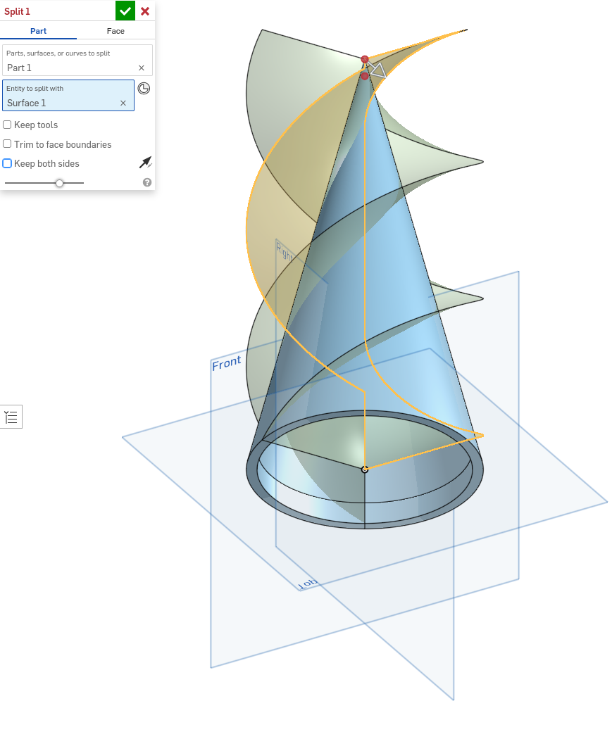

And if I disable "Keep both sides" I get this. Which seems to be better but still won't split at all.
I assume I'm just missing a minor detail, so any help is appreciated!

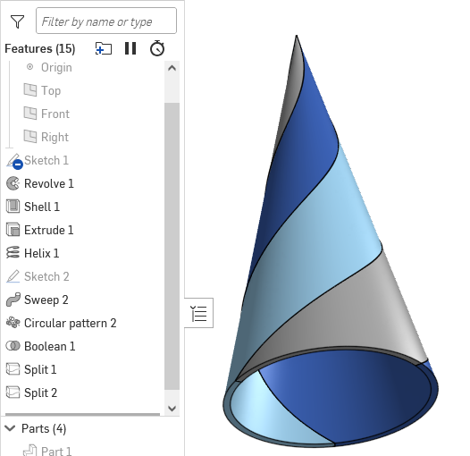

  • BrainStoneBrainStone Member Posts: 5
    Thank you. That worked!
    Had to use 0.01mm in both directions, else it refused to work, but that's fine

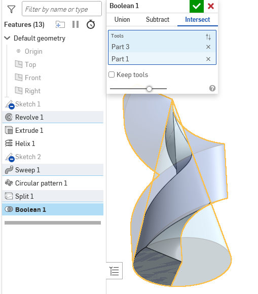

    None of the 3 helical surfaces pass completely through the cone so that it can be split. I'd suggest creating a solid sweep of 1/3 of the helical area and using boolean intersect to get 1/3 of the volume. from there you can pattern it or edit it as you need.
    Or depending on design intent maybe a similar method using splitting faces might be needed.

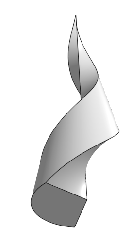

    add in an offset cone surface to use for a split of the boolean intersect.
