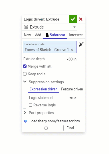

Can you configure the supression of the feature based on the configuration you are selecting?
That's the thing, my configuration contains only length input.
So, if length is less than 5mm I need to suppress a feature
Currently not possible
But being worked on.
@vanowm while your waiting on the official way to do it, this feature supports conditional suppression based on equations, configurations, other features, etc..
