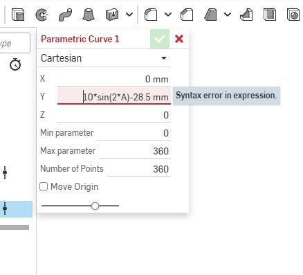

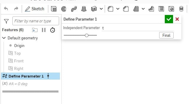

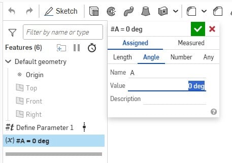

I'm trying to use the Parametric curve feature to draw a sine wave for Y= 10*sin(2*A)-28.5. Units are mm. A (angle) is from 0-360. So it should draw a sine wave that repeats twice over 360 degrees, starting at X0,Y-28.5. I have defined parameter #t and set variable #A as degrees (see screenshots below). I keep getting a syntax error in the Y definition? Could someone who knows this featurescript please let me know the exact steps to draw the curve, including what I should set the parameter #t, variable #A, and X Y Z expressions at in the Parametric Curve dialog box?

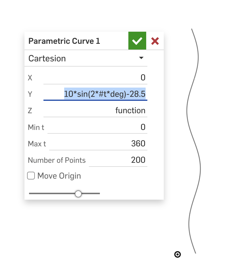

    You need to specify units for the sine function to work. Also you'll need to reference the parameter #t you defined… And finally provide a function for Z and/or X) - in the sample below I just used #t as that function.

    @GregBrown, I think you might be using a different version of Parametric Curve - the prompts in your box are subtly different to mine - which won't accept X as 0 (it says it needs to be a length), and your box has Min t and Max t where mine has Min parameter and Max parameter. Could you please drop the link to the up to date copy of Parametric curve that you are using?
  • Stuart_TodStuart_Tod Member Posts: 64 PRO
    @GregBrown : I found the latest version (V14) and it now works. Thank you for this….
