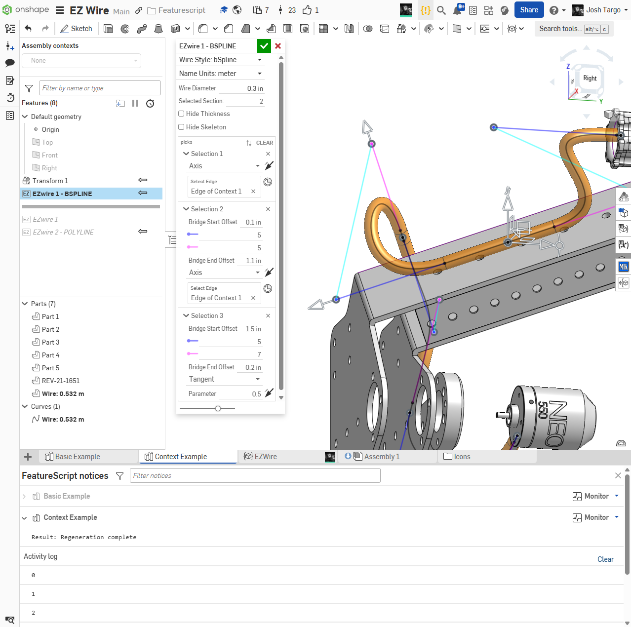

I'm still playing with the UI and logic rules, but basically it's a way to quickly route wire/pipe/cable when exact positioning isn't critical (like for our robots, when we need a basic path).
The example below shows a path that would require 7 points in RoutingCurve, but mine does it with just 3 MC positions.

    It is probably enough for many simple applications where we would just want to show that "There is a wire required!" and have it in the BOM. It relying on MCs could make it easy to handle.
    It gets serious hiccups, when I play with the MCs not being perpendicular to any of the basic planes, though …

    I updated it to use lines, arcs, and circles, rather than MCs because we will usually be working in Context.

    So the idea is to make it orient straight sections along existing edges and use existing arcs or their axis to place the bends in order to easily create a routing that has a meaningful relationship with the design? I know Neil's FS, but I find it grew too complicaed for the mere basics in wiring I usually do, so I see a valid use case for this appoach of yours during conceptual or prototype stages and in moving assembies.
    One important thing with wires I always run into is we need their length to order material for manufacturing, and we need to order that early (because of ridiculously long lead times). A good approximation would probably do. Could you (at some point) include that in the naming or some other part property that can show up in a BOM? I have added cable types to my custom material library before, so …

    @martin_kopplow I now have full triad manipulators for the wire points, but the manip is in global xyz. I need to figure out how to orient it aligned with the wire, and remap the transformation of the manipulator to each point's coordsys. could be working at some point, but this is by far my most complex FS, so it's taking some time.
  • joshtargojoshtargo Member Posts: 446 EDU
    edited August 27
    @martin_kopplow holy s*** I think I made it work with manipulators to drag wire sections around.
    EDIT: still some bugs, but almost there :(
    basic workflow:
    • select an edge or MC. (I think arbitrary curves don't work yet but arcs do).
    • a section of wire will be created from the edge
    • pick an end point of that section and drag it longer or shorter
    • pick the centerpoint of the section and move it axially, or normal to its orientation
    • pick another edge and a bspline or radius polyline will connect them
    https://cad.onshape.com/documents/6661cf93ab8de38ee21084ba/v/8ef5c1f9fb5814bcfaae8444/e/20535b592817c77c3d553d34

    Today; I tried it a bit. I have a simple vibration test rig that needs to be wired up.
    It took a while until I got the hang of the selection behaviour, it's a bit tricky, for it gets unresponsive when the wrong item is active in the edit box. Then, I had a hard time connecting the start point to my plugs. That is mainly because each reference point appears to be a two-directional mid point. It would be helpful, if the start and end point would only have one direction, while all the other references inbetween were two-directional.
    Then, it was difficult to get the wire run from one side of a part to the other, around the edge, see wiggle line in the picture. That is a situation where rotating the manipulator would be super helpful: Then, the wire could even be made to spiral around the edge.
    I did all this in-context. I found it interesting, that I needed to create the start mate connectors before using EZwire FS. With the edit box open, they would not activate the target geometry. After returning back to the assembly, only 4 of the 5 mate connectors would transfer, and all under the first wire. I have no clue why.

    I've completely rewritten it possibly 2-3 times since our last message and it keeps getting better. I haven't added in Manipulators yet to the new code, but could you take a look at the latest? Also look at my example in the context example studio.
    as for Mate connectors, it is not possible in featurescript to infer mate connectors in context (at least not more than 1) it is a huge pain, but unless a better coder tells me how to do it, it seems not possible. but using axis of a circle, arc, or line is a good way to have a similar effect, and those are built in to my new code.
    Also remember, this is supposed to be "EZwire", and so it may not have all of the features of Routing Curve
    https://cad.onshape.com/documents/6661cf93ab8de38ee21084ba/w/f5498f04cfe042af60e91d3f/e/20535b592817c77c3d553d34

    I just rebuilt the wiring from the test rig with it. Placing start and end references is now much easier. The follow option is nice, but it seems it'll always follow all the way? It would be very nice if the start and the end of the follow could be pushed back a bit, for example if the wire was to follow only half a circle, or half an edge.
    While playing around, I referenced the ends of wire 2, 3, 4 and 5 onto the end of wire 1 with a bit offset (offset=diameter). If I now readjust the end of wire 1, all the other wires will follow. Nice side effect. I guess that MCs as start and end points would still be useful, though. They're the onshape way.
    Anyway, while I got along well with the b-spline option, I couln't get the polyline option to work at all. Maybe I misunderstood the concept.

    Update the linked doc one more time. Major improvements today.
    manips are much more responsive.
    manips reset when you remove the pick from the blue box.
    can choose bspline or polyline per bridge
    cleaned up UI.
