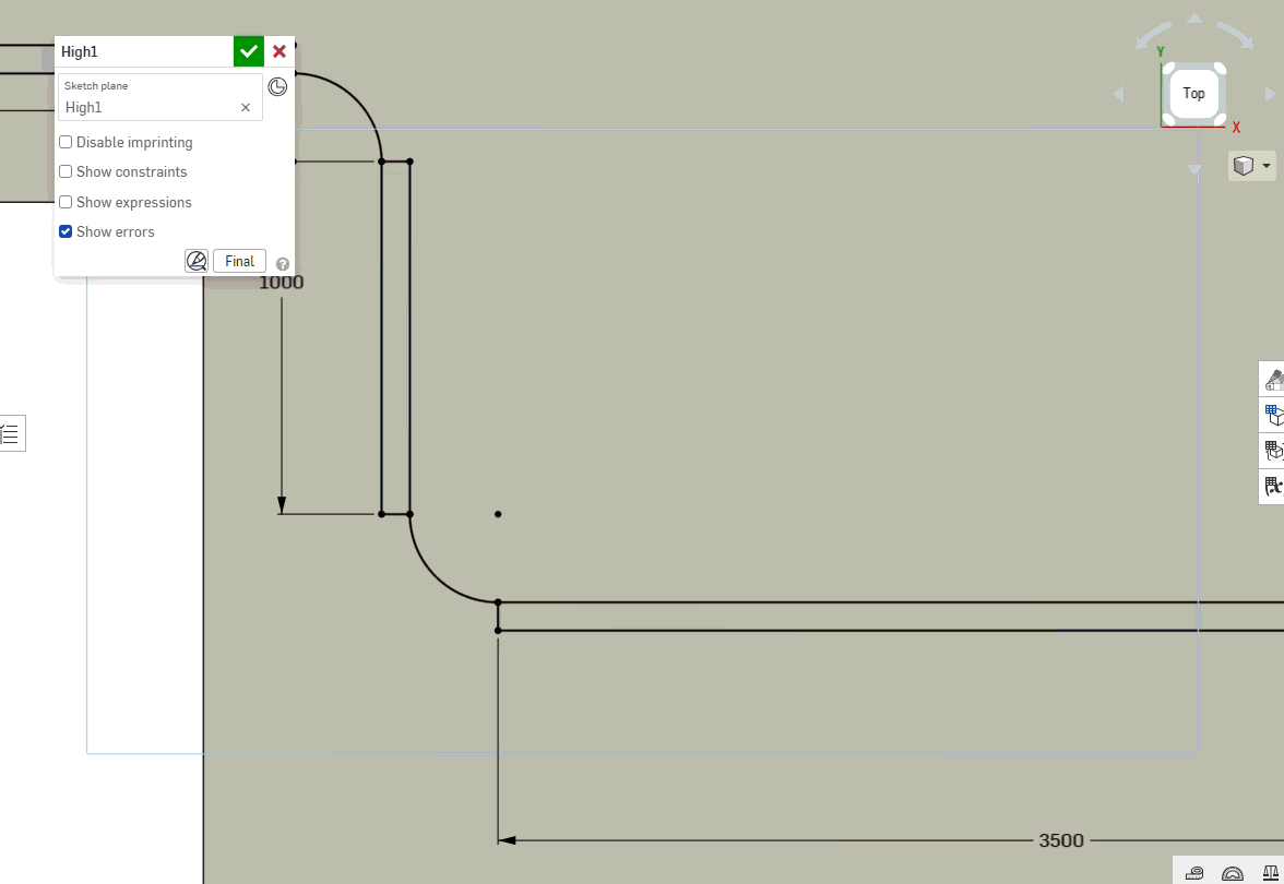

I am reaching out because I am experiencing an issue with one of my sketches.
I was creating something like a pipeline/tube, and at some point I started to run into problems with my sketch, as ONSHAPE reported me that it could not be solved.
However, I was quite confident about my constraints. After investigating, I discovered that it seems like I may have reached the maximum number of constraints allowed in a sketch.
As you can see in the video below, I can reproduce the issue even with a simple line that only has a coincident constraint at the start (which should normally be really easy to solve).
I searched both on the internet and in this forum to see if others encountered the same problem. I did find some posts about it, but it seems that nothing definitive can really be done.
In my case, I am designing a tube, so I can’t really mirror or use patterned instances. I believe I have already pretty well optimized my constraints as much as possible and made use of the "equal" constraint whenever I could.

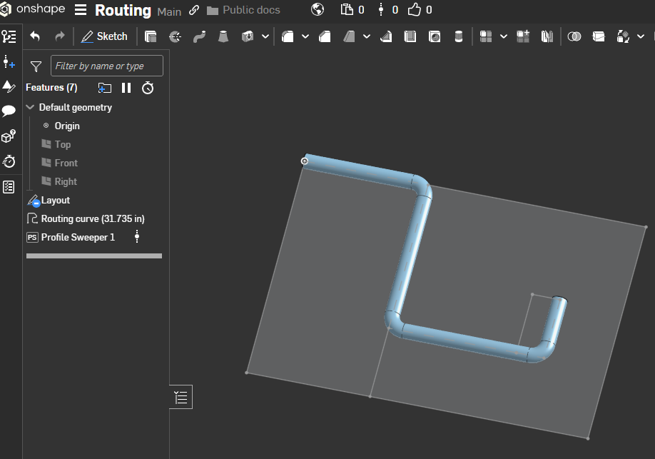

    It looks like you are making your live much harder than you need to…Create the centerline only and then you can sweep each pipe in one feature (so you would need just 4 features to create what you have in your example).
    I would do a "layout" sketch with all your key locations for machines etc… Then either use routing curves to make the paths, maybe adding an intermediate sketch before that referencing your key "routing" points (using the machine position sketch as a reference) if that helps.
    Something along these lines:
    https://cad.onshape.com/documents/80ed14a5ca259405fd5235c9/w/7a95c5e32472a7989e2f0124/e/13dca827a1ea827be20ebc12
    I used the "profile sweeper" FS so I don't need to create the circular profile for the path.
  • benoit_maurelbenoit_maurel Member Posts: 14
    Interesting.
    However, that’s a custom feature (from a third party).
    I’m generally not a big fan of custom features outside of the official ones, because you never really know what could happen if the publisher turns malicious, has their account stolen, or something along those lines.
    It might be different and safer on ONSHAPE however. I saw this post about it, but I haven’t taken the time to really look into it yet.
    Thank you anyway, it’s interesting to know this one exists.

    Breaking things up in multiple sketches is better for performance! It also makes it easier to troubleshoot issues when they come up.
    One obvious way to simplify things would be to only draw the centerline! Also replacing "equal" constraints with a variable would remove a whole bunch (the corner radius for example).
    If you can share your document and explain what your end goal is we might be able to suggest more specific solutions.

    Using a variable is better than using the equal constraint, you said ? Is that because it links a variable to a numerical value rather than to the geometry itself ?
    I can’t share my document, but you can find attached here the sketch where I had the issue (it’s solved now) : https://cad.onshape.com/documents/a27659ffa0107aa7ca44b357/
    It’s not exactly the same, since in my case I also had constraints to locate the tube in space / with other parts.
    My internship project is to design some parts of the factory, mainly for visualization in a homemade SCADA (not exactly but you got the idea). That’s why I may not have strictly followed some conventions (for example, in my original document I created everything in a single Part Studio to make it easier to place the machines).
    I’m still very interested in learning what could be improved in this case. Thank you again for your help !
