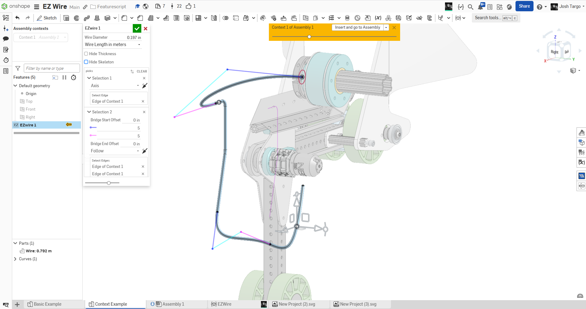

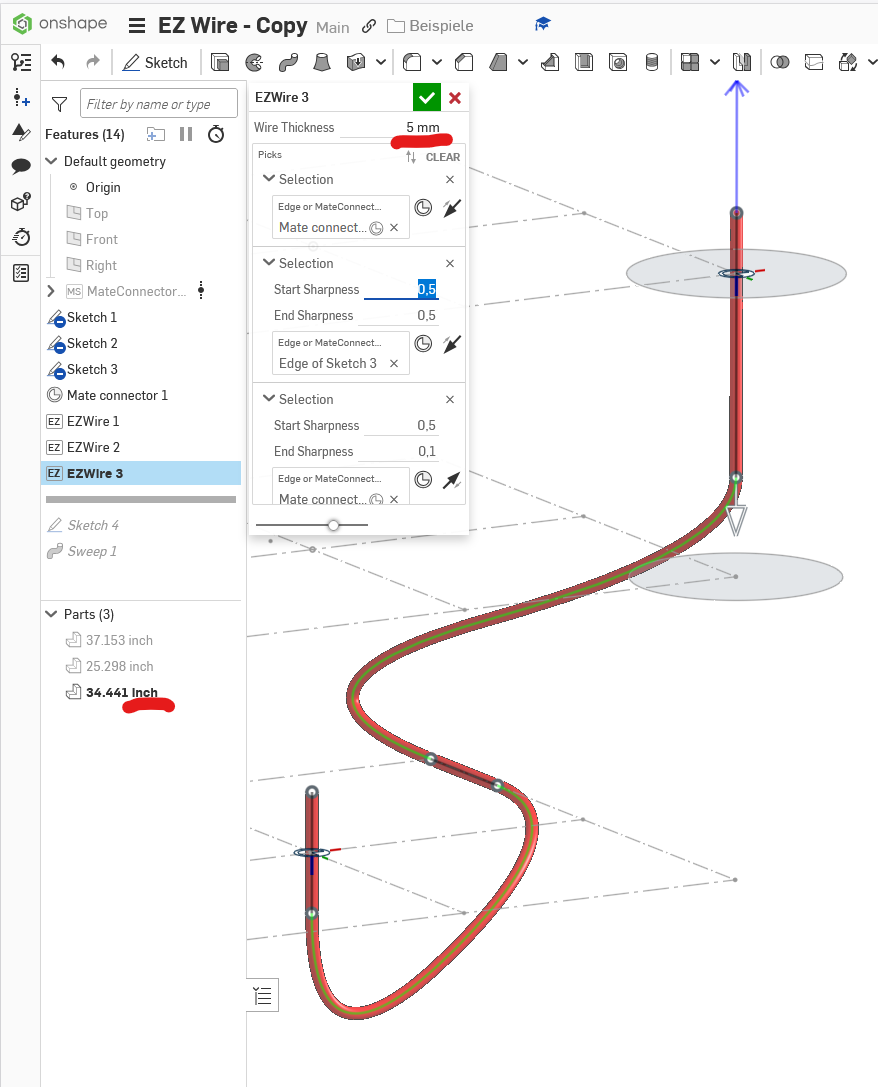

I'm still playing with the UI and logic rules, but basically it's a way to quickly route wire/pipe/cable when exact positioning isn't critical (like for our robots, when we need a basic path).
The example below shows a path that would require 7 points in RoutingCurve, but mine does it with just 3 MC positions.
https://cad.onshape.com/documents/6661cf93ab8de38ee21084ba/w/b8355f5cf6f02bcaeade2553/e/26b8cb50d10f4b14394f2077

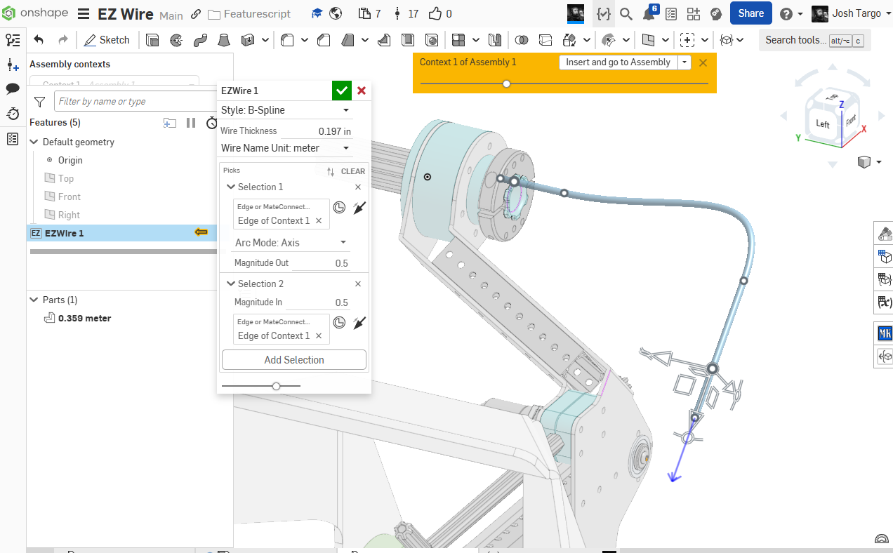

    It is probably enough for many simple applications where we would just want to show that "There is a wire required!" and have it in the BOM. It relying on MCs could make it easy to handle.
    It gets serious hiccups, when I play with the MCs not being perpendicular to any of the basic planes, though …
    I often make simple wires on a 3D curve through points (which includes MCs).

    yes, this is why i need to figure how to handle weirdness. for our robots, perpendicular is ok, but yeah, it breaks for "strange" things I want to keep its behavior of forcing the wire to conform to each mc's Zaxis

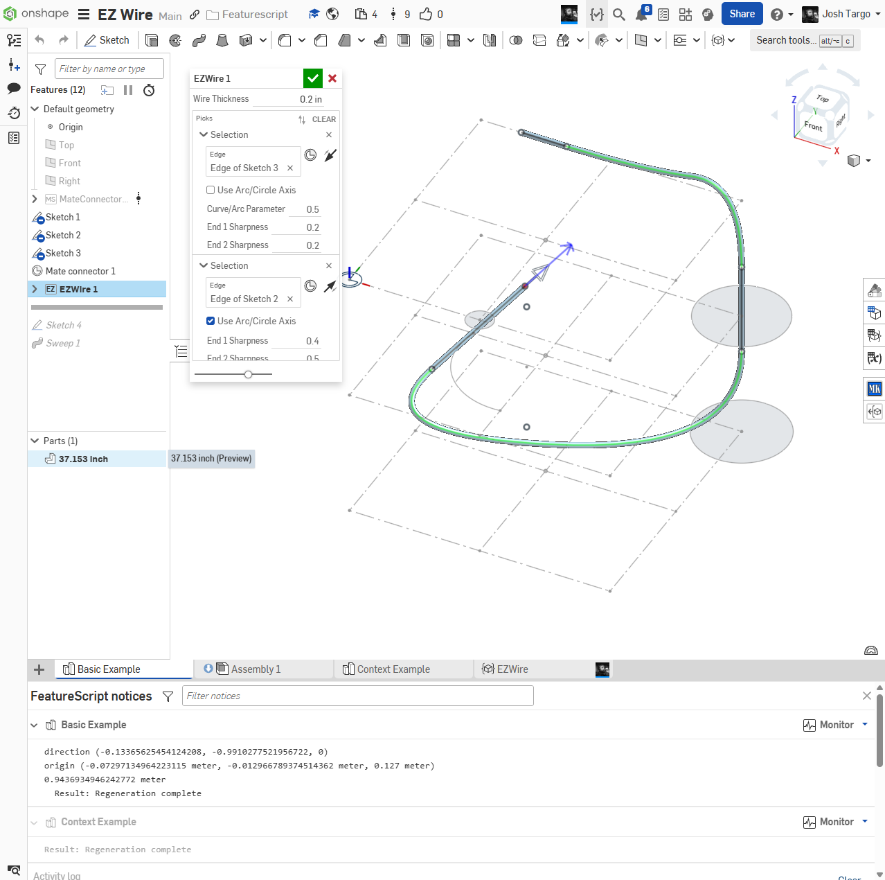

    I have been working hard on this and now have manipulators for segment endpoints as well as controls for bspline weights at either end of each bridge curve. can you play around some more?
    If I can figure out how to make it follow portions of arbitrary curves, it will be nearly complete. but everything i try to do is very difficult for me, so it takes time.
    https://cad.onshape.com/documents/6661cf93ab8de38ee21084ba/w/b8355f5cf6f02bcaeade2553/e/20535b592817c77c3d553d34

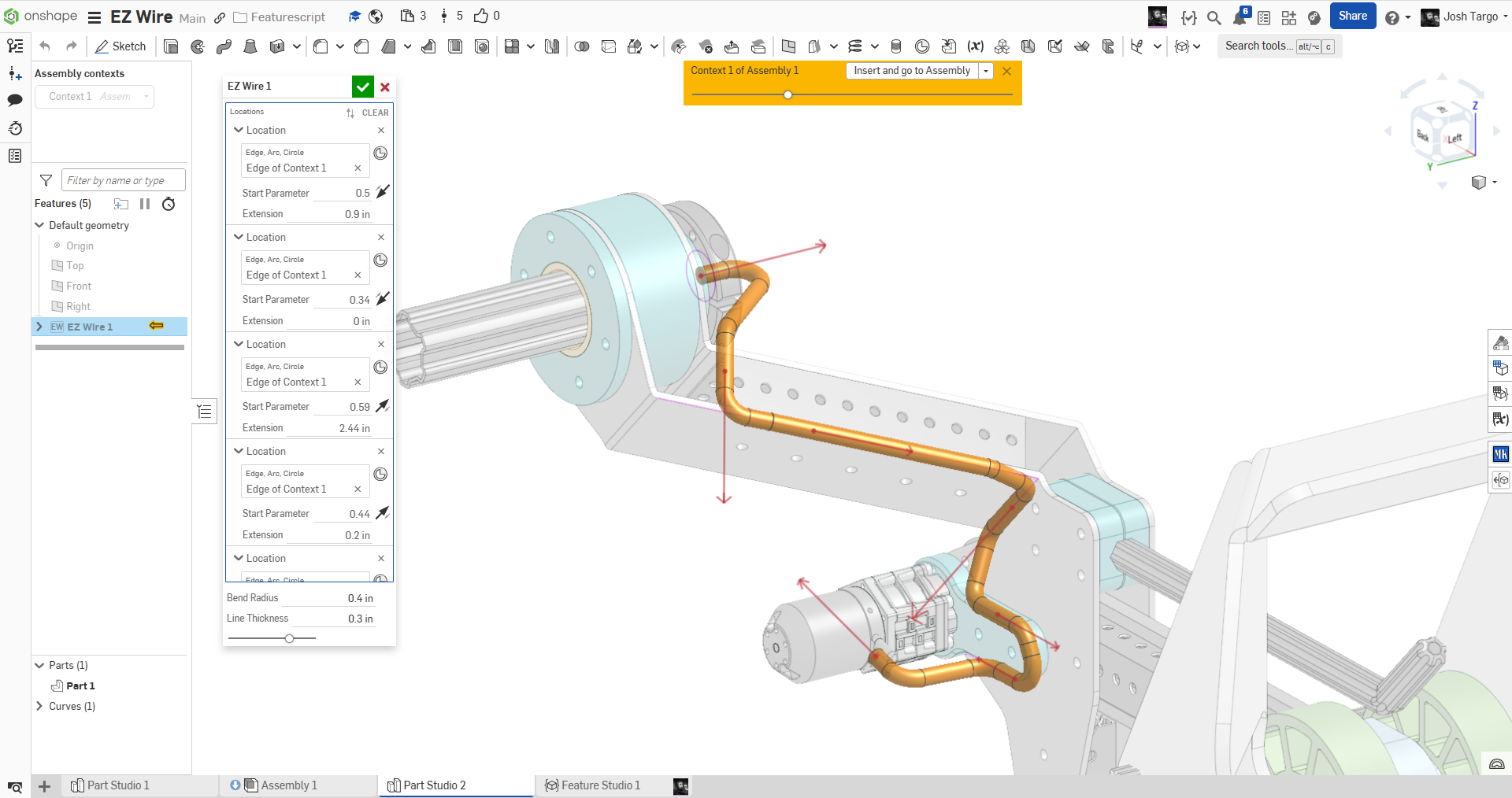

    @martin_kopplow holy s*** I think I made it work with manipulators to drag wire sections around.
    EDIT: still some bugs, but almost there :(
    basic workflow:
    • select an edge or MC. (I think arbitrary curves don't work yet but arcs do).
    • a section of wire will be created from the edge
    • pick an end point of that section and drag it longer or shorter
    • pick the centerpoint of the section and move it axially, or normal to its orientation
    • pick another edge and a bspline or radius polyline will connect them
    https://cad.onshape.com/documents/6661cf93ab8de38ee21084ba/v/8ef5c1f9fb5814bcfaae8444/e/20535b592817c77c3d553d34

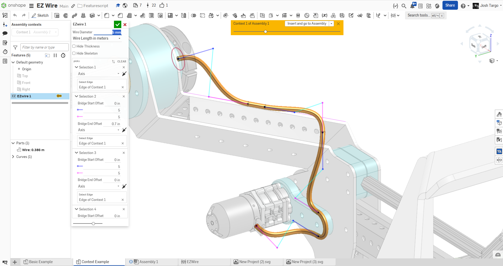

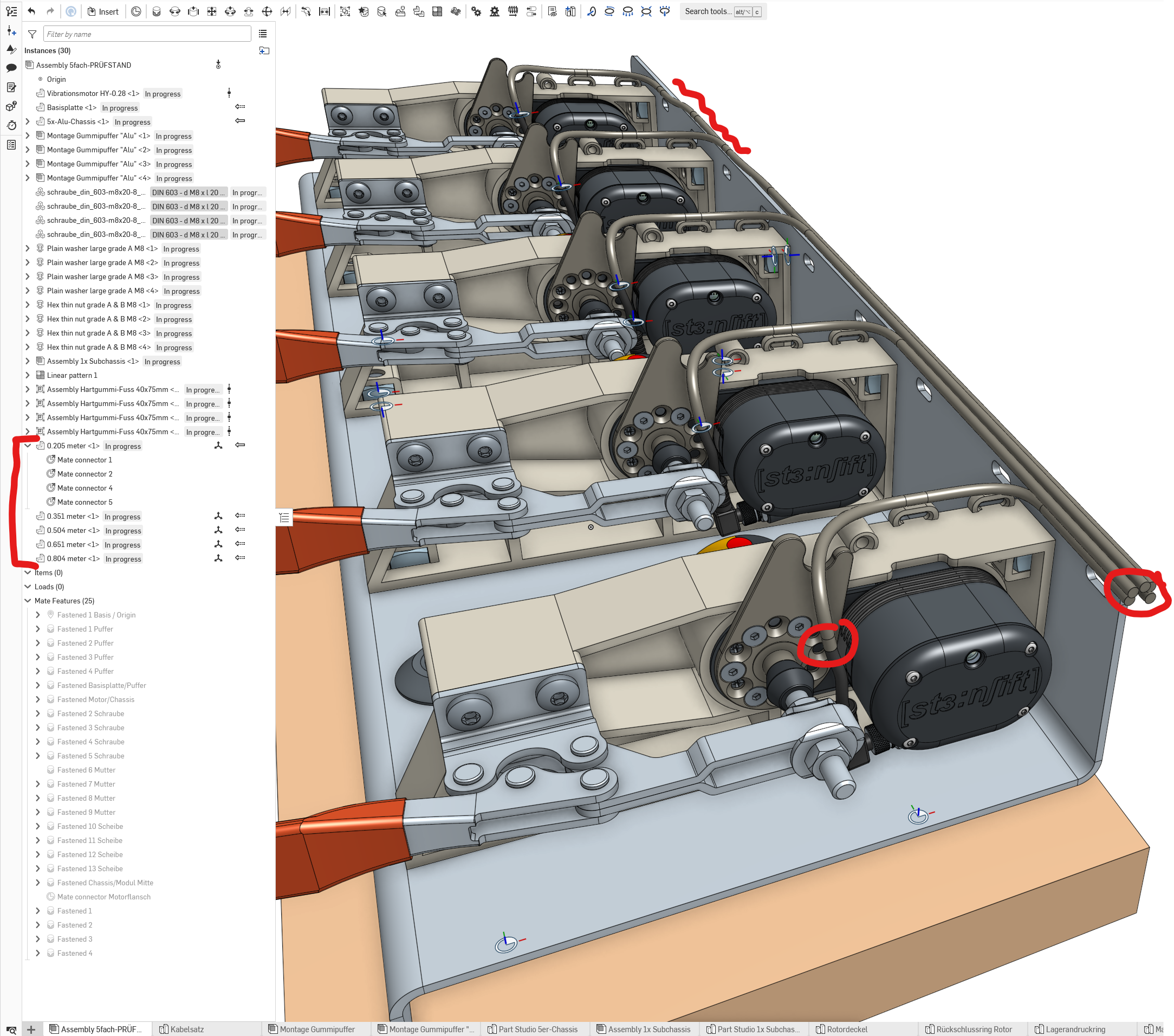

    Today; I tried it a bit. I have a simple vibration test rig that needs to be wired up.
    It took a while until I got the hang of the selection behaviour, it's a bit tricky, for it gets unresponsive when the wrong item is active in the edit box. Then, I had a hard time connecting the start point to my plugs. That is mainly because each reference point appears to be a two-directional mid point. It would be helpful, if the start and end point would only have one direction, while all the other references inbetween were two-directional.
    Then, it was difficult to get the wire run from one side of a part to the other, around the edge, see wiggle line in the picture. That is a situation where rotating the manipulator would be super helpful: Then, the wire could even be made to spiral around the edge.
    I did all this in-context. I found it interesting, that I needed to create the start mate connectors before using EZwire FS. With the edit box open, they would not activate the target geometry. After returning back to the assembly, only 4 of the 5 mate connectors would transfer, and all under the first wire. I have no clue why.
    @joshtargo I am not a coding wizard, so I can not help here, but I fully appreciate the work you do. If you think it is getting too wild, don't feel pushed, okay?

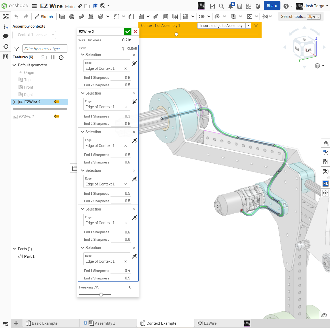

    I've completely rewritten it possibly 2-3 times since our last message and it keeps getting better. I haven't added in Manipulators yet to the new code, but could you take a look at the latest? Also look at my example in the context example studio.
    as for Mate connectors, it is not possible in featurescript to infer mate connectors in context (at least not more than 1) it is a huge pain, but unless a better coder tells me how to do it, it seems not possible. but using axis of a circle, arc, or line is a good way to have a similar effect, and those are built in to my new code.
    Also remember, this is supposed to be "EZwire", and so it may not have all of the features of Routing Curve
    https://cad.onshape.com/documents/6661cf93ab8de38ee21084ba/w/f5498f04cfe042af60e91d3f/e/20535b592817c77c3d553d34
