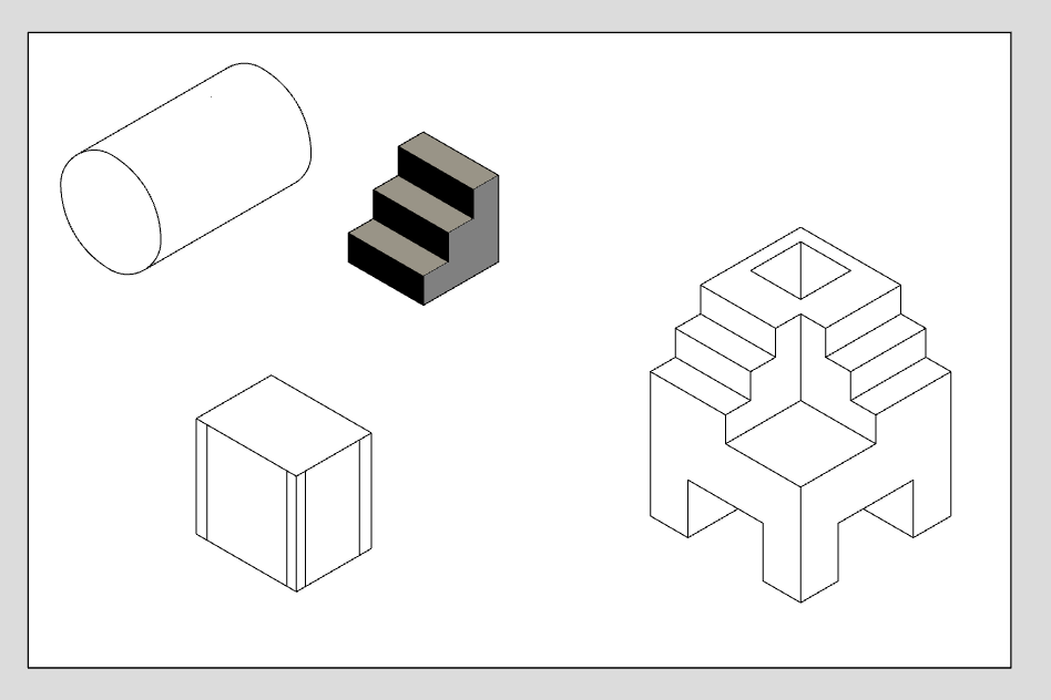

I would use a standard 3 views of the objects to place dimensions. Onshape currently does not support isometric dimensions in drawings. You can pull a dimension but it is not accurate to the 3D model. See image below.

You can use the sketch tools in drawings and draw an isometric view in drawings, but that defeats the purpose of a 3D modeling software.

Well I guess there that use case. Was that even possible till the recent update that added constraints in drawing mode?
Constraints made it possible.

@MDesign here is one just for fun
https://cad.onshape.com/documents/fcc38d3c474b6d689b755142/w/944d71b92ca03db004c09be5/e/dd3c836f7c0aebd0875bbe63
Twitter: @BryanLAGdesign
We have different definitions of fun. haha
@MDesign For me it was a nostalgia trip to my board drafting and early AutoCAD days.
I can respect that. We might be showing our age a bit. My only board drafting was in school. AutoCAD on the first couple of jobs. I can't ever remember drawing anything with lines isometrics on a computer from that point on.
@MDesign with the new trim feature in drawings, I can draw an iso cylinder. 😁
Oh really? how useful. haha. good to know.
