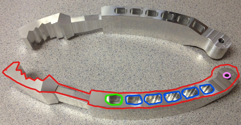

Hi, this is my first full project in Onshape. I’m still very much a beginner, and my goal is to turn a vacuum into my favorite droid — R2-D2 from Star Wars.
Right now I’m stuck trying to bend one of R2’s arms and could really use some advice.
At first I tried using projected curves, but I found that both the top and front profiles weren’t simple enough to just project — I had to sketch them out manually. From those sketches I built a 3D part, and now all that’s left is to bend it.
The problem is, I can’t figure out how to do the bend properly because the part doesn’t have a single straight face to work from.
Here are a couple images of what I’ve got so far:
And here’s the link to my Onshape document if anyone wants to take a closer look:
Has anyone run into this before or know a good way to approach it?
I am open to any ideas, even if that means starting over

    your other answer is you can’t bend it. You have to model it bent.

    @MDesign thanks for the direction, I am having a little trouble in doing so.
    You see, at first I just had the front face, I used 2 curves and projected that face to two planes connecting them into one face or maybe even with lofts (I am not entirely sure about which one, I think I tried both)
    Then i found out that the top sketch had to be made, which lead me on a tangent that i now have the current top sketch, which is the exact one that broke my brain.

    Based on this image in your document…It looks like a simple extrude will capture most all of the curved features. Then you'd just need to work out the opposing cuts/angles to get the rest of it. Red represents what might be the first extrude feature., pink a hole feature. and blue a circular pattern feature.
  • martin_kopplowmartin_kopplow Member Posts: 1,033 PRO
    That thing is sure milled as is. Why design it straight and virtually bend it, when it is not even manufactured by postforming?
