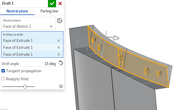

Howdy All,
I am having difficulty creating an angled face along a curved body. The part is a license plate mount. I have the horizontal curvature pretty well set, but I need to have the mounting face taper down from about 3mm out at the top to the existing edge at the bottom, along the curve. Its following the curve that is giving me trouble (I think). Marked-up photo below should provide a crude visual of what I talking about. I am a total novice at this and have only made very simple parts so far and so any help would be greatly appreciated. Thanks

  • MDesignMDesign Member Posts: 1,175 PRO
    edited September 2 Answer ✓
    Pretty sure a simple draft will get you what you need in this situation.

  • pho_shopho_sho Member Posts: 5
    Hi David! Thank you for the advice. I tried your suggestion and I unfortunately cannot seem to make it work. I think the issue is that the mounting face is not quite circular. The shape of the mounting surface requires two different radius values (one on each half of the face). I also tried creating an offset surface (at half the max distance) with the intent of rotating it about its central axis a few degrees so I could possibly attempt to extrude the existing face to it, but I am cannot seem to get that to rotate correctly either. I am probably still just doing something wrong here, but I am stuck none the less.
    Thank you all for the help!
    Scotty - You went the extra mile and I really appreciate it.
    David - Thank you for your continued support. My process was inherently flawed. You comments helped me learn why.
    MDesign - I had not used Draft until I came across your post. Thanks for the intro - it seems pretty powerful and I will definitely be making use of it.
