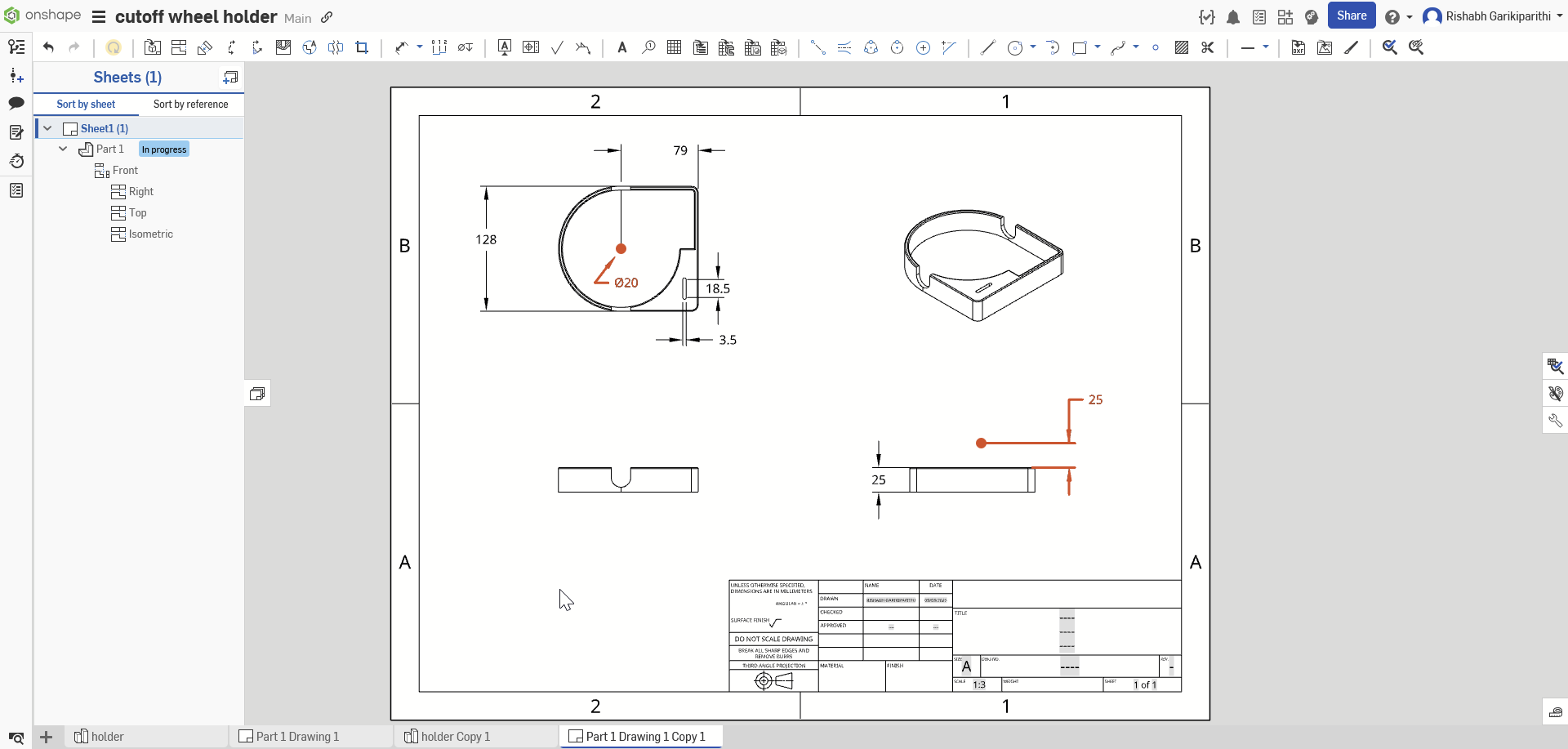

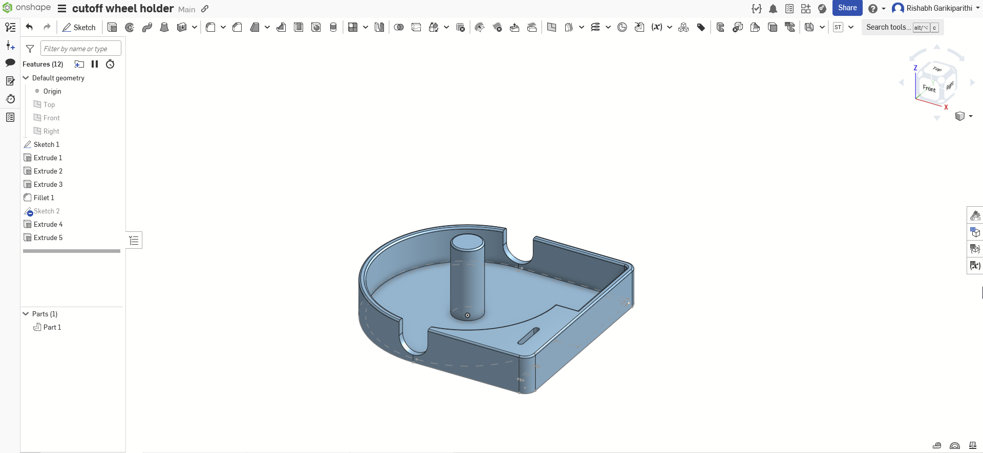

    I'm here because my colleague just showed me how to duplicate a part and it's drawing.

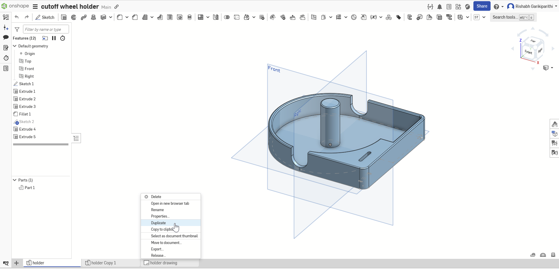

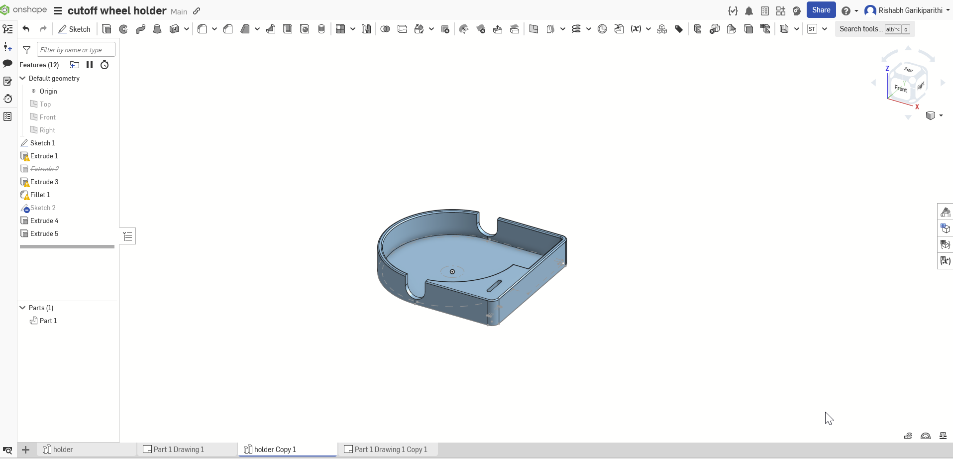

    2. Make copies of both the part and the drawing using the Duplicate button in the right-click menu for each.
    3. (optional) Make a few edits in the copied part. I've done some terrible ones here just for demonstration. image.png

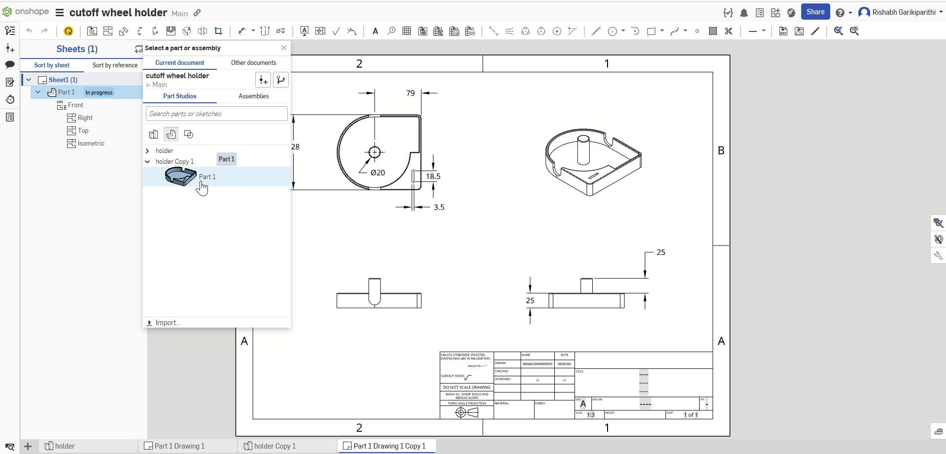

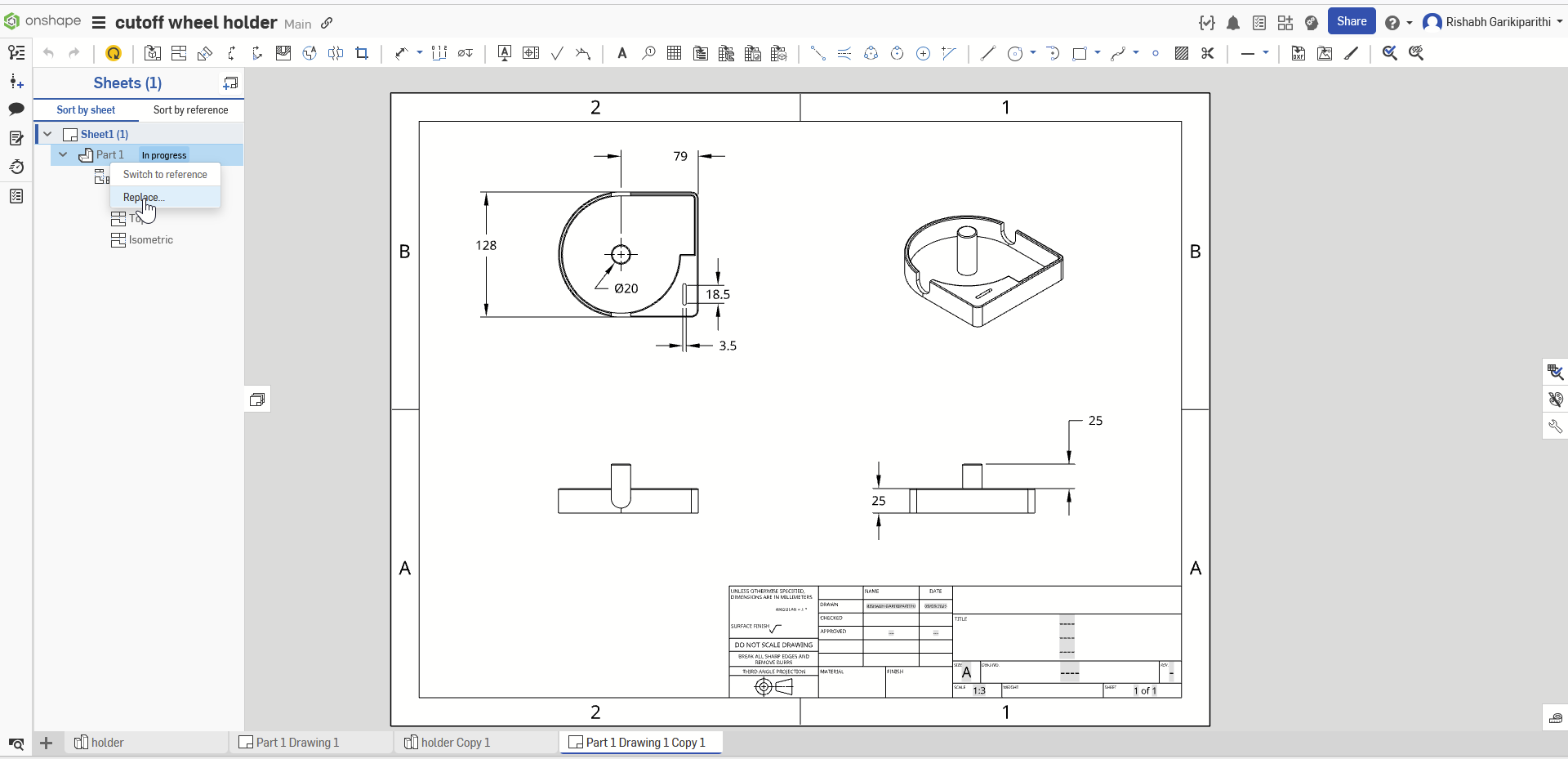

    4. In the duplicated drawing, go to each page in the tree, right click the part, and click replace image.png
    5. Select the part from your duplicated document. If there are multiple pages, you'll have to do this multiple times. If there are multiple different parts in your drawing, you will also have to do it for each part. image.png

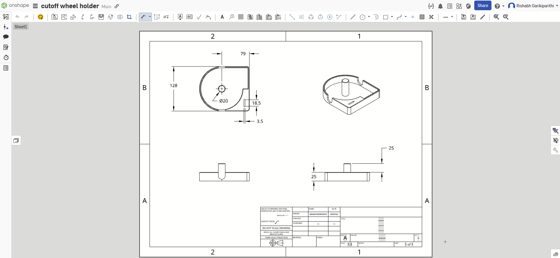

    6. If you've made edits in step 3, some of the dimensions may no longer be relevant, and will be shown in red, but everything else will be duplicated properly. Views, comments, dimensions, tolerances, etc. will all be applied to the new model with minimal editing required. If you don't make any edits in step 3, the duplicated drawing won't have any red errors like this. image.png
    Knowing about this feature a month ago would have saved me over 10 hours of my life, so I'm surprised it has not been mentioned in forums and Youtube tutorials more.

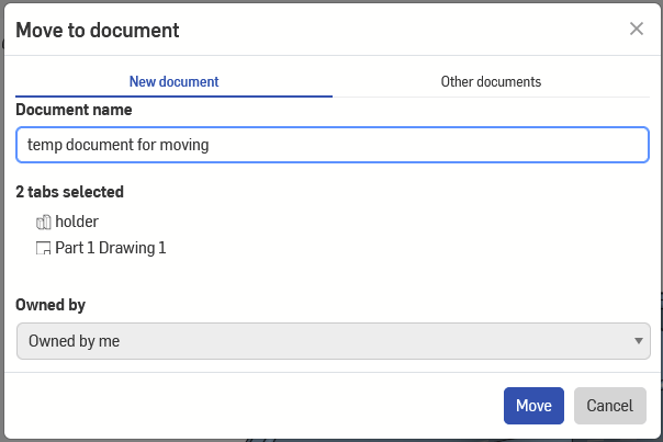

    Use the "move to document" for your drawing and part and move it to either a new document or some temporary other place.
    This new document has the copy of the part and its drawing but these are still associated.
    "Restore" the original document to before the move to get the "originals" back. If you want the new parts in the "original" document, you can just use a move to document from the temporary one.

    when replacing drawing references, if you switch to the sort by reference view of the sheets panel- the replace will handle all parent child view sets for the entire drawing - essentially a global replace for the reference in the drawing.
    If you replace while in the sort by sheets view, the replace will handle just the current parent/child dependent set of views and no more.

    2. Open the tab manager (alt/⌥+t), ctrl+click the part file as well as the drawing, then right click and Move to document
    3. Select New document, name it something like "temp document for moving
    4. Open the new document once it's moved, and rename both the part file and the drawing.
    5. Go back to your original document, and in the Versions and History tab, right click the version you made in step 1, and click Restore to [name of workspace]… (This will re-create the original copy of your part file and drawing without deleting them from the temporary document you created)
    6. Go back to the temporary document. Create a new part studio. Then use the tab manager again to select both the copied part and its drawing, right-click and select Move to document again, but this time select Other documents so that you can choose the original document to move the copy back to.
    Now you will have both copies and their associated drawings in the original document. I'm surprised this works without creating any conflicts.
