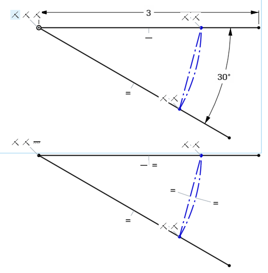

Hi, as a newbie I can't figure out how to constrain two (or more) angles to be equale.
E.G. I have an angle set to 12 degrees. I want to constrain other angles to be identical so if I change the 'master' angle to 10 degrees they will follow and become 10 degrees. (Not having to change manually all values)

You can use variables to define the angle and then use that variable whenever you dimension an angle. This is a link for webinar on variables: https://www.onshape.com/videos/webinar-variables-in-onshape-july-19-2016.

You can set lines as equal because they are entities you can pick. Angle is not an entity by itself, it is only a measurement between 2 entities. Therefore, to set angles as equal, we need dimensions. Variables & equations are very handy when you have to deal with dimensions.

What I expected to set angle dimensions as driven and be able to apply an equal constraint among them.
Conclusion, you have to workaround not being able to set angles to equal as you would set line lengths to equal.

Draw two centerpoint arcs where you would expect the angular dimension callouts to be. Set them as 'construction', then set their radii equal to each other. Draw construction lines between the endpoints of each of these arcs, then set their length equal to each other. you now have two equal-radius arcs with equal distances between their endpoints, thus their angles will be equal.
