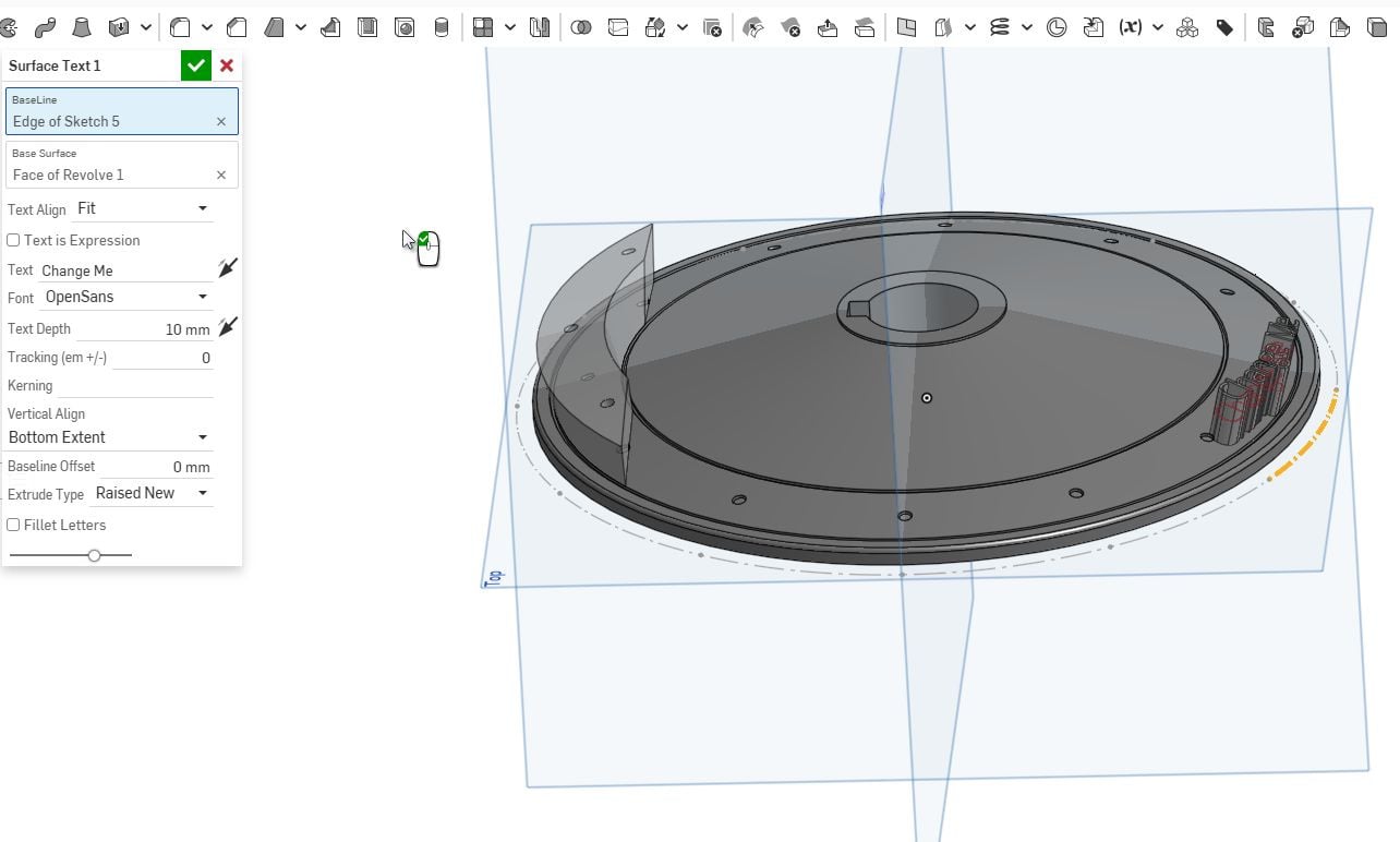

Hi,
I've been using SurfaceText to cut out text around a curved surface.
The problem is that it cuts away some of my model on the other side. I can't just extrude what it has cut on the other side because I need to cut text all around the curved model.
I've added a couple of screenshots.
Thank you :)
I
I added the 1/2 sign in red where it is on the other side of the cylinder.

    Hey Vincent. I took a look at your document. I've only used this feature script a handful of times. I don't see anything in your selections within the Surface Text feature to result in affecting the other side of the lid. Nor can I imagine any selection causing it. I see it as unexpected behavior; perhaps a bug. Looking forward to another member chiming in. -Scotty

    Ok I just had a try following your example and it works. But is it possible to have it work using a sketch line like I'm doing here :
    It would save me time from having to create a plane and projected curve for every different angle.
    I'm going to post the link in case you need to check that out :
    https://cad.onshape.com/documents/cecf81fd61de43fbfda11fb3/w/0def91f0a5d3a674585fb5b9/e/d656c521283f4f398bcc595b
    Also in the SurfaceText feature, it was possible to change the height (and length) of the text without having to change the length of the curve, is it possible with your feature ?

    I took a look at your model. Thank you so much! That is a case I hadn't considered: A sketch path that doesn't use the sketch plane to orient the text. Makes perfect sense. I made the slight change necessary to support that case. Please update to Release 3.1.
    Here's the difference. In typical use, a user will select the sketch edge as path. Because it's a sketch edge, we know that it lies in the sketch plane. So we don't need to specify a "Face containing curve" because the feature assumes it should use the sketch plane to align the text. This produces the result you see:
    But what you want to do is to use a sketch edge as the path, but have it align to a non-planar face. So here we just tell the Text tool what face to use:
    And then the text appears where we want.
    As to your other question, about locating the text at various points on the sketch. For a closed path, the feature doesn't know where you want the layout to start. For that, you'll need to give it a start point to help the feature:
    But the feature still uses the entire path to distribute the characters (unless you specify split by commas or spaces, to treat your entire string as a single sketch) so you'll still need to split the circle sketch in to sections to arrange the text (as you have done).
    Hope that helps!
