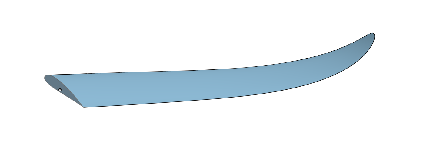

    Same problem here. This is the link to a pretty minimal wing panel (re-)demonstrating the problem:
    https://cad.onshape.com/documents/d3de070507e43aeaf80b85b0/w/21a6706159cfe814ee972203/e/7130d5b3acbdb42e52af6d15?renderMode=0&uiState=68c312635136fd309f05c48d
    https://us.v-cdn.net/5022071/uploads/BISD7UEDC8AP/image.pngThe suggested solution of designing two surfaces and thickening them from inside-out is not really a good solution IMHO, as this approach modifies the curvature of the chosen airfoil. Modern airfoils are designed very carefully here and there will be definitely a performance penalty when going this route because the CAD system used can't do better.
    The other suggestion of removing a smaller inner wing panel is also not really helpful when trying to 3D-print a wing panel, as this leads to non-constant perimeter layer thickness and hence to lots of unwanted slicing artifacts.
    I just cross-checked Fusion360 - it is flawlessly able to shell the body exported form the above document, despite the performance is quite awful. This is also my current work-around: export from Onshape, shell it in Fusion - reimport to Onshape. But this workflow kind of sucks and negates any advantages of a parametric design approach.
    Any other ideas how to work around this problem? Any help would be really appreaciated.

    You're not supposed to start the 'inner' airfoil with a scaled-down version of the original, for that would indeed compromise the curvature, but with an offset.
    That said, you could also make the original as usual, then create offset surfaces at the inside and use these to make an enveloped volume to bool away. Still, it stays true: There is no razor sharp TE in real life. And in my experience, there are no (or in fact fery few) one-piece-wings out there. It happens to be that I am a maker of one type of those rare one-piece wings, but that requires a proprietary technique to put the spars in. Trust me, you want to avoid that. That said, it makes little sense to design a wing on one piece, but rather design the parts you're going to manufature to assemble the wing from, even if it is a composite wing: Even these will usually not have a constant wall thickness.

    Thanks, @martin_kopplow, I think now I got it: generate the airfoil sketch, minus-offset the edges it by shell thickness, loft the surface, plus-thicken the surfaces it by the same amount. Very good idea, indeed!
    The razor-sharp trailing edge is unfortunately required to make the loft along the 3D-projected curve succeed - at least I did not find a better solution yet. I would prefer a defined width of the TE indeed.
    The 3d-printed wing panel is an idea that I am very curious about. There are quite a few (successful) examples on the Internet going that road. I think, a 1.5mm shell plus some diagonal ribs printed in place, plus a of-the-shelf carbon fiber tube as a "spar" could work reasonably well for a 1.2m wingspan model aircraft.
