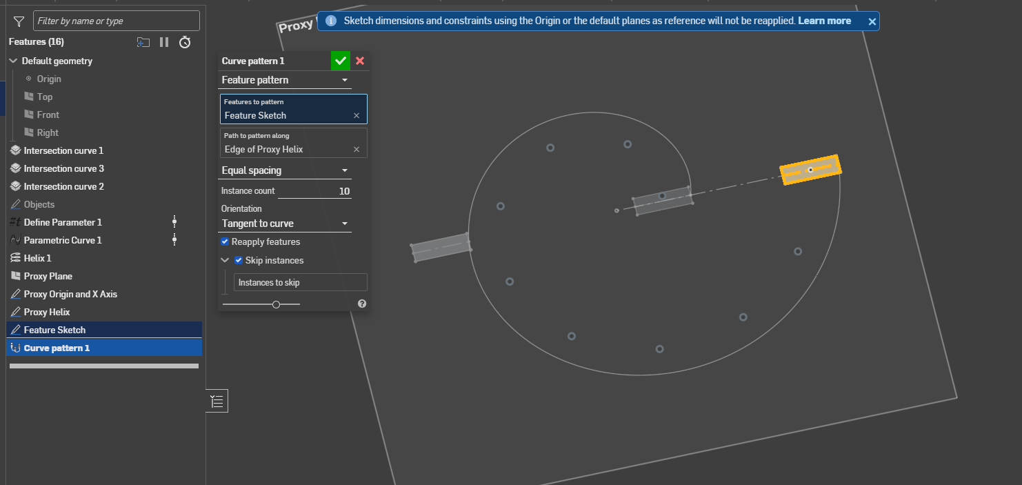

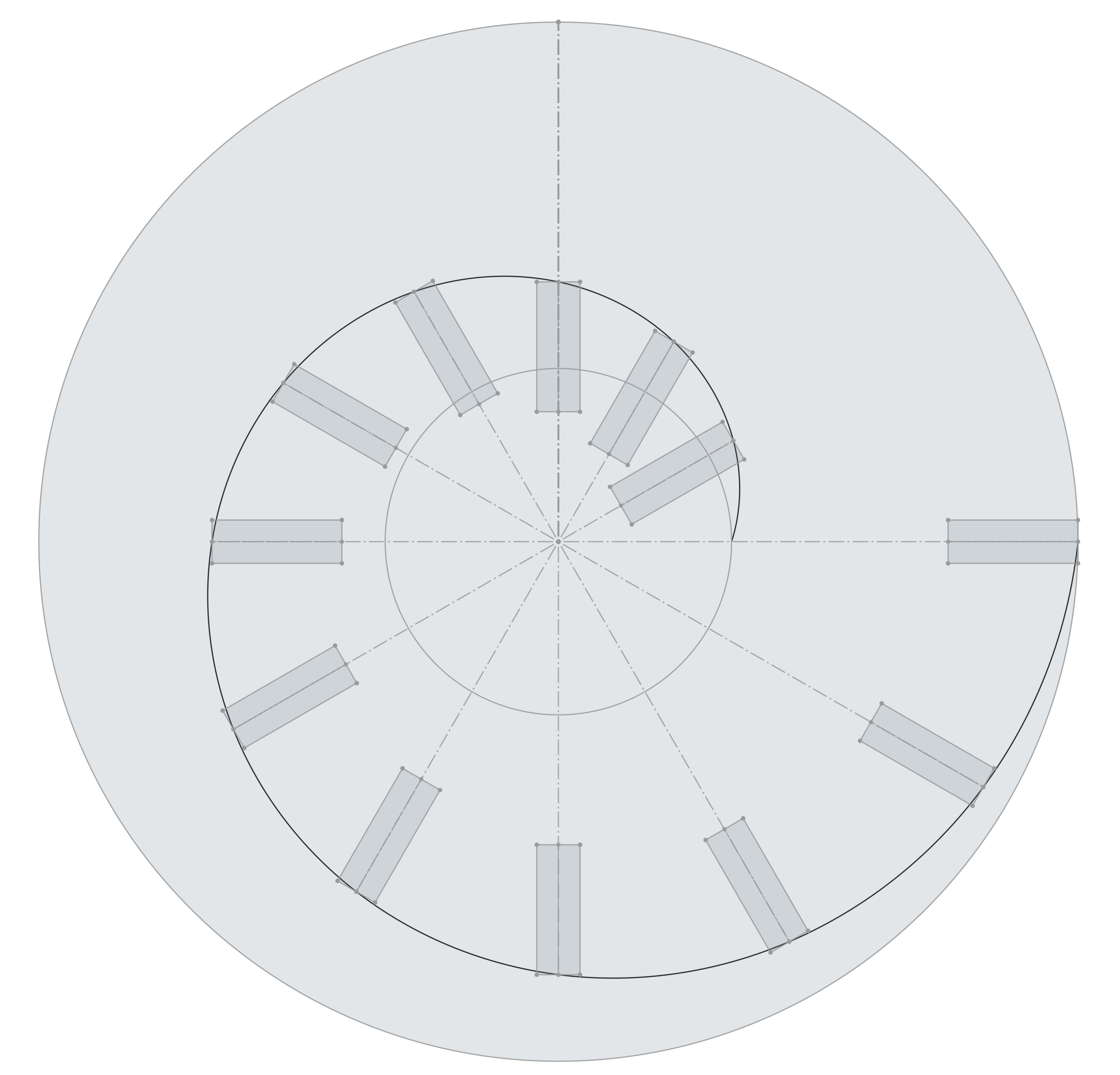

I want to pattern an object along a curve (ive tried both Helix and Parametric) and lock the orientation on the center of the circle (in my case the Z Axis).
The curve starts at 120mm Radius and ends at 40mm radius
https://cad.onshape.com/documents/00c9db9d02dbafeaa5e0345b/w/500ced153d64ee09c8cacef3/e/7f5494a24f6260ffa34ba8d8?renderMode=0&uiState=68c9b5950dc5a3ffa226f524
Grey: What I get
Red: What I want
  • S1monS1mon Member Posts: 3,659 PRO
    Pattern a sketch feature which is dimensioned by the angle, and coincident with the curve, and re-apply feature.

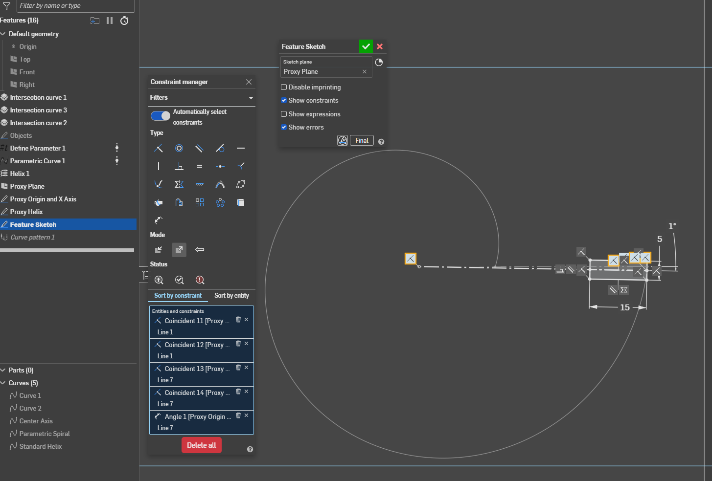

  • SkiBoy22SkiBoy22 Member Posts: 10
    Im not sure what you mean by dimensioned by the angle?
    I have also made all the refrences other sketches as per the curve pattern tips. It seems to work on the first and last however most of hte instances inbetween are skipped

    Yep. I've tried a bunch of combinations and work arounds, and I'm finding it shockingly difficult to do what you're trying to do.
    I managed to get something that 95% works. It can't handle the last member of the pattern and depending on the count, some pattern instances will flip, but for some values of #c (the count), it works:
    https://cad.onshape.com/documents/f87eec8e04343d46741dbf2c/w/9da5103c5970b339455003ea/e/1c0444aa9daa6801f2423488

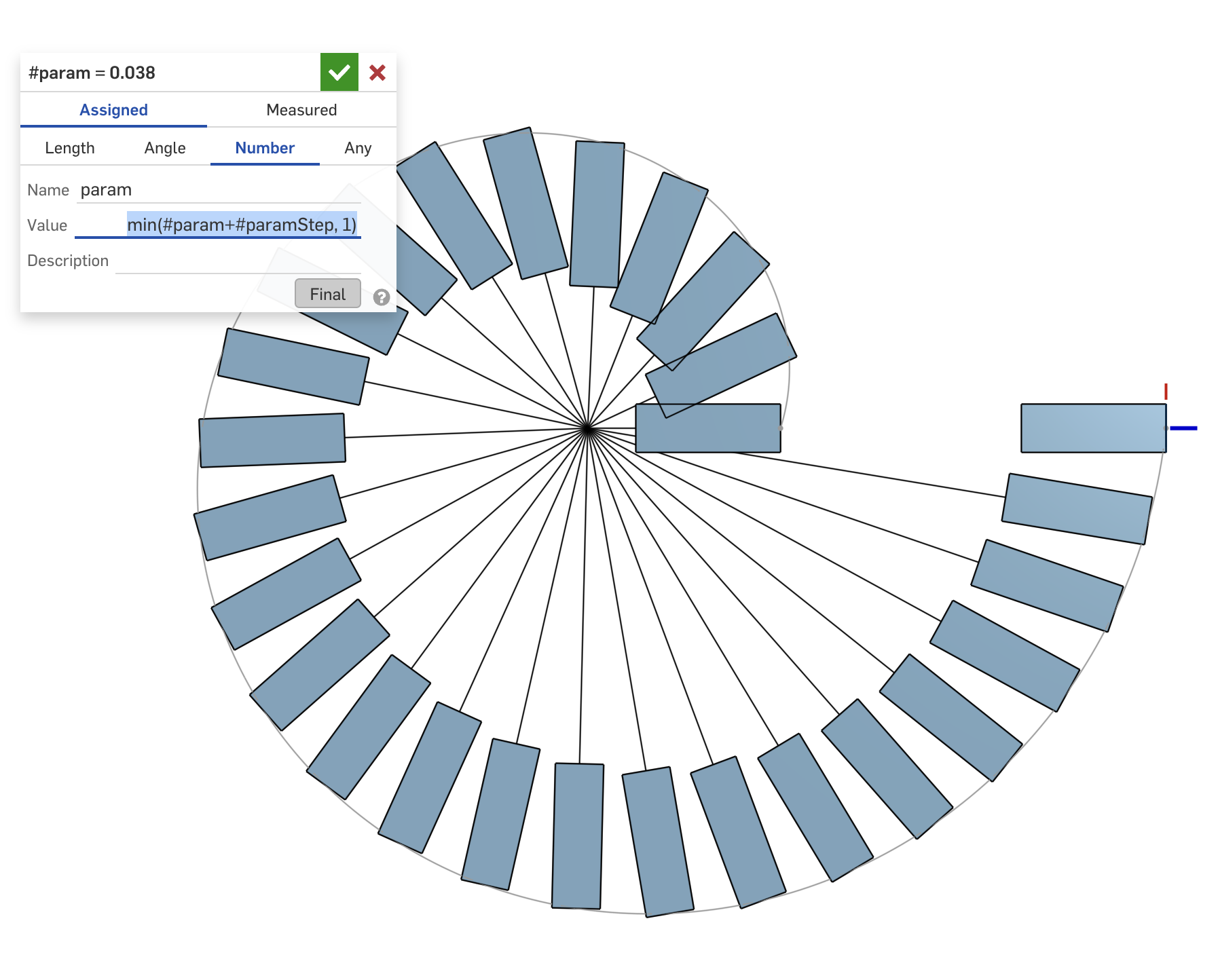

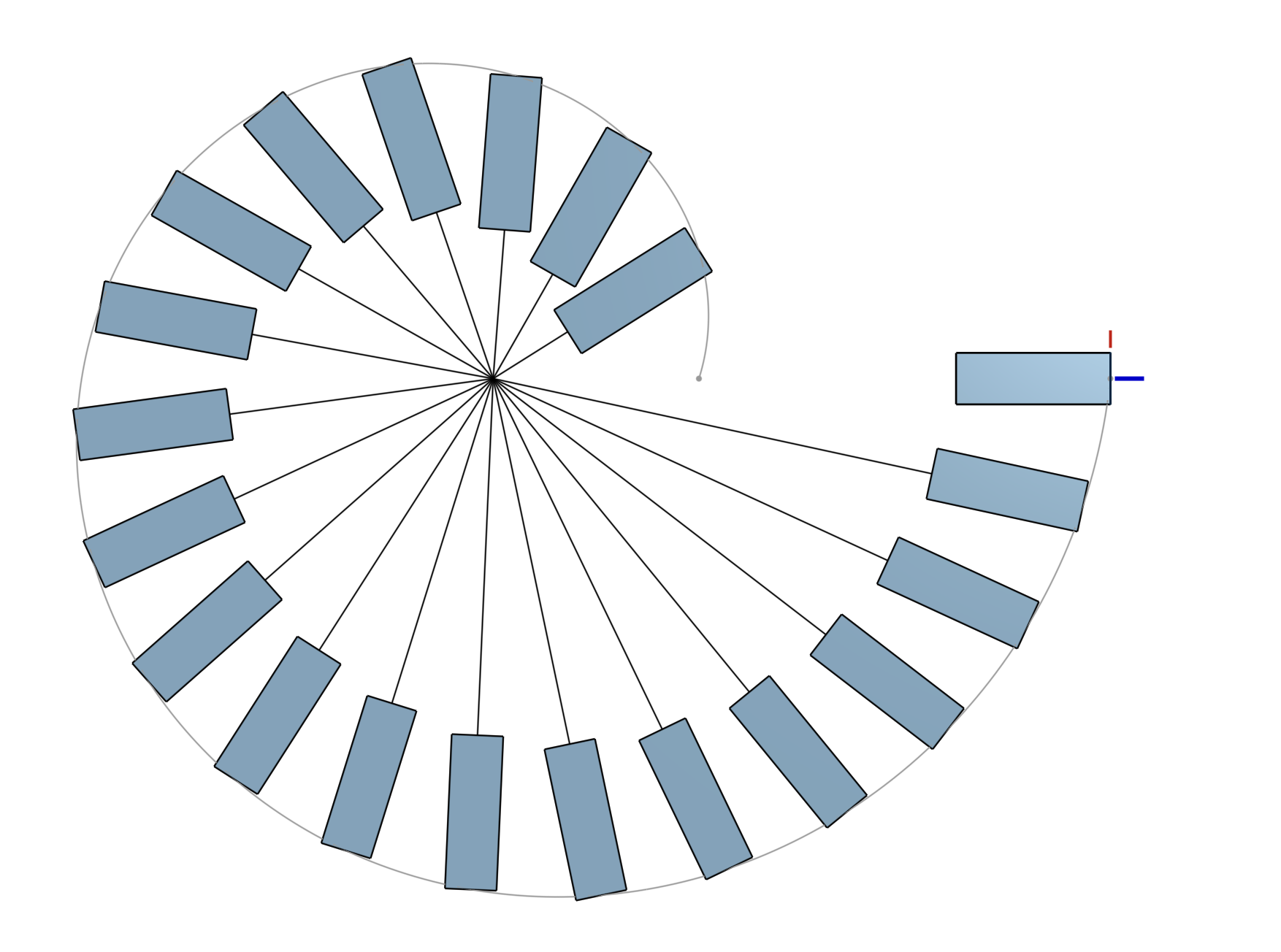

    ooh that's a tricky one! I tried a few things and got this working.
    https://cad.onshape.com/documents/07cc9f9029c8433d65138b5c/w/f369bd3fa338a993997075d9/e/c1c7dfefafdb8b6aa3aa9a4a
    Thank you both! Exactly what i needed 😁did not realize you could update a variable! very cool 🤓
    edited September 18
    Yep. It's a weird - but useful - way to do a loop in Onshape. Using a pattern that actually doesn't move anything by itself, except to cycle through features including the increment variable expression.
  • EvanReeseEvanReese Member, Mentor Posts: 2,618 PRO
    I love that technique! I noticed the last instance wasn't always working. I think it's because of a rounding error sometimes making the param go to something like 1.00000001 instead of 1 so I threw it into a min function and it's stable now

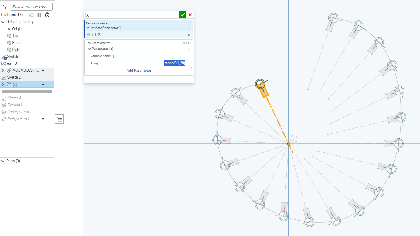

  • Konst_ShKonst_Sh Member Posts: 86 PRO
    @MichaelPascoe feature pattern is definitely weird, maybe its because it being combined with curve pattern and transform from curve makes it flipped from exact orientation though. But the parameter pattern works as expected in combination with multi mate connector.
    Another option would be to use Path pattern custom feature with orientation option - Normal and tangent - with reference cylinder face around origin
